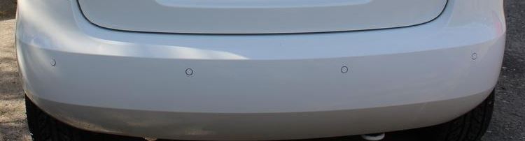

I'm looking at purchasing a 2010 Elegance with factory rear parking sensors (they are flush mount, so I think factory). The seller says the sensors don't work - when it's in reverse, nothing, no beep, nothing on the stereo (Swing Radio), nadda, nowt!
Any idea what this issue can be and any rough cost? I don't want to buy the thing if it'll rape my wallet trying to fix it.
I'm viewing the car at the weekend so can have a poke around then. But for now, I've attached the picture of them (looks like the left sensor pokes out a tad?).
Any advice is most welcome.
To be honest if the seller is pricing this car at anywhere near book price I would get him/her to fix them before you buy it. It could be that a previous owner has disabled this function, or it could be that there is a fault. I like the sensors and the feedback on the swing screen but some don't I guess, and yes those are factory fitted.
Those are factory fitted so its either a cable issue inside the car or that the sensors themselves have been turned off in the software. Be wary of purchasing the car with this known issue and if you wish to purchase the car (elegance model is a very nice spec) then get the current owner to have the issue diagnosed / fixed beforehand as it could be an electrical fault costing a fair chunk to diagnose. (not always but sometimes, just be wary of electric faults on modern cars)

Turns out it was a coding issue. Seems odd that someone would code them out. But there we go. Nice and simple (and free) fix!
