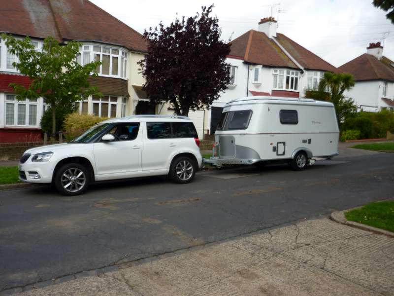

I have towed eriba pop-top caravans with my 110bhp 2.0L diesel yeti for three years. This year went down to between Toulouse and Narbonne in the south of France. It coped fine with the 1200m altitude with hair-pin bends in 2nd and 3yd gear. Fuel consumption dropped to 30mpg as opposed to the normal 34/36mpg. I have seen 40/42mpg in the UK. This year I have towed about 4,000 miles.
You have to remember though that my van is only 1200kg and has a lower aerodynamic profile. Others who tow "normal" vans will testify to the 14b0hp model being a better choice.
Whichever model you choose you will appreciate the ability to remove the rear seats for a van like capacity that is great if there is just the two of you. When away for 3 weeks plus I find I can fit a table top fridge next to a table top freezer in the boot, with awning and boxes occupying some of the space freed up by the removal of the back seat.
As an aside you mention the 1.4tsi 150bhp petrol engine in the Octavia. In theory this should tow better than the 110bhp diesel in the Yeti. It has the same 250Nm torque but across a wider rev range.
Colin
