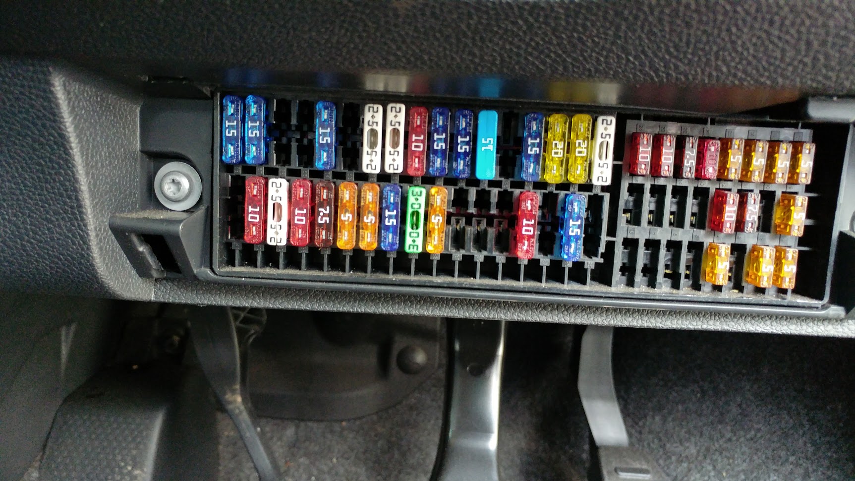

For what its worth here are my fuses ! look lovely don't they lol
ok after further examination and a natter with my mrs (dont laugh she comes out with brilliant ideas) and a word to the wise
1. The Roomy does in fact have seperate fuses
2. The Elsa win diagrams are the wrong way round
3. The Rotary switch controls left and right sidelight power
4. Removal of switch is easy when you know how,ie place switch to "O" position push button and rotate about 10 degrees and pull (it will pop out believe me).
5. Unclip wiring
6. Install to new Switch
7. Push in switch (until you hear a click )
8. hopefully rotate switch and hey presto both lights working lol
 p. s. just in case you need it the part number is   1U0941531D  usually just ebay it and yes Skoda Octavia, Golf etc will work
