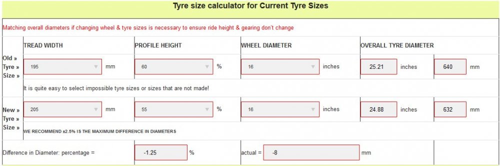

I have the 205 x 55 x 16 on my Yeti as standard.
This table shows there is very little difference in diameter.

Simple answer:
Yes it is safe to use and won't do any harm.

Most space saver wheels are a lot smaller than the standard fit tyres and Audi and other VAG group cars have them as standard. The Yeti is unusual in that it comes with nearer full size spares. My Yeti has 17" wheels as standard and a 16" spare so as Graham says it will be fine, but keeping speed down to less than 50mph when in use is advisable.
As above have said you are fine to use the slightly smaller wheel and tyre combination. To put it into perspective, my last car a Touran came with 16" wheels but no spare. I sourced a 15" wheel and deeper profile slightly narrower tyre as a spare. One year when returning from France with a caravan I had cause to tow the 650 miles back running on the spare. I was unaware that my speed was to be limited even though the rolling diameter was within a few mm. I detected no difference in steering, stability etc.
