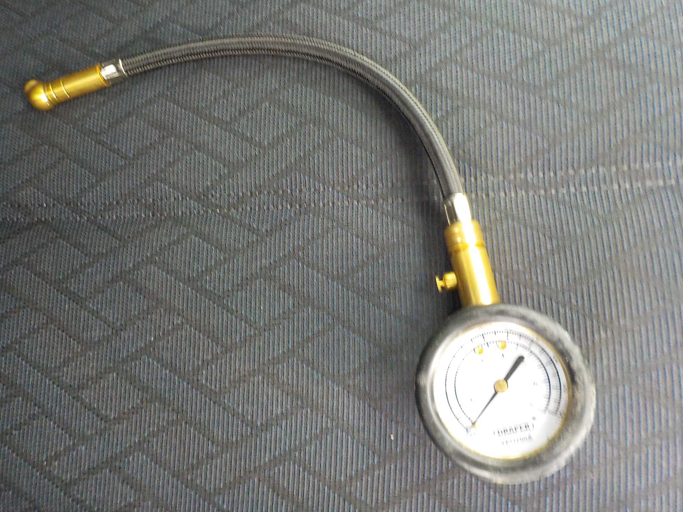

Very handy,  easy to use and easy to let the pressure down a bit and see by how much.
I use them all the time when inflating all kinds of tyres onto rims then deflating to the correct pressure, or checking pressures.

Thanks for showing the Draper pressure gauge.  Being a lot newer than the one I’ve been using, it should be more accurate, and it would be convenient to be able to release excess pressure in a controlled, measured way, if necessary.  But rather than putting one in each car, and hoping either of my sons would think to use it correctly if changing a tyre on a wet night by a busy road, I still believe I’ll do better to aim to ensure that the spares are already at suitable pressures.

Seeing the hose on the Draper 69924 pressure gauge has stimulated further thoughts, and I’ve spoken to our younger son who lives at home and, in normal times, commutes to work in the Jazz.
I realize I wouldn’t use the Draper pressure gauge regularly, because normally I need to add air rather than release it, so it’ll be more straightforward to stick to my foot pump with its gauge, but it would be beneficial to calibrate that gauge against newer one.

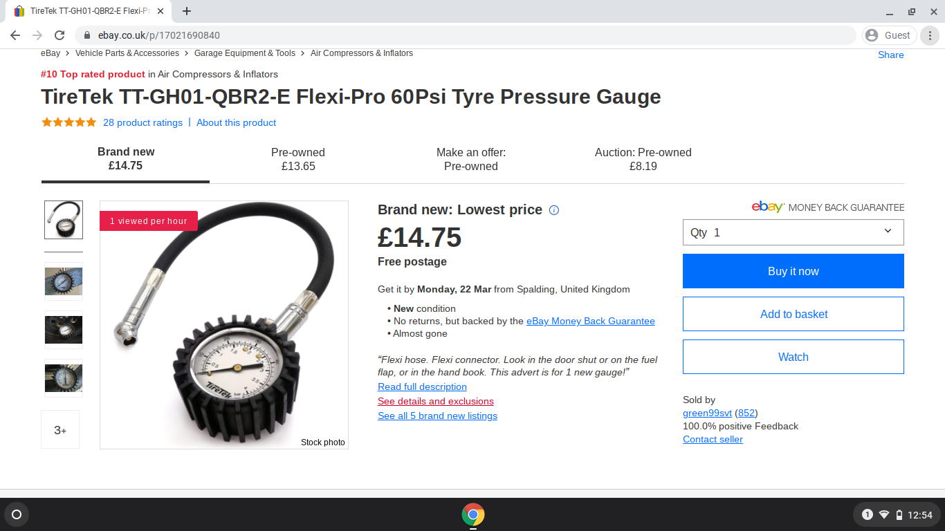

I had a look online for potential gauges, and noticed the TireTek TT-GH01-QBR2-E Flexi-Pro 60Psi Tyre Pressure Gauge is similar to the Draper 69924, costs a couple of pounds more, but its gauge is marked up to 60Psi/4.1bar rather than the 100Psi/7bar of the Draper 69924, which should make for easier, more accurate reading.  I might even buy one of each model, to check their readings against each other!

I have one of these gauges as well & had it for years.
They are accurate.   I use them when checking Motor Bike & Push Bike tyres when they have a Schrader Valve.
I often use a Pushbike high pressure track pump with a gauge to check car / 4x4 tyre pressures and put some air in rather than a foot pump.

Thanks for your reassurance regarding the TireTek 60psi/4bar Tyre Pressure Gauge.  I found the same eBay offer, and then found it for “£13.85 Dispatched from and sold by Amazon EU, eligible for FREE click and collect without a minimum order”.  I need to be careful of various eBay sellers offering versions at a better price with chucks at different angles that I suspect are less convenient for conventional car tyres, or gauges marked only in psi, as the Scala tyre pressure information is only in bar (although with my foot pump I work to psi targets printed on a sheet in my garage, because those are the outer markings on the dial, so can be read more precisely, and also avoid needing a decimal point).  The Draper and TireTek gauges look so similar, except for the brass or silver look to the metalwork, and the gimmicky tyre-shaped housing for the TireTek dial, that I wonder whether they both come out of the same factory in China!
I’ll probably order a TireTek gauge first, for its more appropriate range, and follow with a Draper one if the TireTek is as convenient as I hope.
