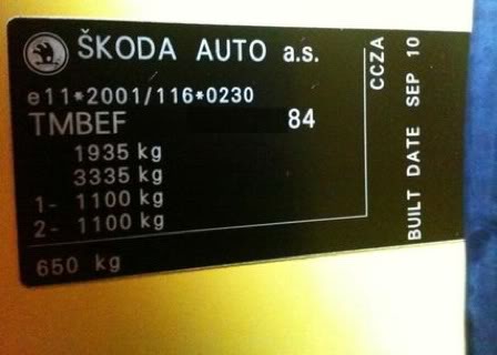

The dealer says no body work has been done (although we all know what dealers are like). I do have the plate as in the picture on the drivers door pillar but from what I remember these don't contain the kerb weight. It's def not going near the dealer for the fix.

On the bottom of the driver's side B post there is a black and silver sticker, with all the weights on.
From the top:
1 : kerb weight
2 : maximum allowed train weight (Car and trailer in other words)
3 : front axle weight limit
4 : rear axle weight limit.
Maximum unbraked trailer weight.
Hi Llanigraham
I thought the top figure was max weight of the vehicle. My figure 1 shows 1965

No, it is the "gross vehicle weight" otherwise known as the kerb weight

Gross Vehicle Weight or Revenue weight, max load allowable,  very different from 'Kerb Weigh / Unladen Weight'.

"Gross vehicle weight" is the maximum allowable vehicle weight and "kerb weight" is the vehicle weight empty with perhaps a tank of fuel.

Gross is everything. Use the weight on the V5c.
