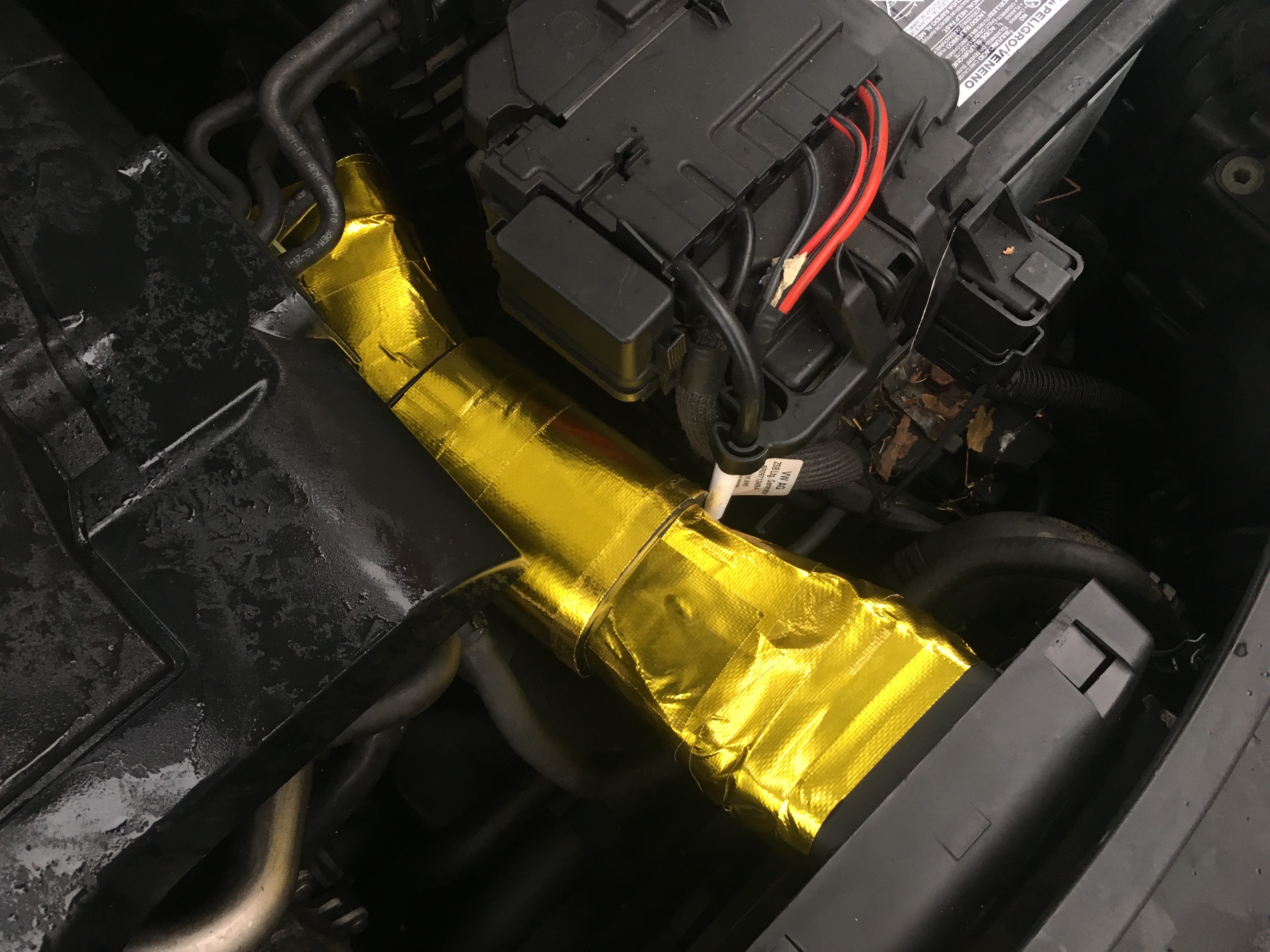

Whats the difference between the VRS intake and the standard one? Also do you think putting heat shielding on the intake helps reduce heat soak?
Edited by JGrindel
It’s almost twice as wide and no idea :D
it’s close to a hot pipe so it’s really to keep the heat out from that.

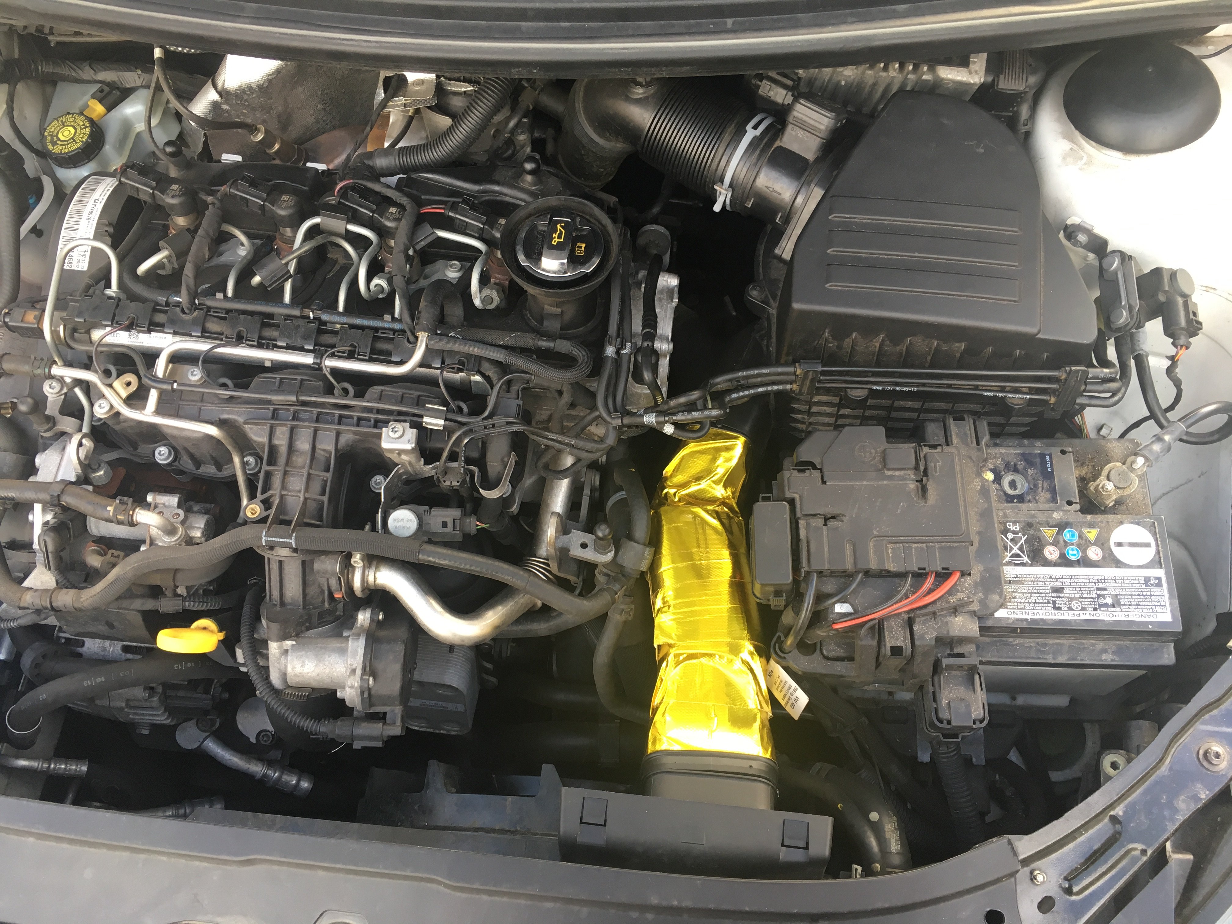

Thats great!! Super cheap and I will believe it makes all the difference as there will be no dyno to prove!! The gold tape, is it a specific brand you used or just amazon / ebay tape? Wanted to cover my intercooler pipes to try and reflect the heat away from them plus it also looks nice.
Edited by JGrindel
I use stuff from Funk Motorsport
Picked up the intake parts from skoda today!! Wow the pictures don't do the size difference justice! It makes the stock one look tiny. Will be fitting sunday :) ty again for the part numbers!

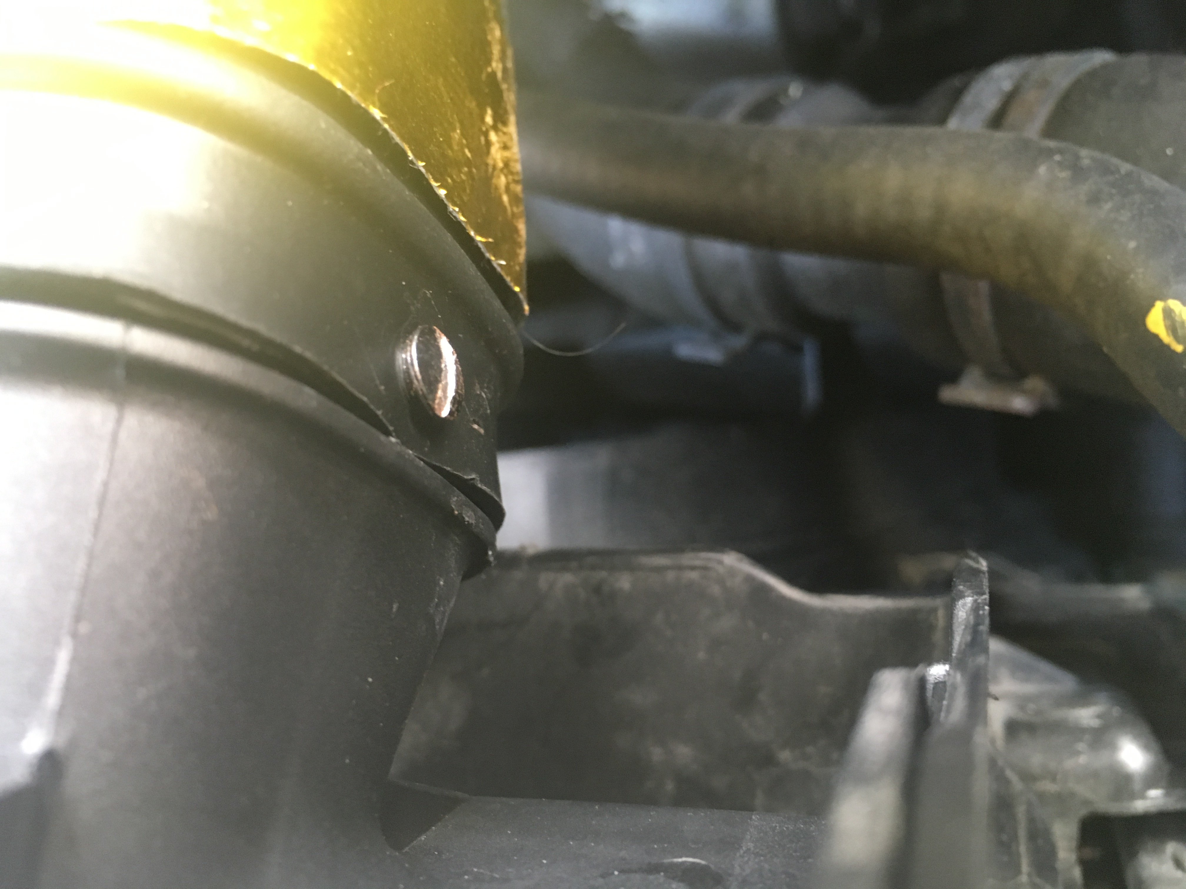

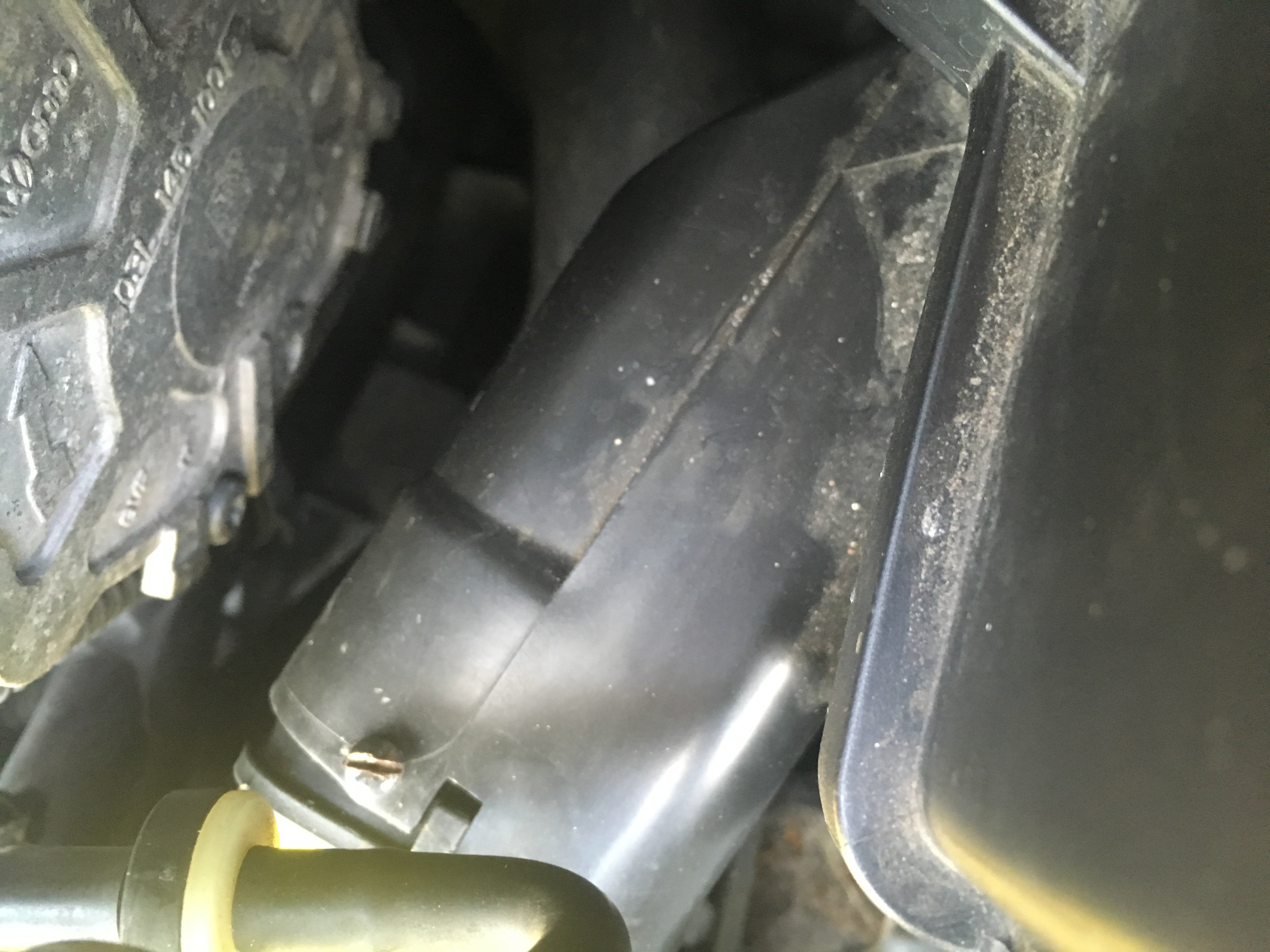

Well that didn’t go exactly as planned. Was a fiddly part to fit because of its size. It wouldn’t properly connect at each end but tapped over the connection points and checked for suction leaks and couldn’t feel any. This week will be the test I guess.
Ty @AMD87 for the part numbers!
Edited by JGrindel
I’ve got mine screwed in to hold it in

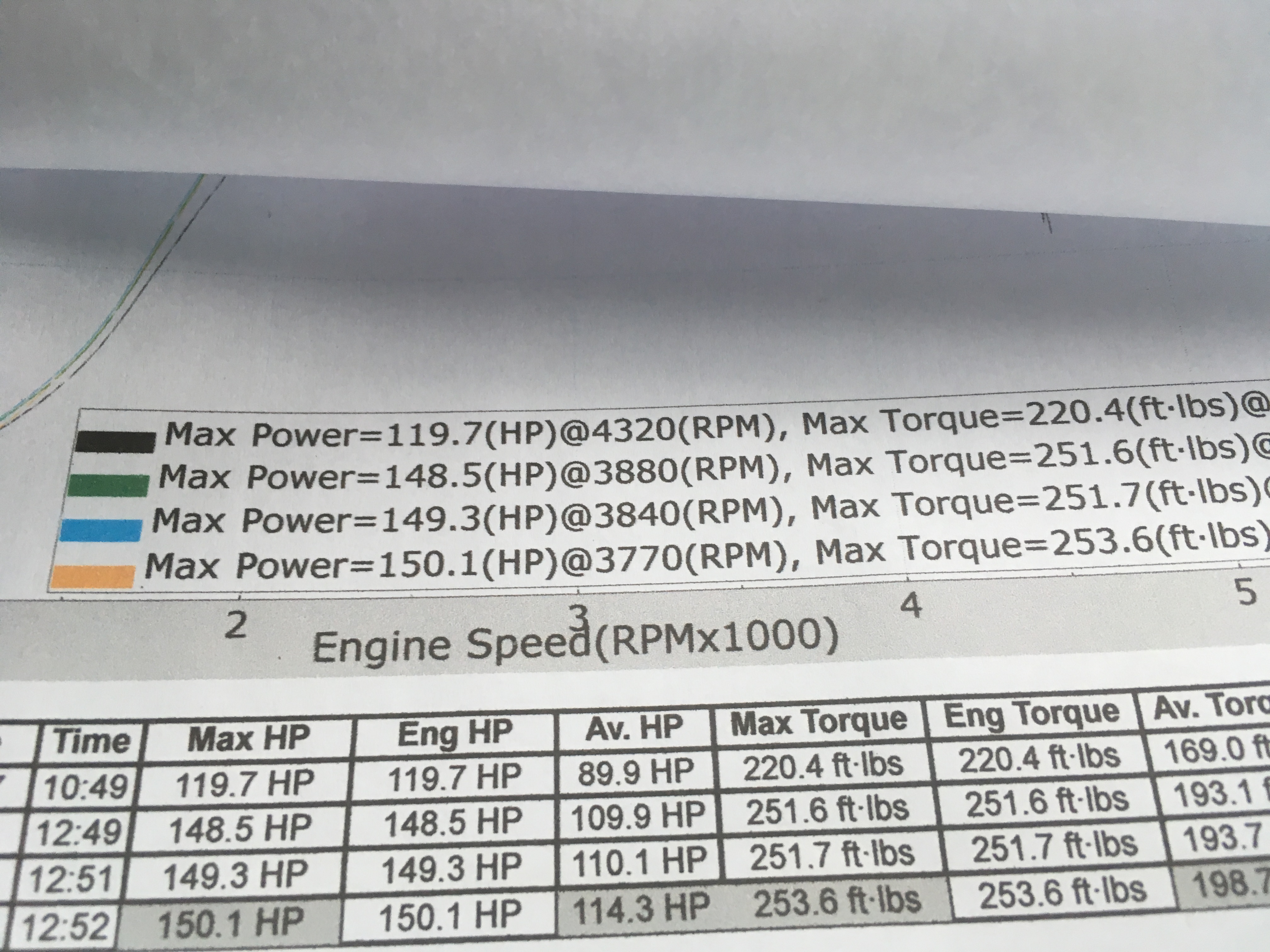

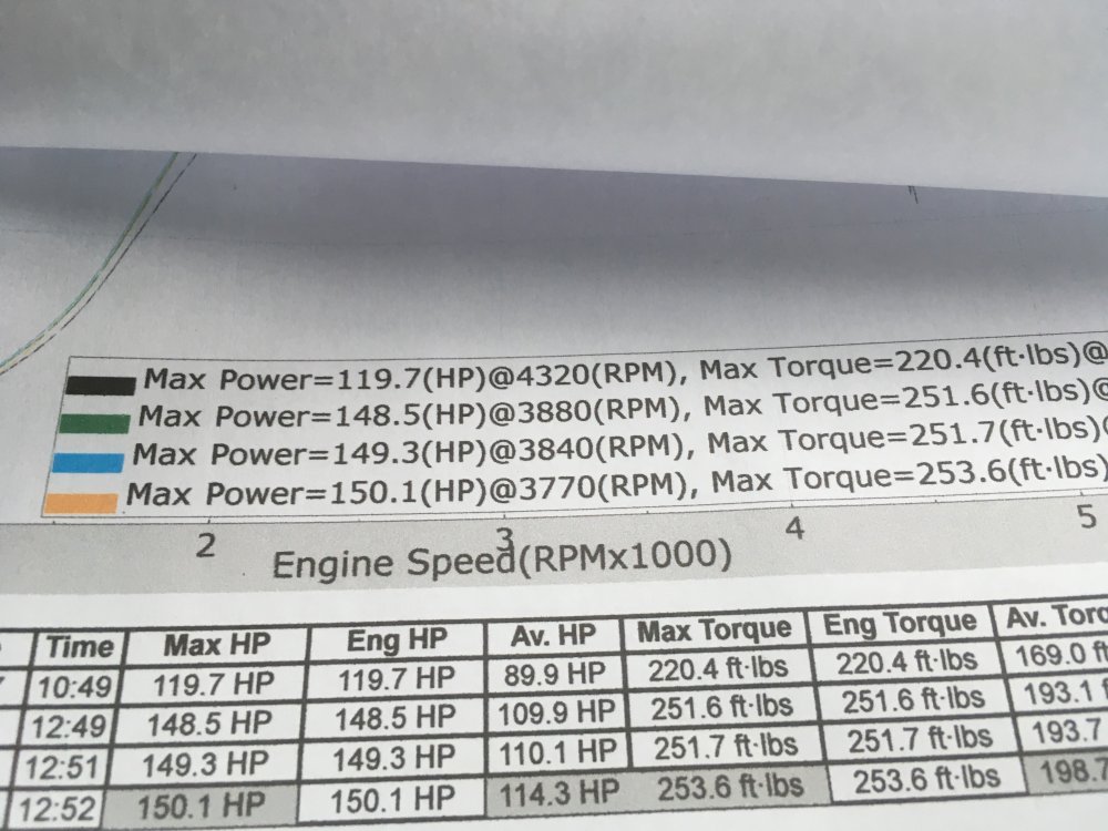

That makes a lot of sense!! it was a interesting fit!! Its all in now so will see how well it holds up. Going on a dyno next Saturday so will be able to see what its pushing.
Has it been mapped? Let’s us know the results at 52k mines made 119bhp and 220ft lbs with just the vRS intake.

Will do, it’s state 1 at the moment with estimated power of 145bhp and 230ft ilbs with stock intake. Will be interesting to see what it’s like with the VRS intake.
Amazinf that yours produced just shy of 120bhp with the vrs intake and stock map!
You should still join :D and I was pretty surprised to although when I bought it I drove it straight to awesome gti where it made the stats on my profile so wondering if the extra 20k and vpower loosened it up abit.

I will be using shell v power on the dyno just to help and also going to give it a good blast before hand to clear the DPF!

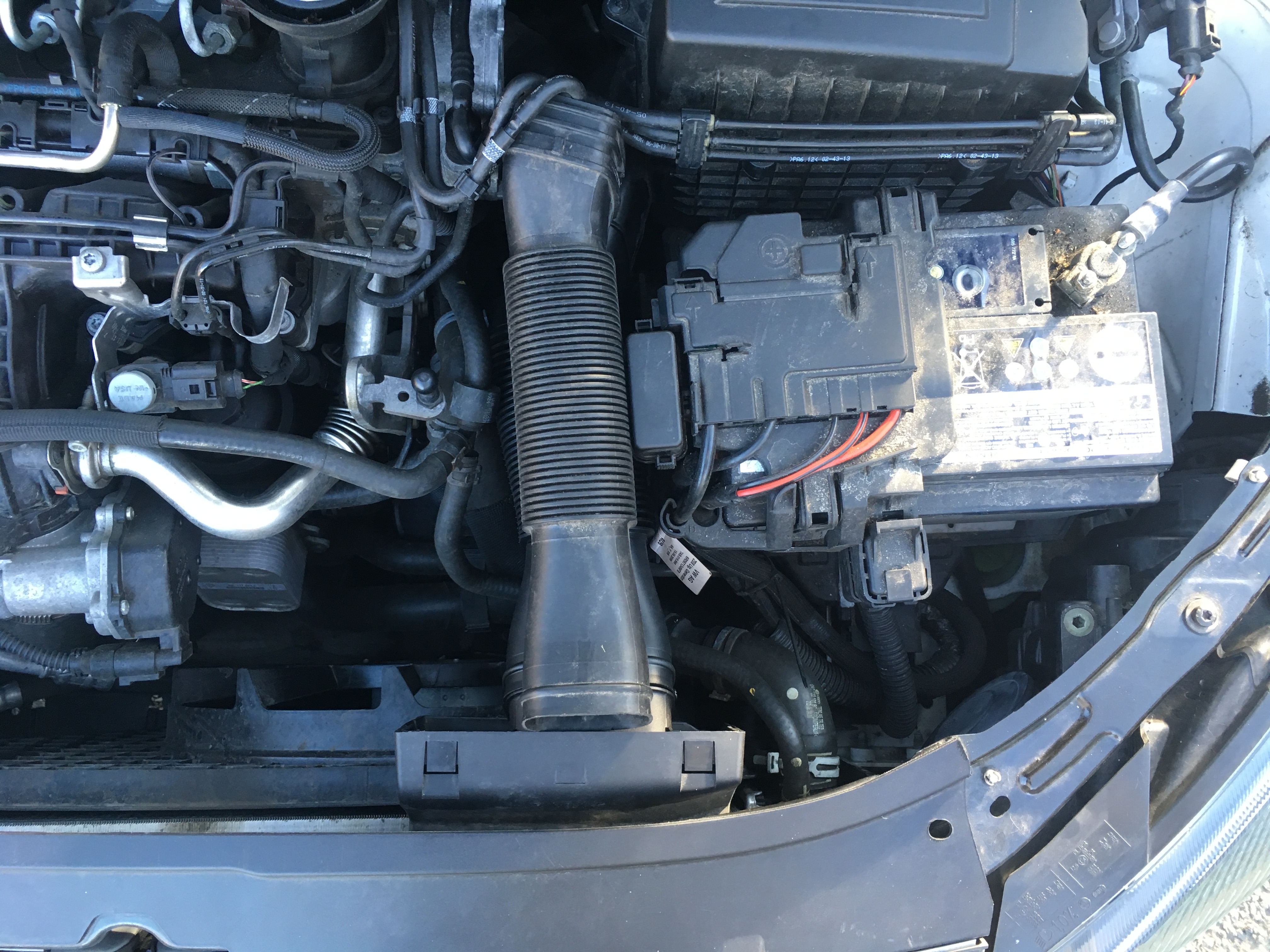

Does the VRs pipe have that giant plastic windbreak attached to the very front of the intake?  I noticed on my current one that half the inlet pipe where it attaches to the bumper seems to be blocked off!
when I had a Focus RS they had something similar, everyone seemed to take a Dremel to it (until someone's noticed that the automatic had a much bigger inlet because it had dreadful power, cue lots of "auto intake" purchases from ford parts).
