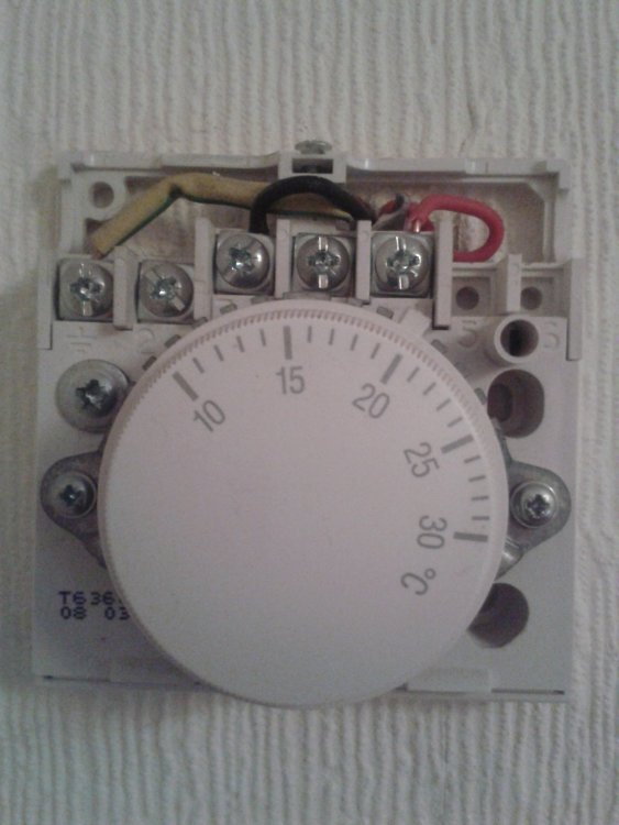

What I need is a roomstat that can't be turned up.
I reckon that 20C max. is about right, I routinely come in from work etc. into a house that feels like a Sauna, look at the stat, and find it has been whacked up to 26C / 28C.

Many room stats have the capability of locking the control range. Usually by pulling the dial off the stat and setting a pair of sliding or moving pins on the back to limit the amount of rotation. Yours may already be one that does this?
TYVM
I levered the dial off, found the pins you referred to and set the max to 24C and turned it down to 20C
That went well - not!!!!
SWMBO went up for a shower and shouted down she was freezing and to turn it up. So I turned it up to 24C
When she came down she fiddled with the dial and discovered that it would no longer turn up to 28C+ like it used to.
After some discussion (you can interpret that how you like) it has been returned to normal.
