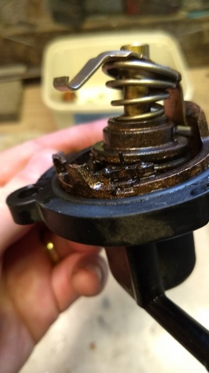

This is exactly the same as my 1.4mpi. up, down, up, down then stable the up then down. If it was warm it stayed ok a little bit cold and all over the place. The answer was a complete new stat and housing. Drain, flush and new coolant and normal service resumed.  Here's a pic of the old stat.

Picked up my new housing today and fitted it to the car. Seems to be much better, car warmed up quicker and stuck at just under 90 degrees. Old stat seemed to not be closed properly even when cold so wondering if that might have been the issue.
