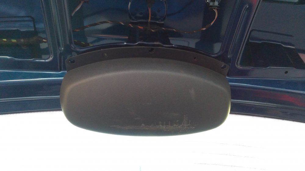

Hi guys,
I am just in the process of replacing the wiper motor. Does anyone know how to remove the cover in the picture?  I removed the screwes and there is a play in the cover now, but it still won't come off for me, no matter what side I push/pull.
Thank you
