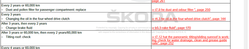

Skoda UK years ago eventually followed VW when the Guidelines / Recommendations were reduced from 40,000 / 4 years to 30,000 miles / 3 years.
Skoda just went first with 30,000 miles but not the 3 years, then they caught up.
Still many Dealerships only did have a job and changed just the oil no clean out or Screen clean or replacing.
3 years / 30,000 miles for the first time has been far too long for some cars.

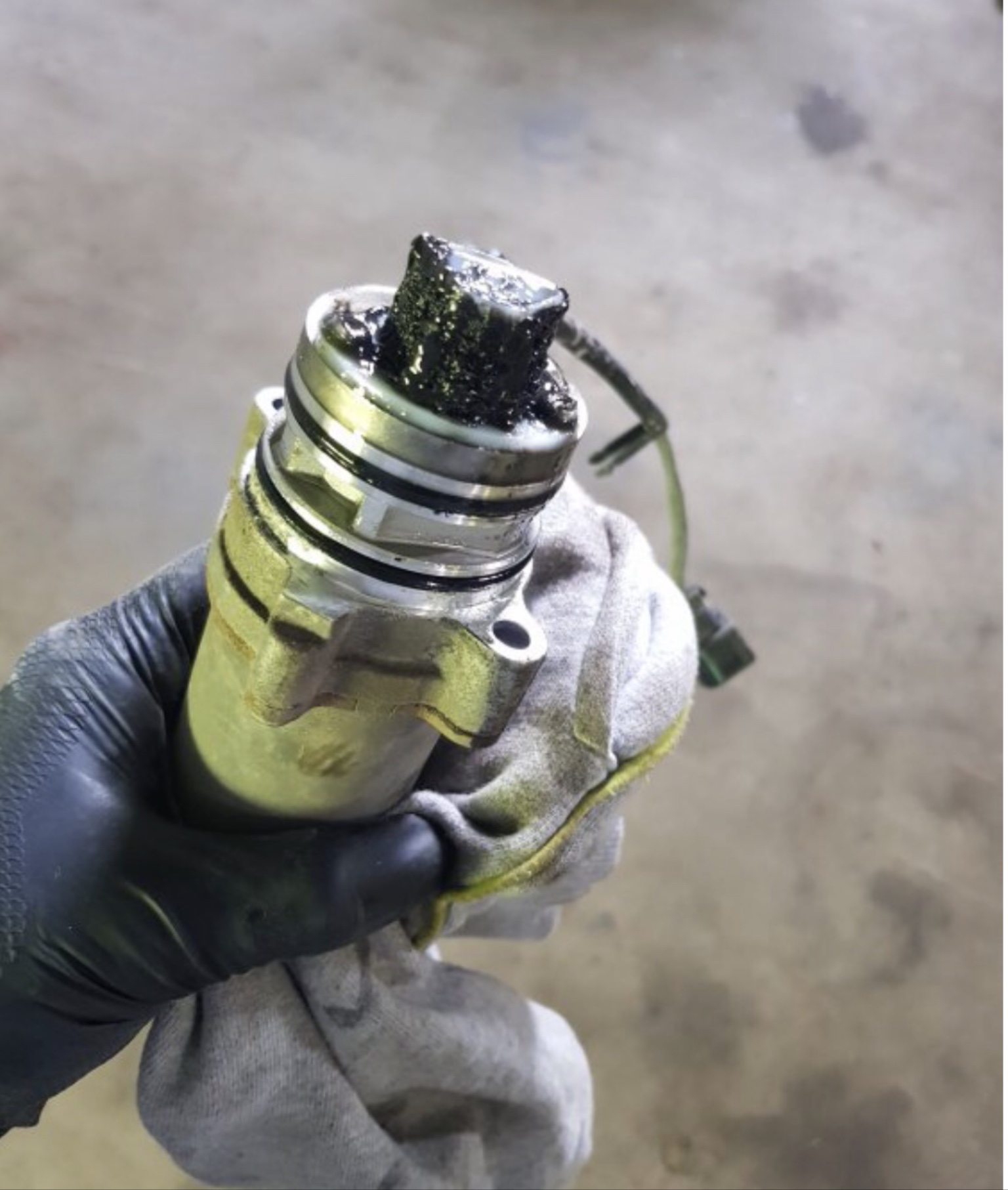

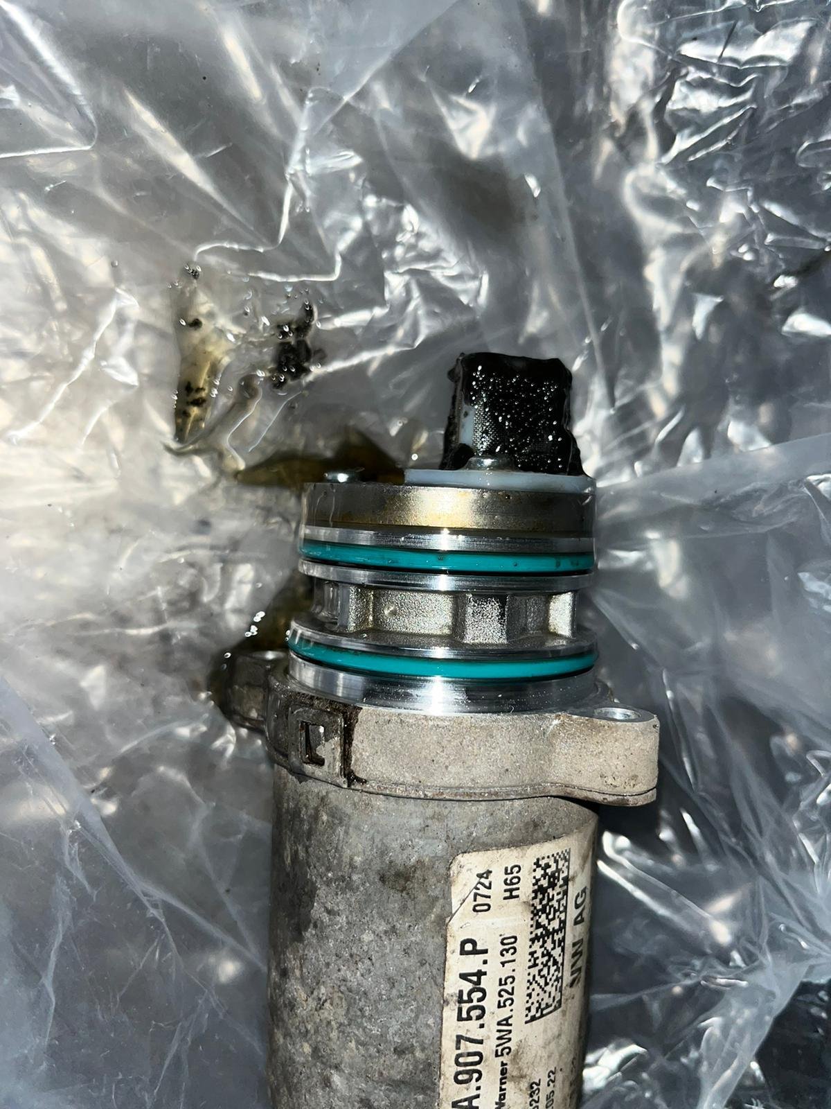

My previous Kodiaq had the Haldex oil changed and the pump mesh cleaned at the 3rd service 16k and the mesh filter looked similar to this. Hate to think what it will be like at 30k.
I guess a lot of it depends on driving style? Quite a few pictures on this thread show some very dirty filters with little mileage and some that look not nearly so bad with considerably higher mileage...

I agree, no mileage is strange Haldex oil replacement. Every 30000 miles seems wise, I do it every 45000 which is similar.
Depending on what kind of roads you drive (e.g.: mountains, twisty and/or slippy roads) you may like to reduce the interval. If you drive most of the time on motorways, I think it's a bit luxuous.
Regarding DSG oil change, if you have a DQ381, the interval is twice the interval for DSG6 DQ250 and most DSG gearbox. It can be wise to replace oil earlier. Replacing filter is also wise. I agree with @Rooted

So this is my haldex at 29.5k miles...
Overall roughly how I expected it to be (i.e. not too bad but probably needed doing) so I'll probably continue to do it at around every 30k miles.
I do mine almost at the same frequency (45000km). It has the same amount of dirt on the strainer. Not that bad, but needs to be done, as you say.
