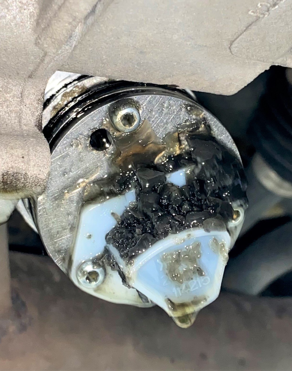

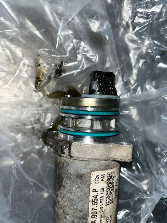

Had mine done this morning by Autotecnic in Sheffield. Very professional outfit and they did a great job. I've booked in next week for the DSG !

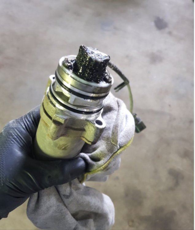

The Haldex ! Wow it needed doing ! One change previously by the dealer who would not clean the strainer.
Pictures speak for themselves ...
Errrk... Good that you had it done properly this time! 👍

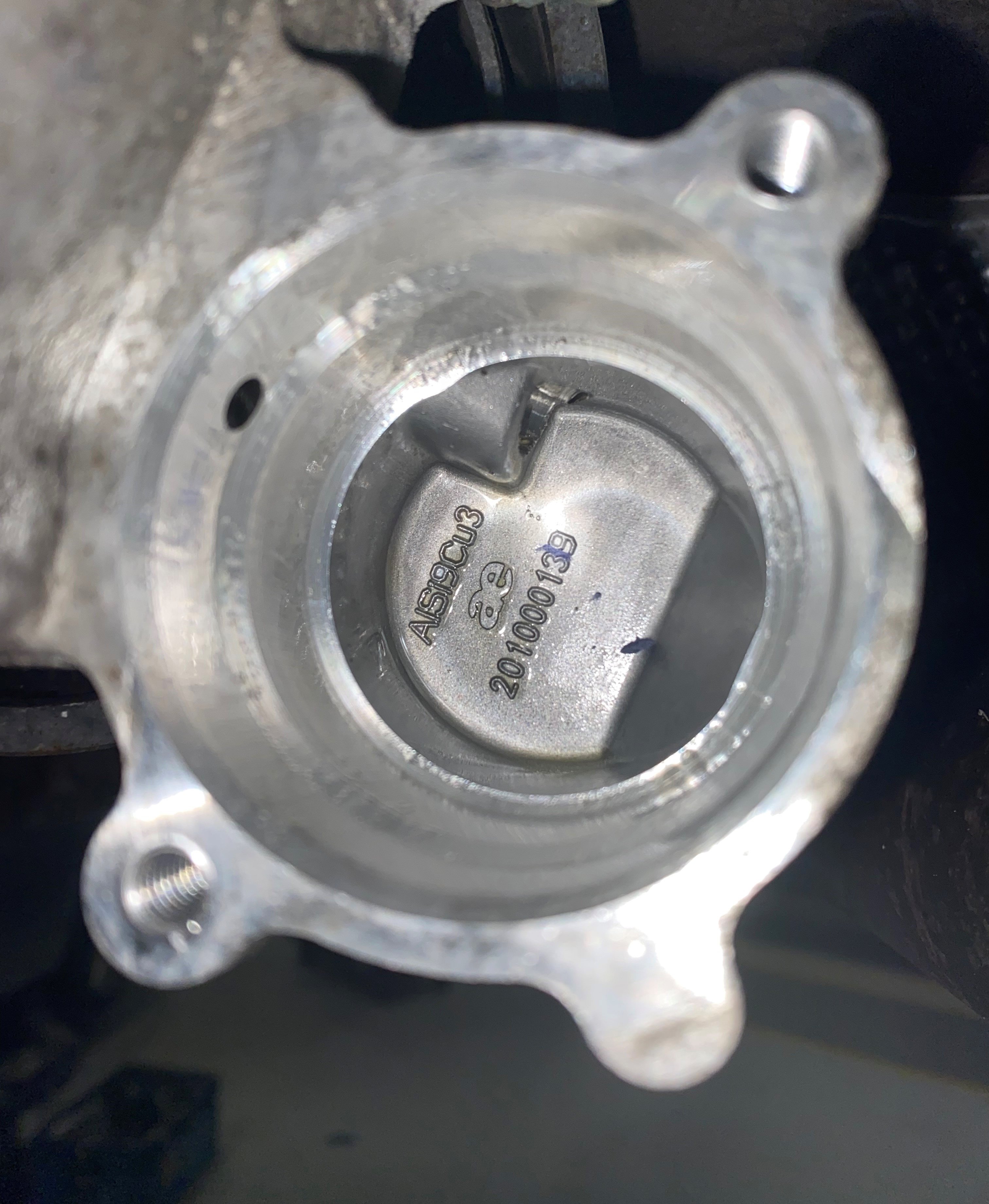

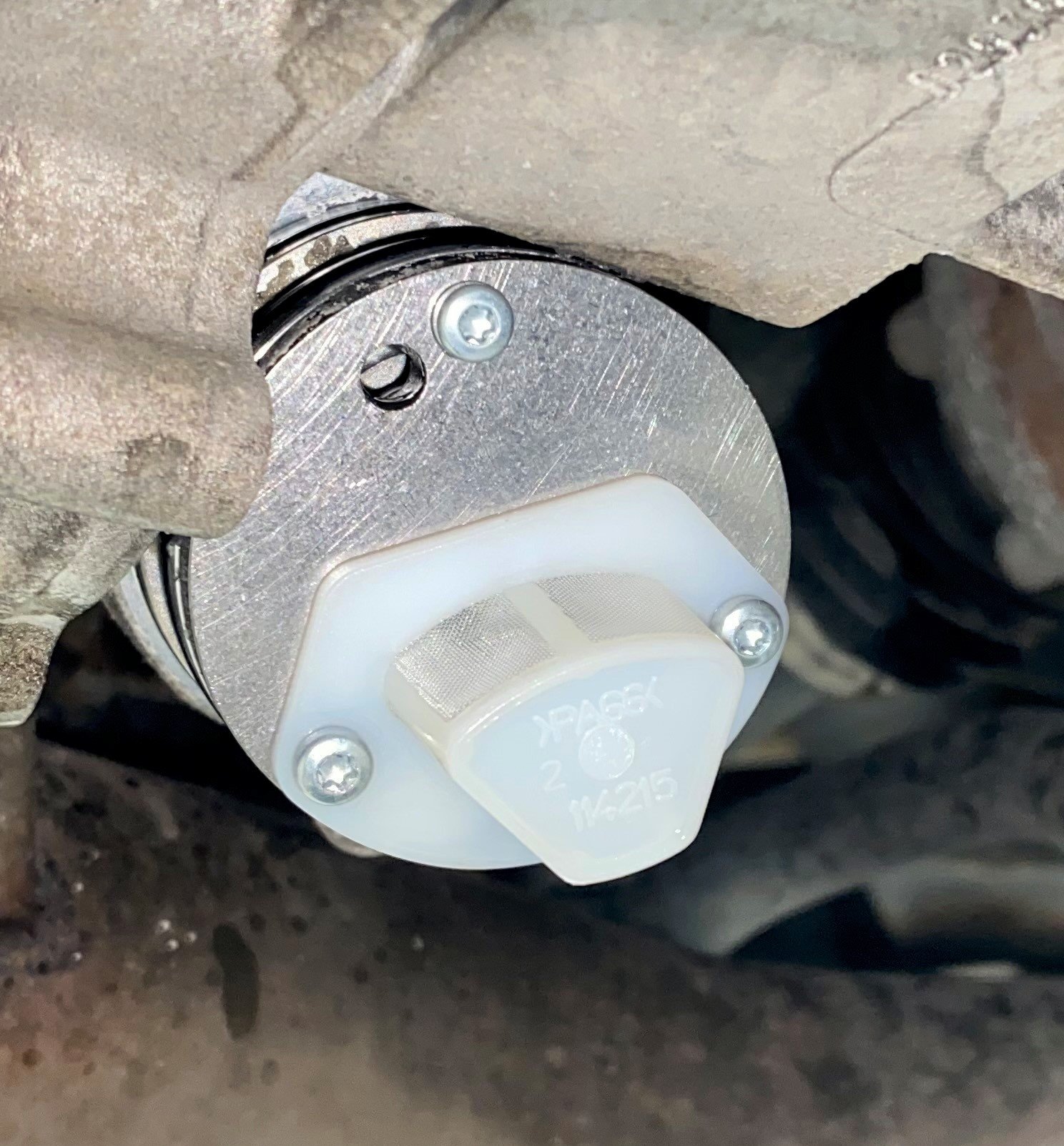

I did it myself at 45000km. It was already quite dirty. Have a look to my ‘How to guide’ to see the pics.
I think 37000 miles or 60000 km is the upper limit to have the pump strainer cleaned.

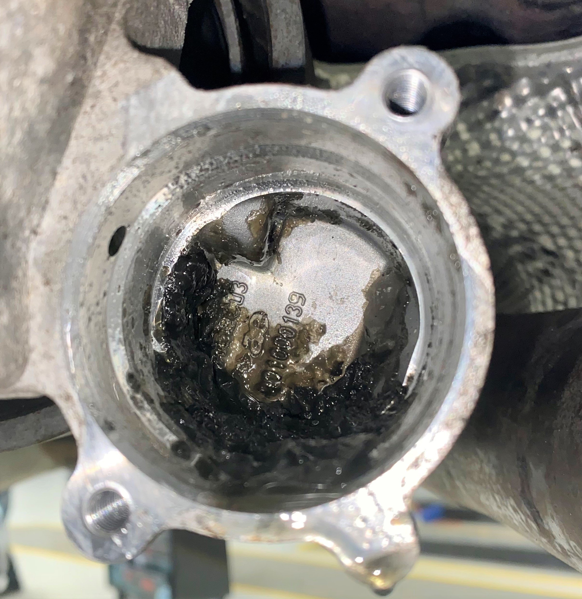

To add to the horror shows, here's my filter after 5 and half years,  68000 miles and one oil change (dealers at 2 years 47000miles, wouldn't do filter). Picture from indie's computer screen hence a bit weird looking. Midland VW near cannock. Very happy with service. £95 for haldex service and clean filter. (Skoda fixed price is £85 just oil change)
For reference, first 2 years it seemed to do 100 miles a day (presumably mway), then I got it and generally drive in town, not fast, but lots of  spirited roundabout entries etc that must tax the 4x4 as I avoid the wheel spin in damp of prev cars. (Key reason for getting the 280)

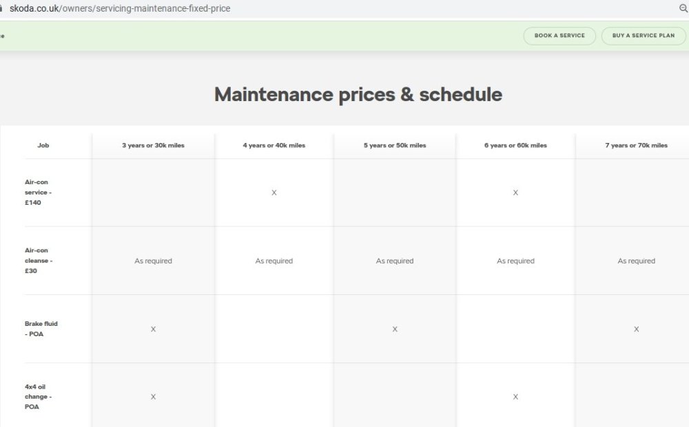

@numskull  So you are already going beyond the Haldex recommendations, guidelines from Skoda / VW Group as seldom is 'schedule' used.
It is @ 3 years / 30,000 miles or sooner.
Different from the DSG which is @ 40,000 years. (or sooner)

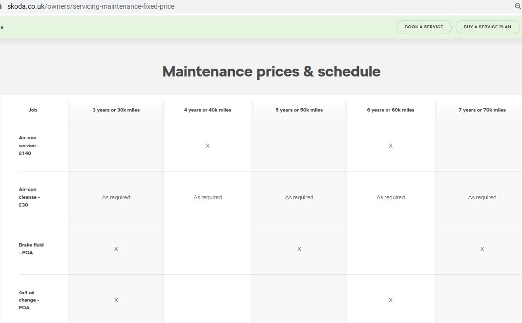

I was aware of the time schedule, but I had never seen any mileage limit.
Where did you find this information? Thank you for sharing. :)

Thanks for the heads up, mine has done 24k and is 4 years old, couldn't find any reference of the work being done so I asked my indie if he'd do it during the service/mot yesterday.  He showed me pics of it as it came out, wasn't quite as bad as some of the pics above but it was covered in gunk.

I just did mine again at 6 years / 80k. Much less black gloop than the first time, but still a thin layer covering all the gauze filter. Still well worth cleaning the gauze filter IMO. It would be an easy job if only the car was up on a lift!
