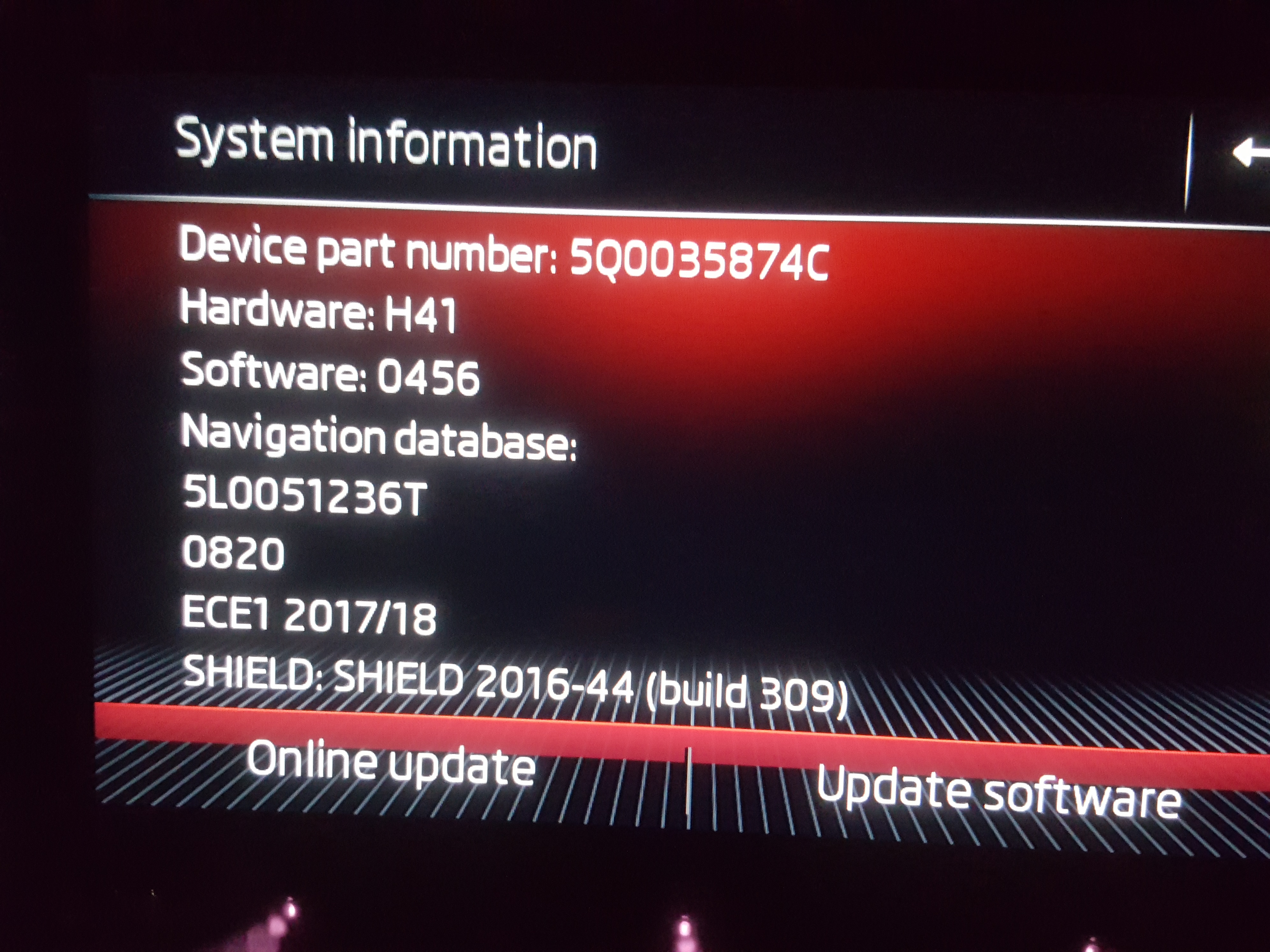

My screen is being replaced as the crack injection repair hasn't worked however, they don't as yet have the software to calibrate the LA camera
Come on Skoda, get your finger out, the hardware/software is as the photo below shows

The software version you've posted is only for the infotainment system. It has no relation with the lane assist camera.
