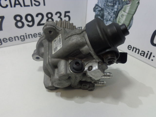

In case you don't know what the fuel pump looks like; here is a picture of a (probably very similar) CR Skoda fuel pump on eBay, secondhand, for £95.  The cam belt drives the pump via the toothed sprocket at the back of this picture.
In the diagram, the fuel pump is no.24.  The fuel filter is no.28.  When serviced (disturbed? Struck?) the fuel filter housing can leak out its top joint, but the garage should've spotted that fairly instantly.
If the fuel pump is leaking into the timing belt cover then you would not see it initially, and it would certainly ruin the cam belt (£450 or less, to replace that).
