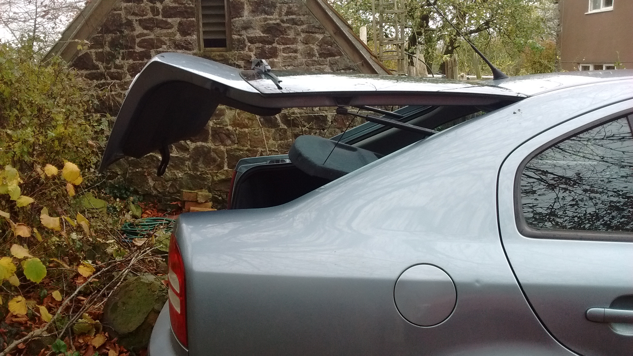

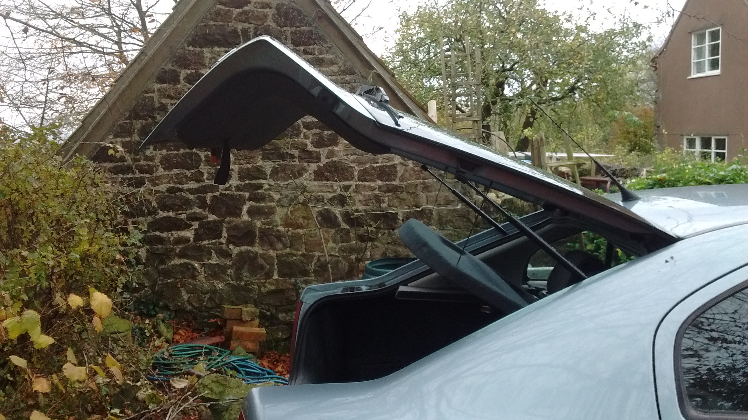

With the SGS struts fitted.
The two pics show the max and min elevation the struts hold the door open.
The old struts would not hold the hatch open.
