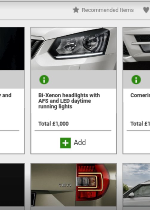

Sorry, they are Bi-Xenons.
The Bi-Xenons do high and low beam with the H7 halogens giving "flash" and assist the high beam.
Reason for that is the Bi-Xenons take a while to get the ark steady so the halogen do that job.
This is from the Skoda website.
Facelift SE L / Elegance and up have the Bi-Xenons and are an option on the others.
