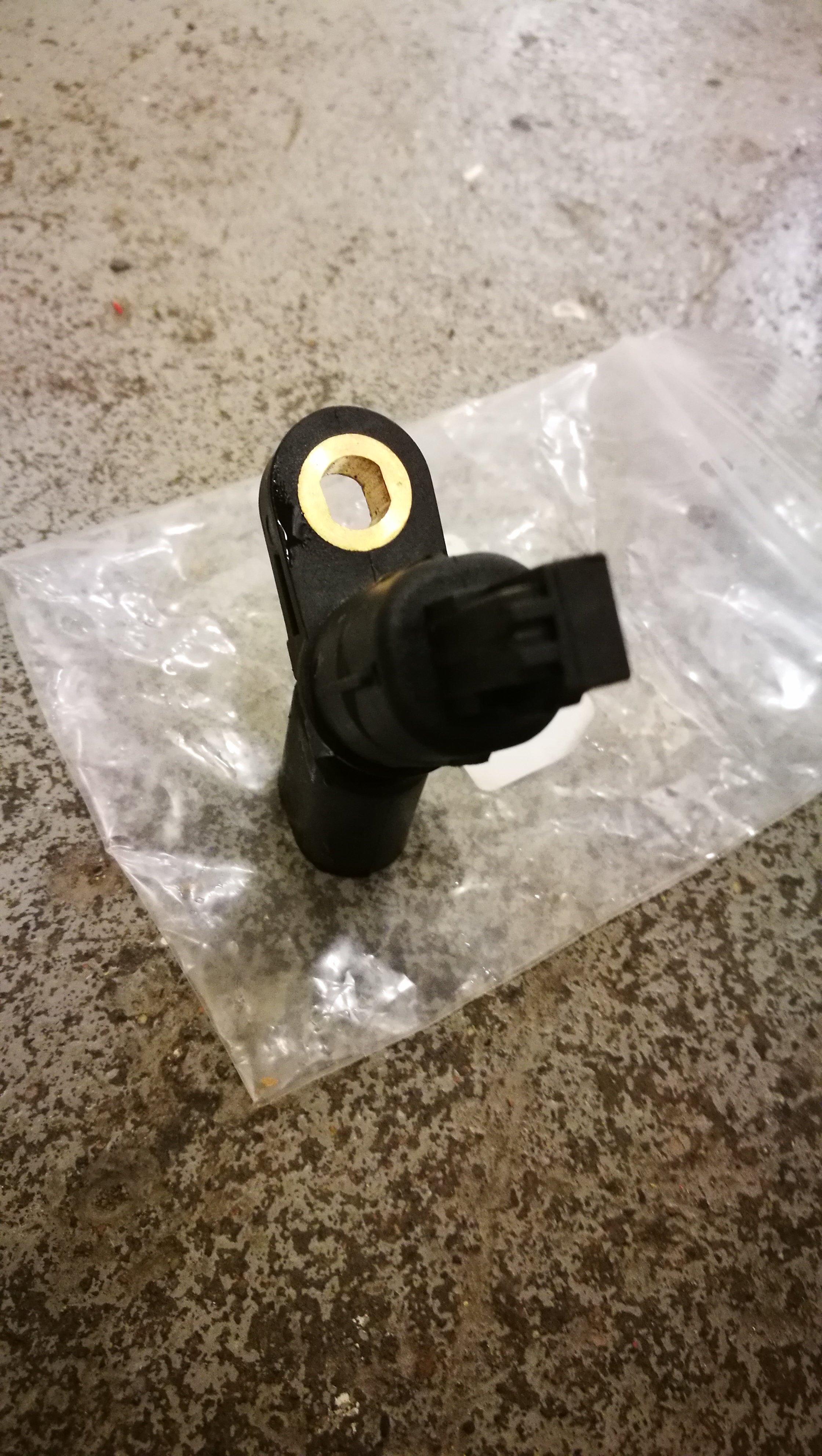

I got a VGgate VS450. It says ABS wheel sensor rear (G46)
00290-035
This was the sensor I changed the last time I had ABS problems, that time I measured it to find a problem with it. It had been working fine, but a sticking caliper has produced heat in the brake disc, it might have taken damage.
I tried to delete the code, the reader said it was deleted. I turned off the ignition but the ABS light was there. Also the reader showed the code again. Will try to swap it. Would it been one of the other sensors it would been a nightmare to swap, I literally burned the rear left sensor out.

The left and right side sensor is different right? The are sold as the same for both sides on ebay.
Are these rear sensor interchangeable right/left? I have one, but the sensor part i different top/botten, but the metall sensors goes through on both sides.

They are useful on both sides of the sensor, just turn it for the correct side left/right. Deleted the code after installation, worked perfectly with Vgate VS450 with no new warning light. Chiseled the old sensor out with a flat screw driver.
