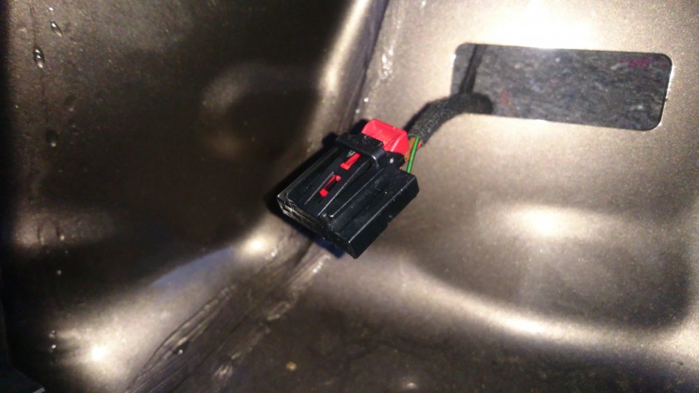

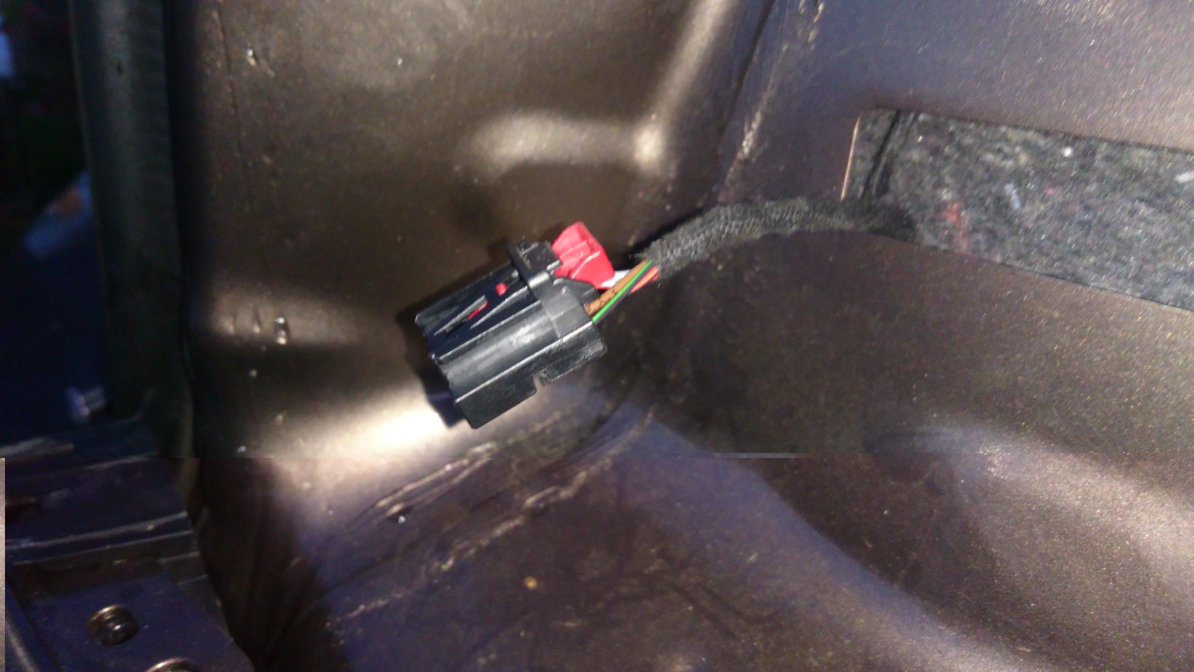

Skoda have retained the very short length of cable between the loom and the back of the light cluster which makes access to the modular connector quite difficult - especially for those like me that have fat hands.
However, they have changed the connector to a new style version that requires two actions to remove it.  I had to use a short screwdriver with a 4mm blade to prise the red lock backwards before pressing down of the black spring-latch.  A swine of a job when you need your spare hand to move and support the whole cluster.
The rest of the job was easy enough after that.

New style connector (OSR)
Same connector, different angle.

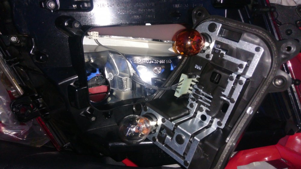

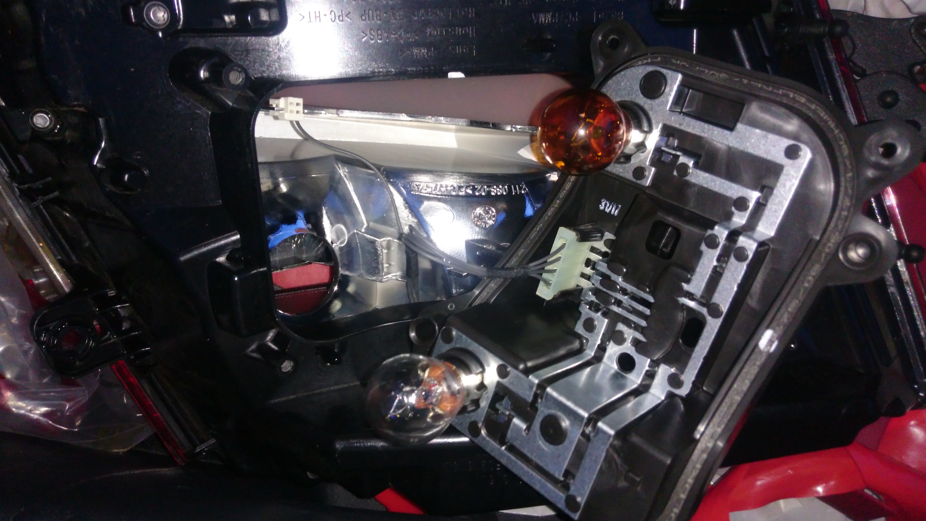

The bulb holder removed. The standard bulb is a PY21W with rotational offset pins.
