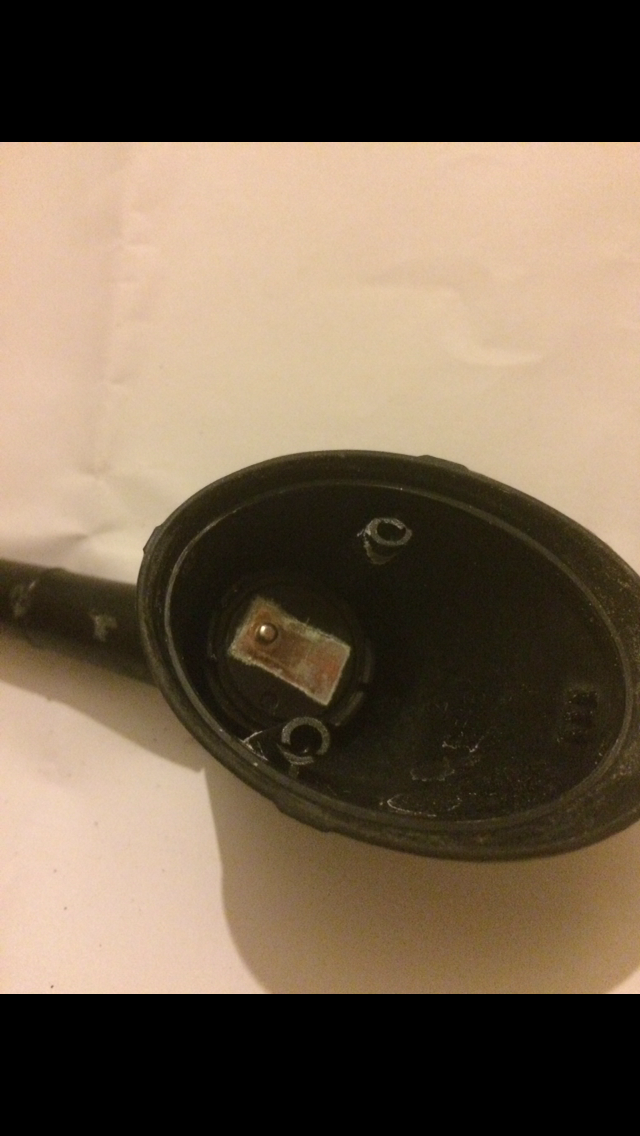

Thanks for all the info. I've added a pic of my aerial - it looks different to that of the aerial in the eBay link you sent in so much that there's another part to the aerial in front of the base. Is that part of the Satnav?
Appreciate your help

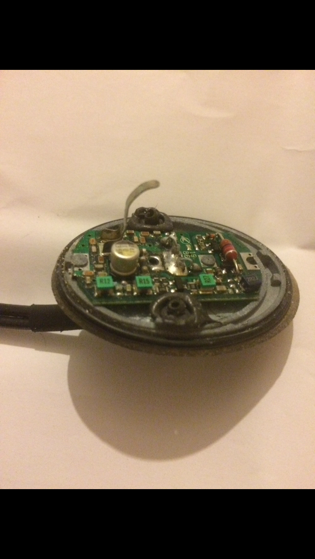

That is the same as fitted on mine, I found a cheap fix for mine, remove the base unit and you will see 2 small phillips screws remove them and you can then split the electronics unit from the plastic cover/whip
The silver bit is the contact to the electronics part
On mine there was corrosion on both the silver bit in the cover and on the tang sticking up from the electronics module, cleaned both up and straightened the tang a bit to ensure better contact pressure on the cover, then reassemble, mines been working fine now for the last 18 months :)

The OP's picture is the one with GPS/FM & possibly GSM, all depends on how many leads come from the base unit
There you go, I haven't come across that design before! Said I could be wrong again! Every day a school day.
