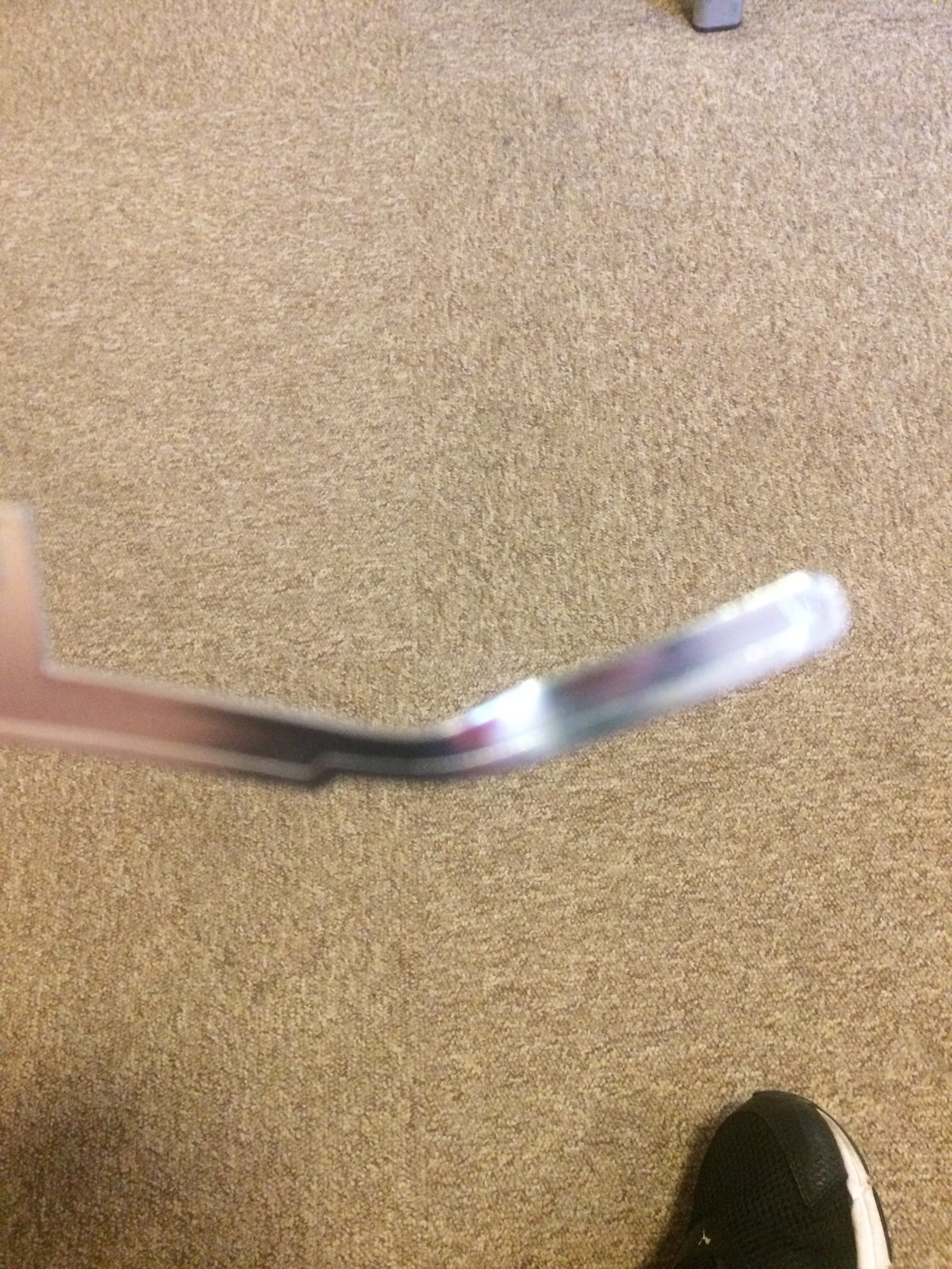

plus rubbish photo to show how bent prongs are. Reckon I can get an eBay refund on these?
  Same bending happened with mine, straighten prongs then instead of pushing from the end, grip close to where they push into radio with pliers pushing in a short bit at a time, re-grip again and repeat. This will release radio but then may need a screwdriver carefully under front edge to push radio out.
