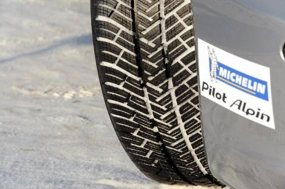

BF Goodrich say
"M+S - This marking indicates that, in accordance with European regulations, it is a "snow" tyre. Nonetheless, its performances in winter conditions are not tested."
Then "3 Peaks Mountain Snow Flake - tyres with this marking are designed for snowy roads and offer performance levels confirmed in tests."
Finally "The symbol made up of three peaks and a snowflake (3pMSF) on M+S (Mud & Snow) tyres designates tyres designed for difficult snow conditions."
Voila -
exemple de marquage hiver : flanc Winter Slalom

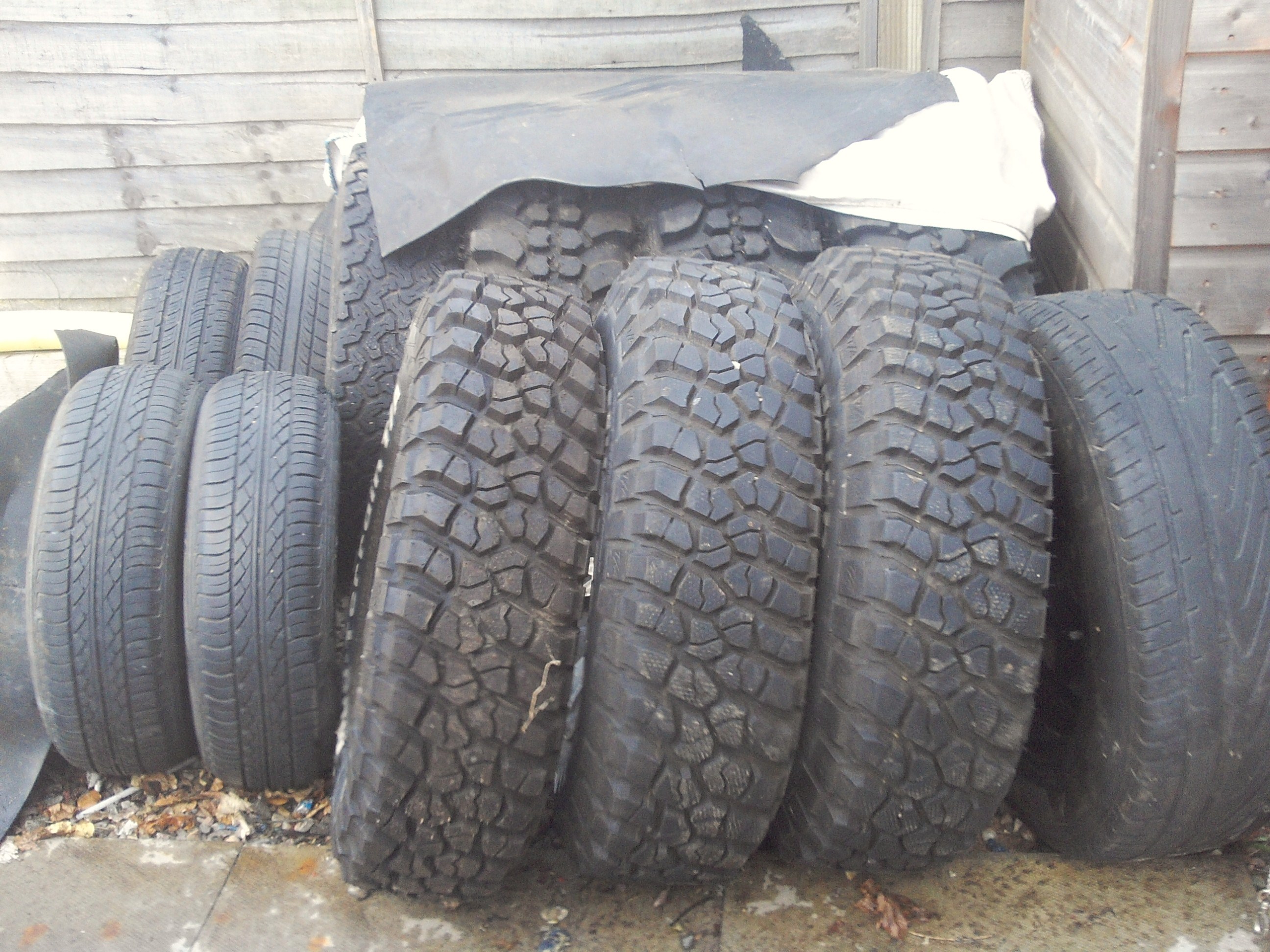

Bottom.  Comparing,
 Snow / Winter tyre,
Winter / All Weather Tyre Marked M&S,
All Season / Summer Tyres.

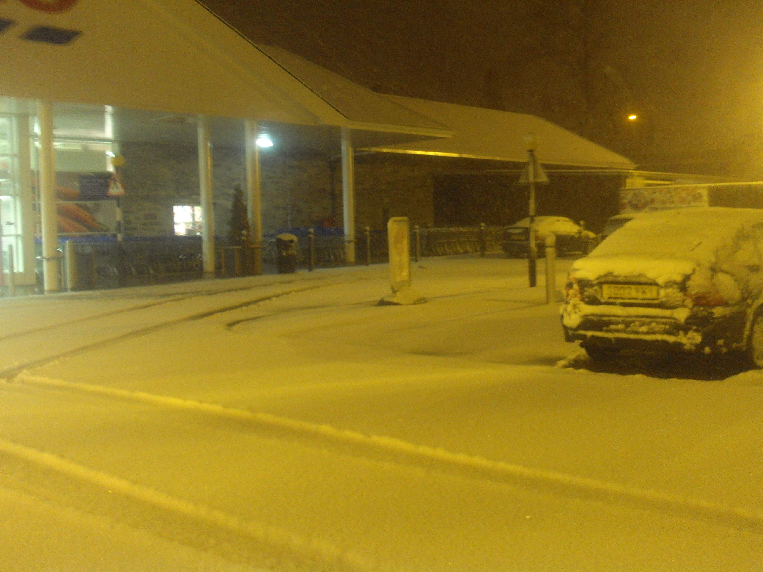

2nd April 2012 20*oC plus. A heatwave for 10 days up to then.
3rd April 2012 Lambing Snows came. Temp drop over 20*oC in 8 hours.
Stuff not having the right tyres on for a Best Driving Road for great Driving Weather.
