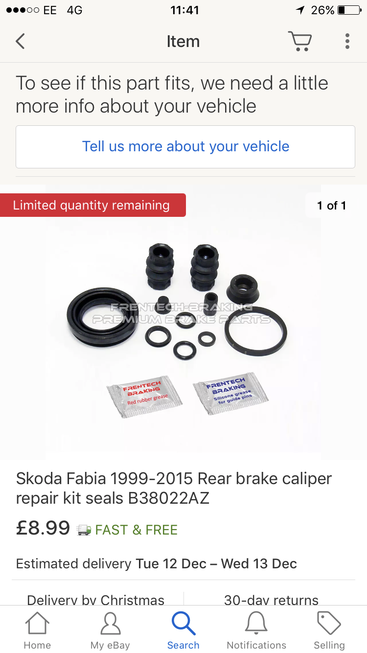

It's okay mate I just used my trade card at Halfords and got it for tenner! Bargain tbh! Yeah I did think this, so it's worth buying a repair kit then? And do the seals etc? Haynes spanner difficulty? How many spanners would you say? Out of 5? If so I'll do both sides to rule out any further issues. What's the cost of the repair kit do you know?
Is this the correct kit?

Couldn't say if it the correct version but I have used that supplier (recognise the picture layout) before for doing my brother Shogun Sport and they are good kits and if they are stating it's right for your car I would trust them.
