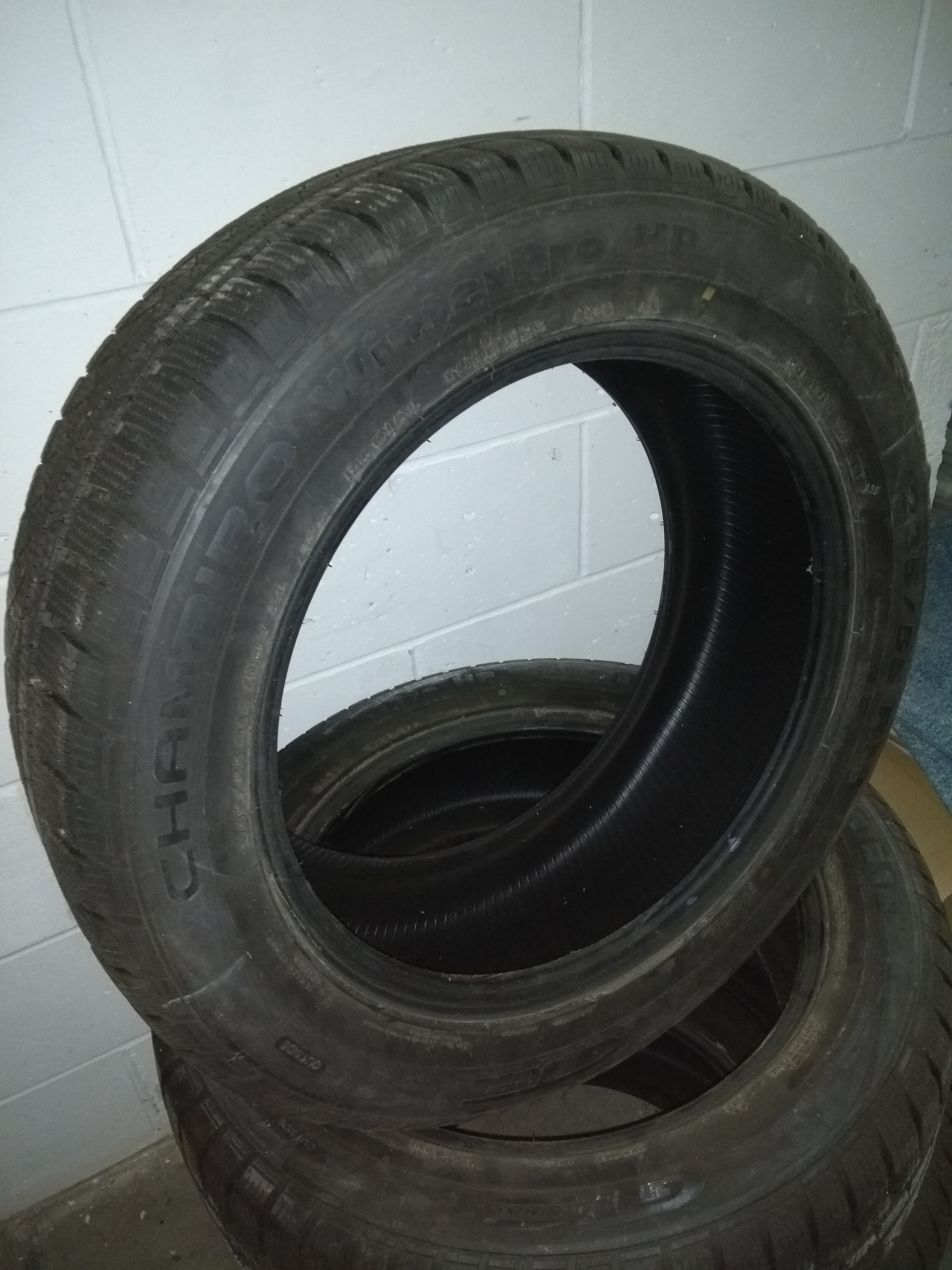

so in light of that news i have for sale 4 x winter tyres
Any offers?
