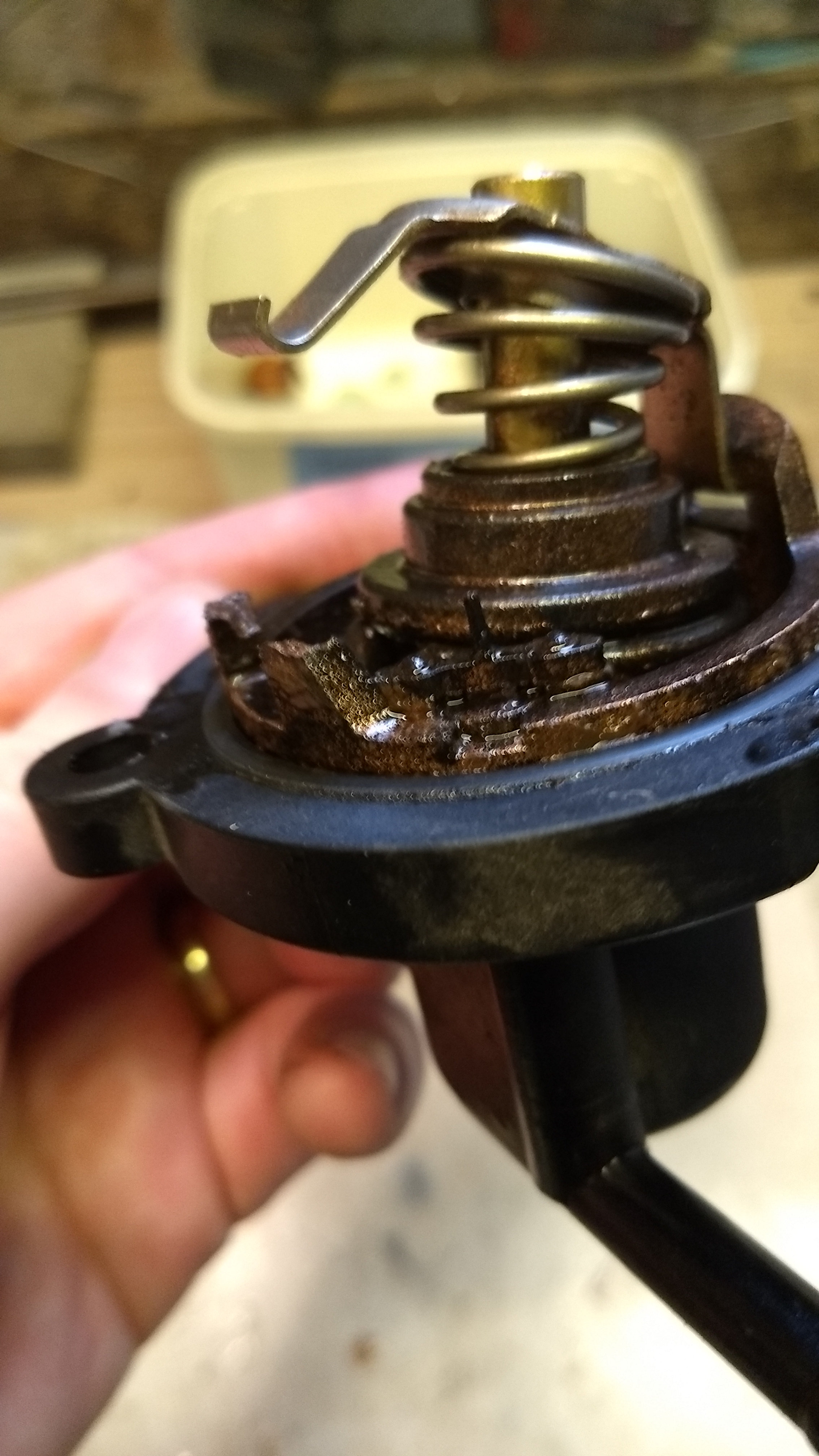

This thermostat from my fabia gave exactly the same symptoms as the original post. As you can see it would still function but then would allow the engine to cool within seconds even when driving.
