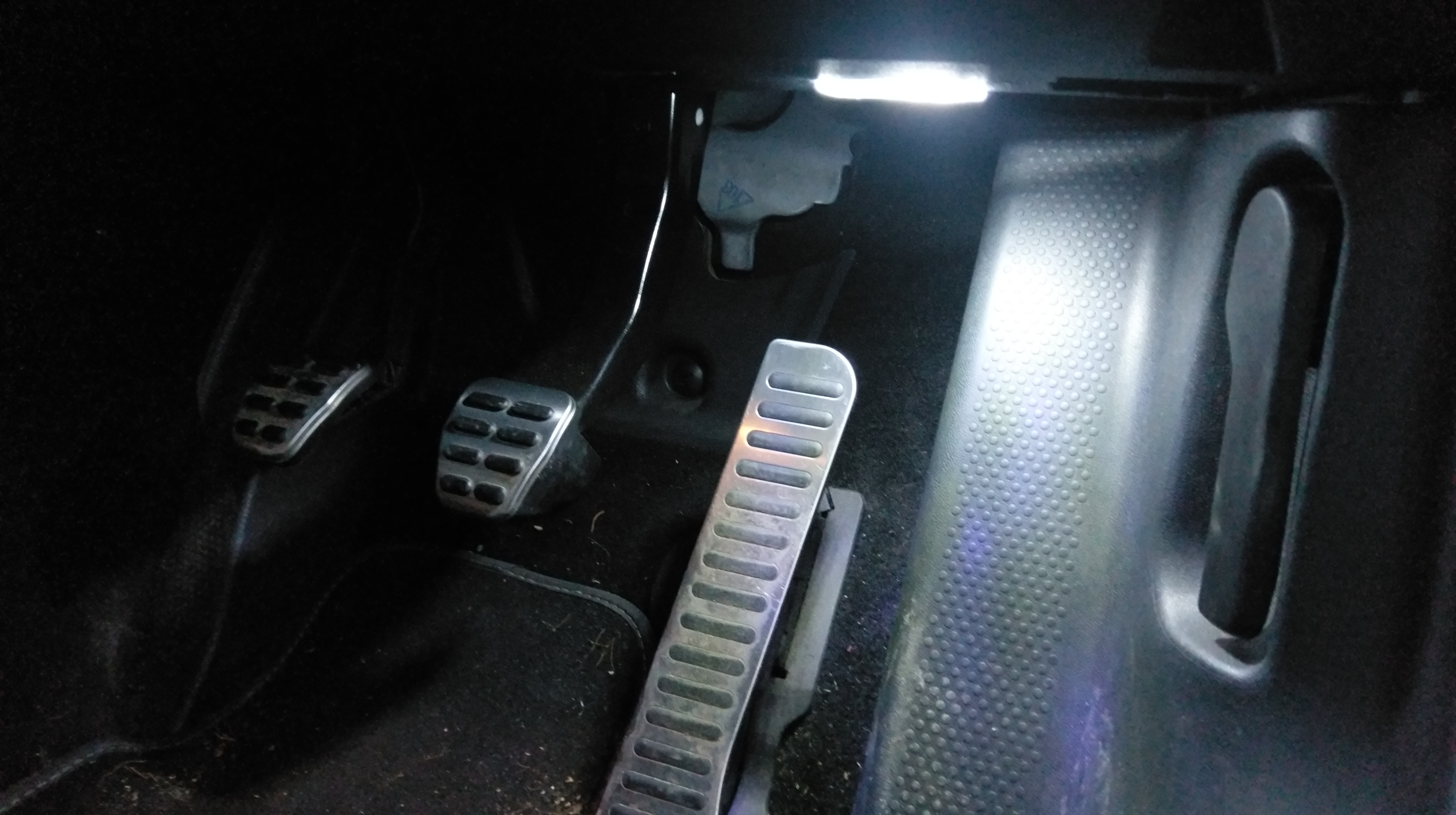

Installed LED footwell lights front and back

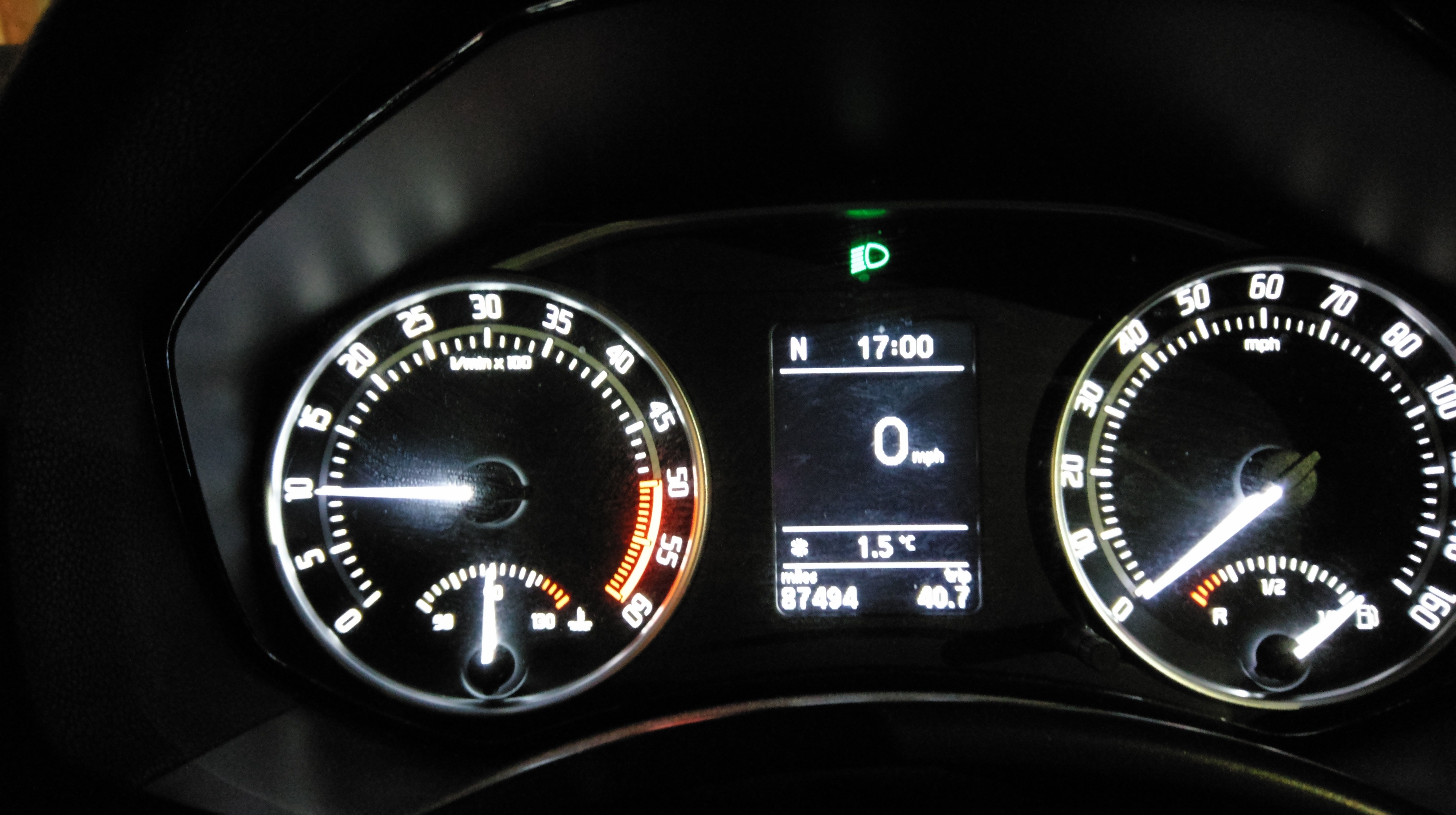

Added large Speedo display

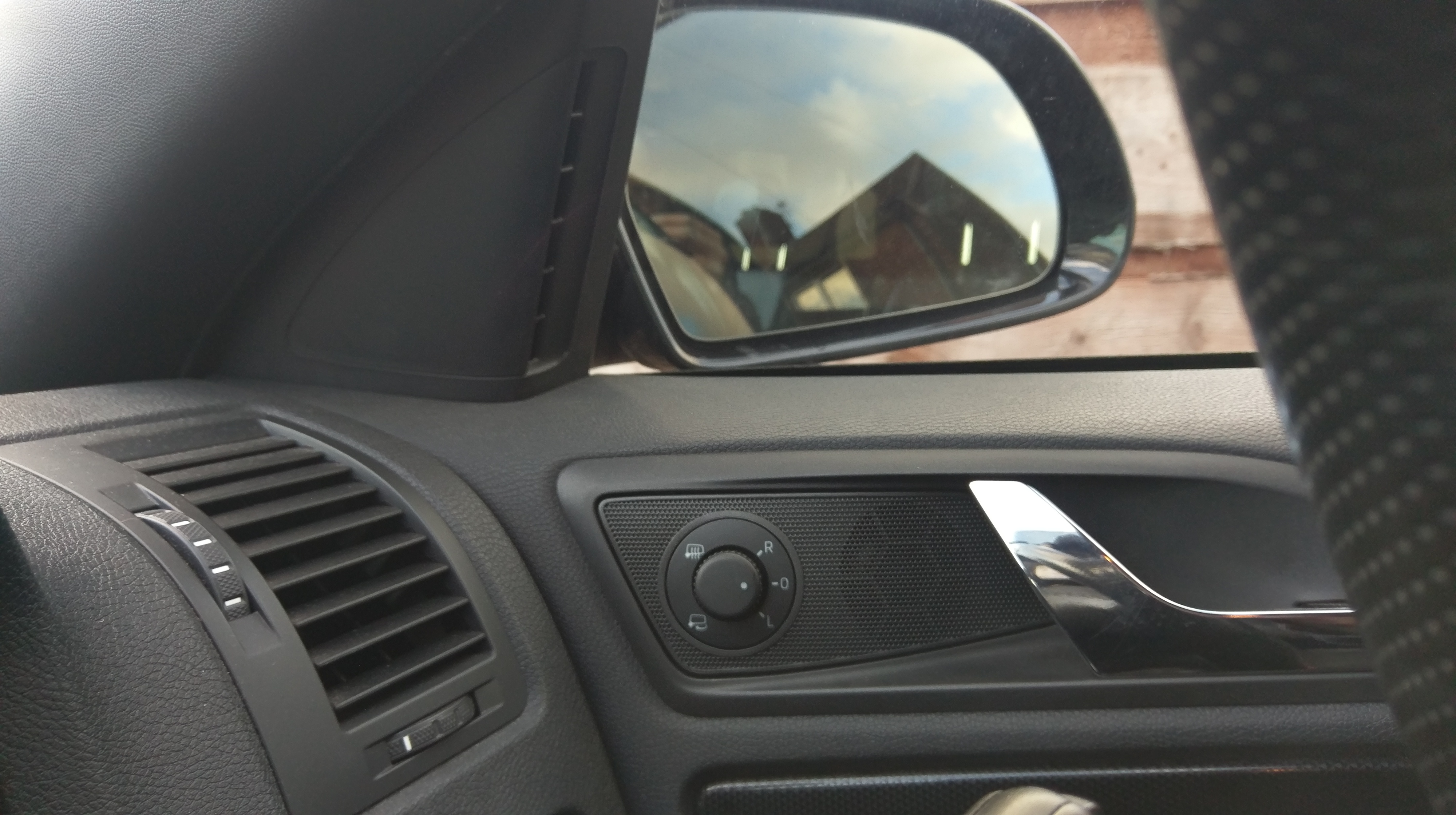

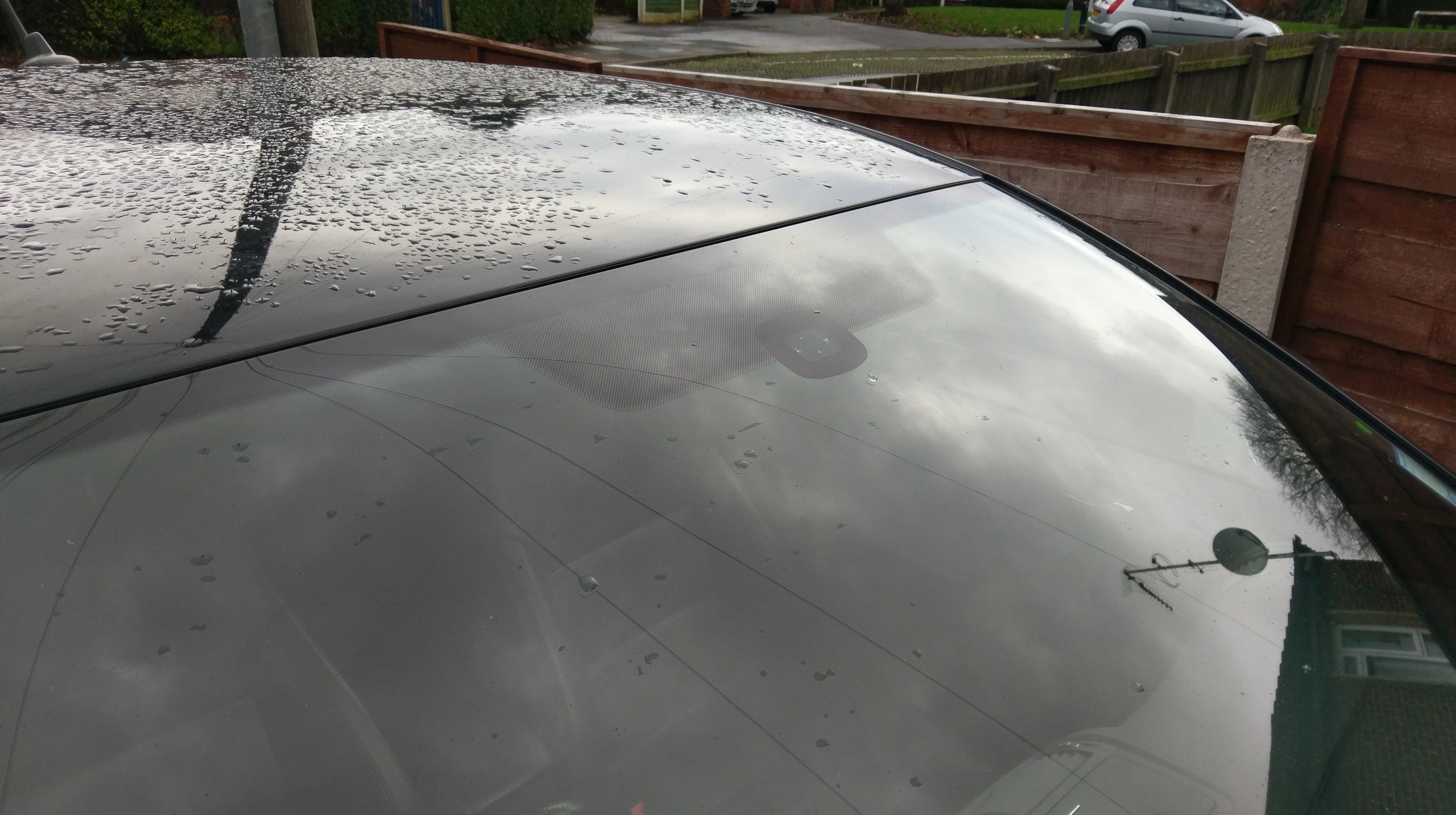

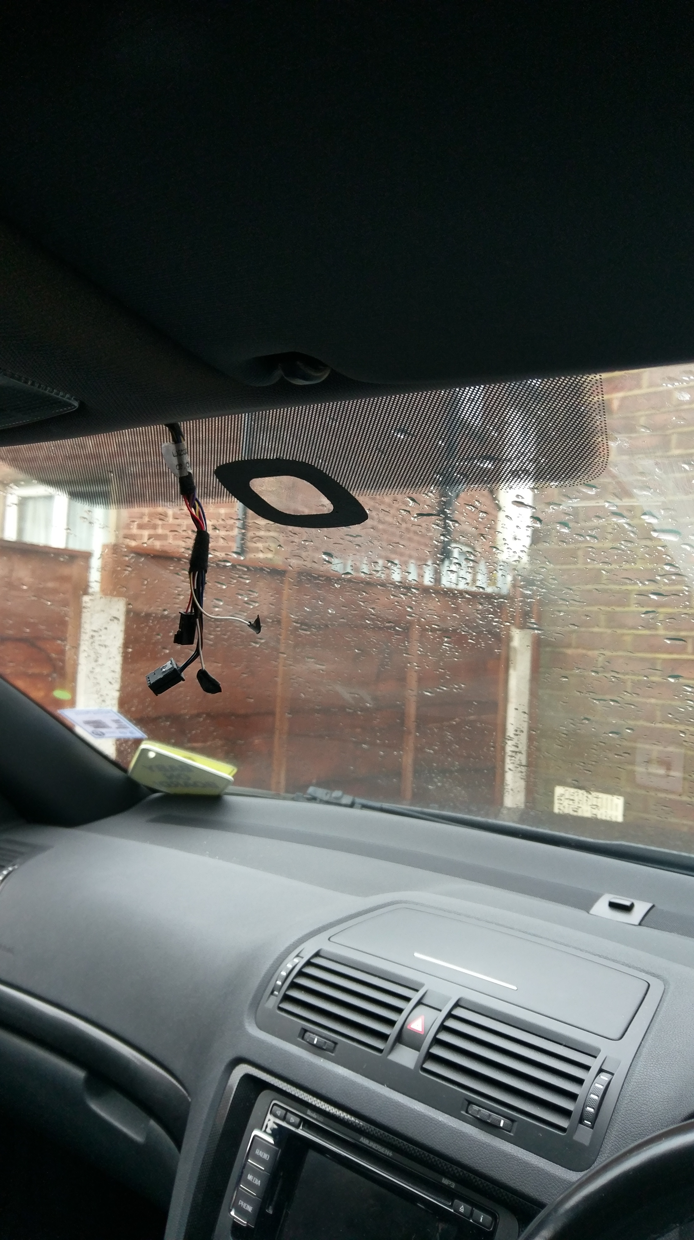

Fitted Rain Light Sensor and Rearview auto dimming mirror.IMAG0169.thumb.jpg.6926589de702bad896ca559dde62a126.jpg
Hi if I may ask how did you go about removing the original mirror and glue behind it? I have the RLS retrofitted to mine but I left the original rear view mirror on. would love the auto dimming mirror :)
If you're right handed it's probably easier to get in on passenger side and grab the mirror by the base closest to the glass (it has grooves either side) turn it clockwise without pulling it towards you or pushing it. It does require medium force and will come off.
Once off there'll be a metal fixing plate left. I have a heat gun for my shrink wrap because a lighter is too fiddly. Warm up the mount and it'll come off. Be patient with it and make sure heat is even and you've covered centre console just it case it drops before you're ready to catch it.
When it either falls off or you are able to move it off the glue might be left or come with it. If it's still on, warm it a bit and use a flat filing knife and with a little bit off pressure at the edge it'll just slide off as a whole piece.
When you want to remove the spot take your time and start off 800 grit and work to 1500. You can start lower and be faster but you'll need to change up quickly as soon as you start breaking through. If you have covers for the light sensor like mine you'll have to go quite far up into the little dots. Make sure you stay in the wiper swept area. It's very tight.

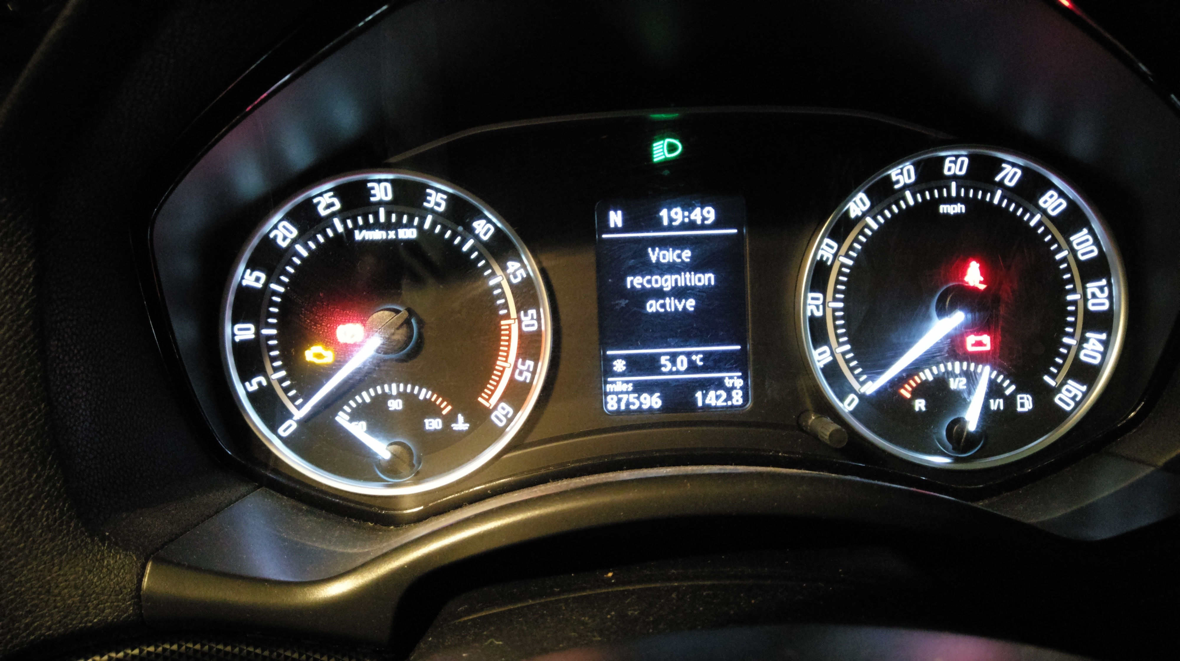

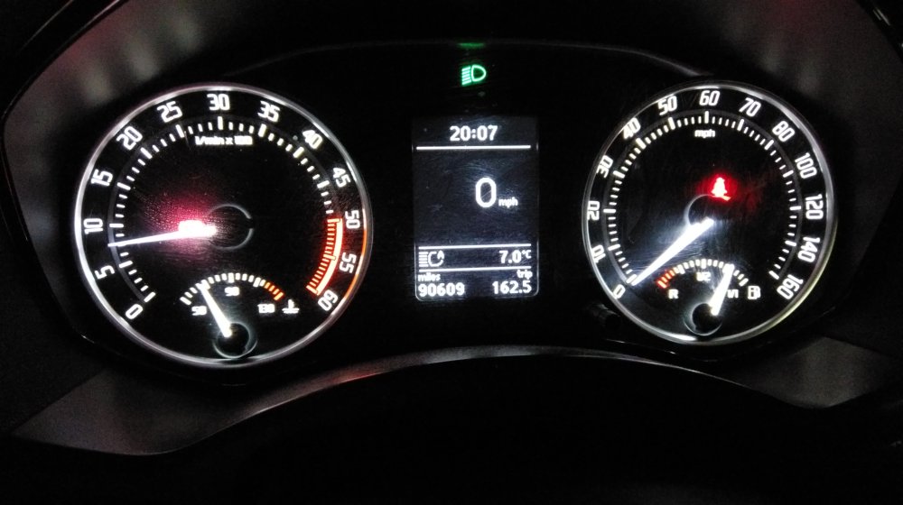

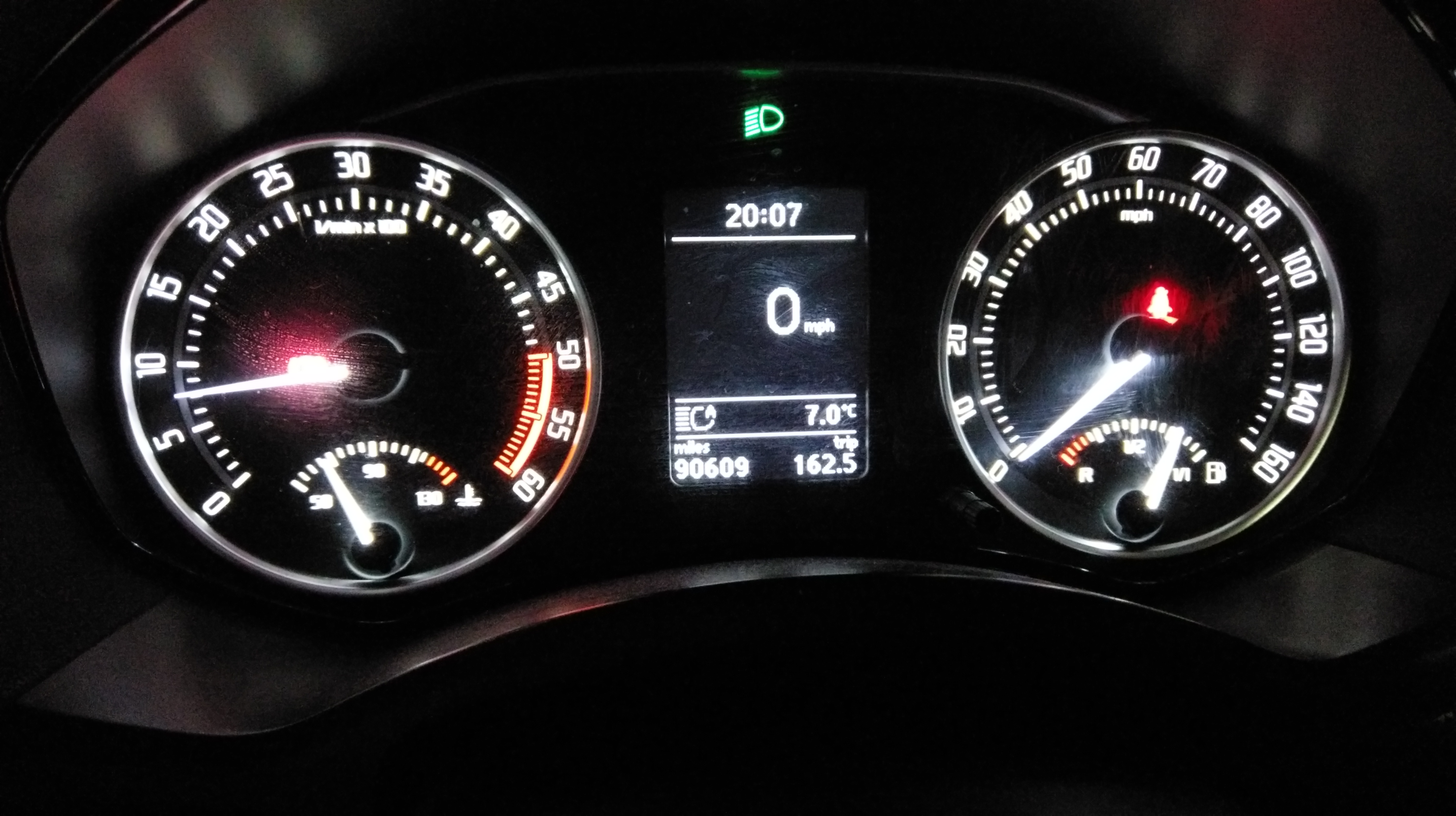

How did yout manage this display? Mine only shows lymph in lower part of maxidot.
Thanks
S!NGH
Edited by KSINGH
Sorry, it's not foot well light I wanted to ask about.
Thanks
S!NGH
It's a 2 step process. First you need to set the country to Australia. Then change settings in maxidot.
To change the country go to 17- Instruments and click on "Coding - 07"
Then click on "Long Coding Helper"
Finally under Bit 4 select "70 Country: Australia (AUS)". Once you have made the changes with VCDS you then need to go into the maxi-dot menu:
SETTINGS➡️Units➡️Consu/distance change this back to mpg (GB), mi (as it defaults to 1/100km, km),
then
SETTINGS➡️MFD data and make sure the box for "Digit.speed" is ticked
You can also remove the KPH display at the bottom and replace it with the outside temperature:
SETTINGS➡️untick the "ALT.speed dis." box (this will remove the KPH speed and replace it with the outside temp display)

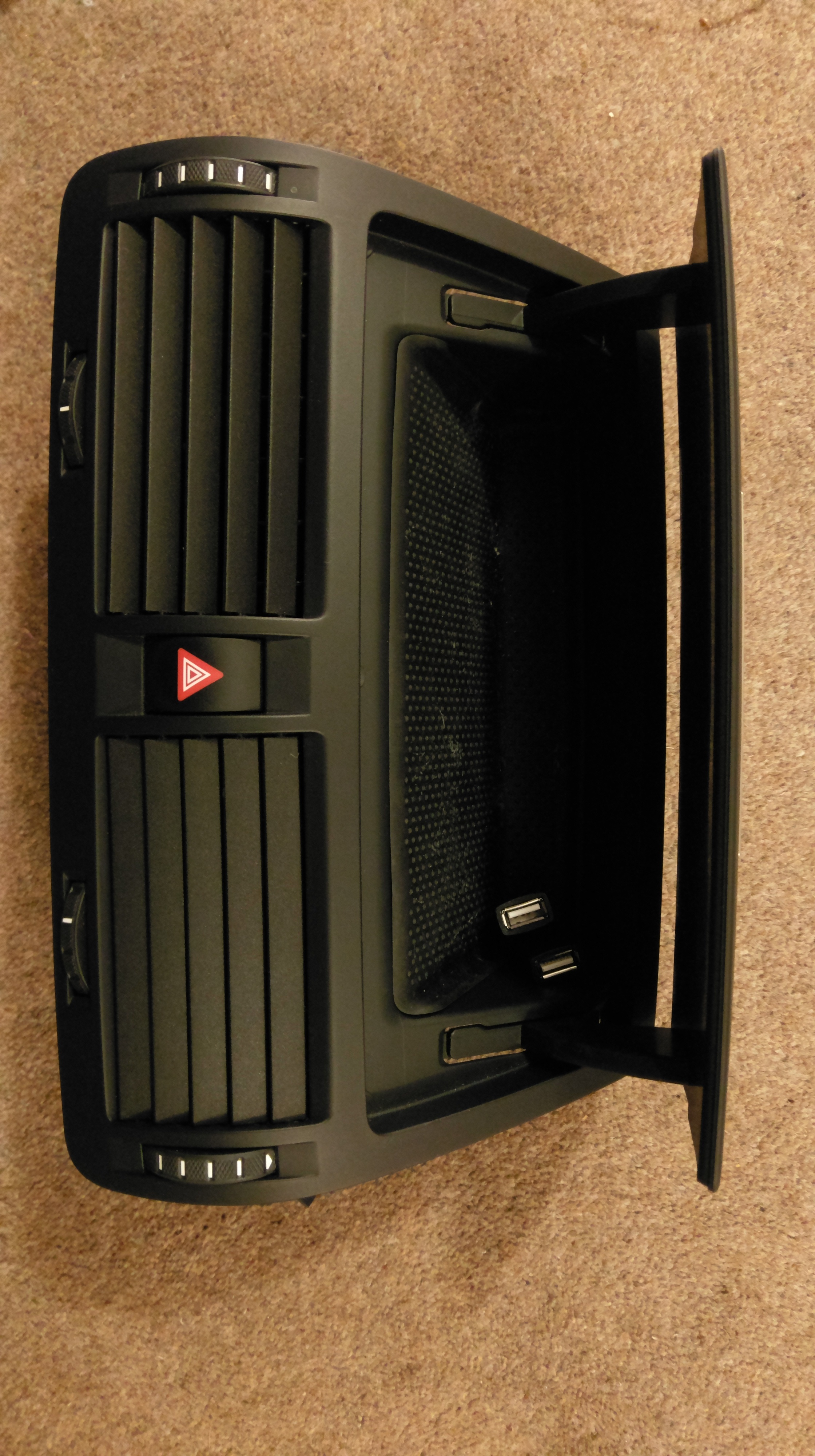

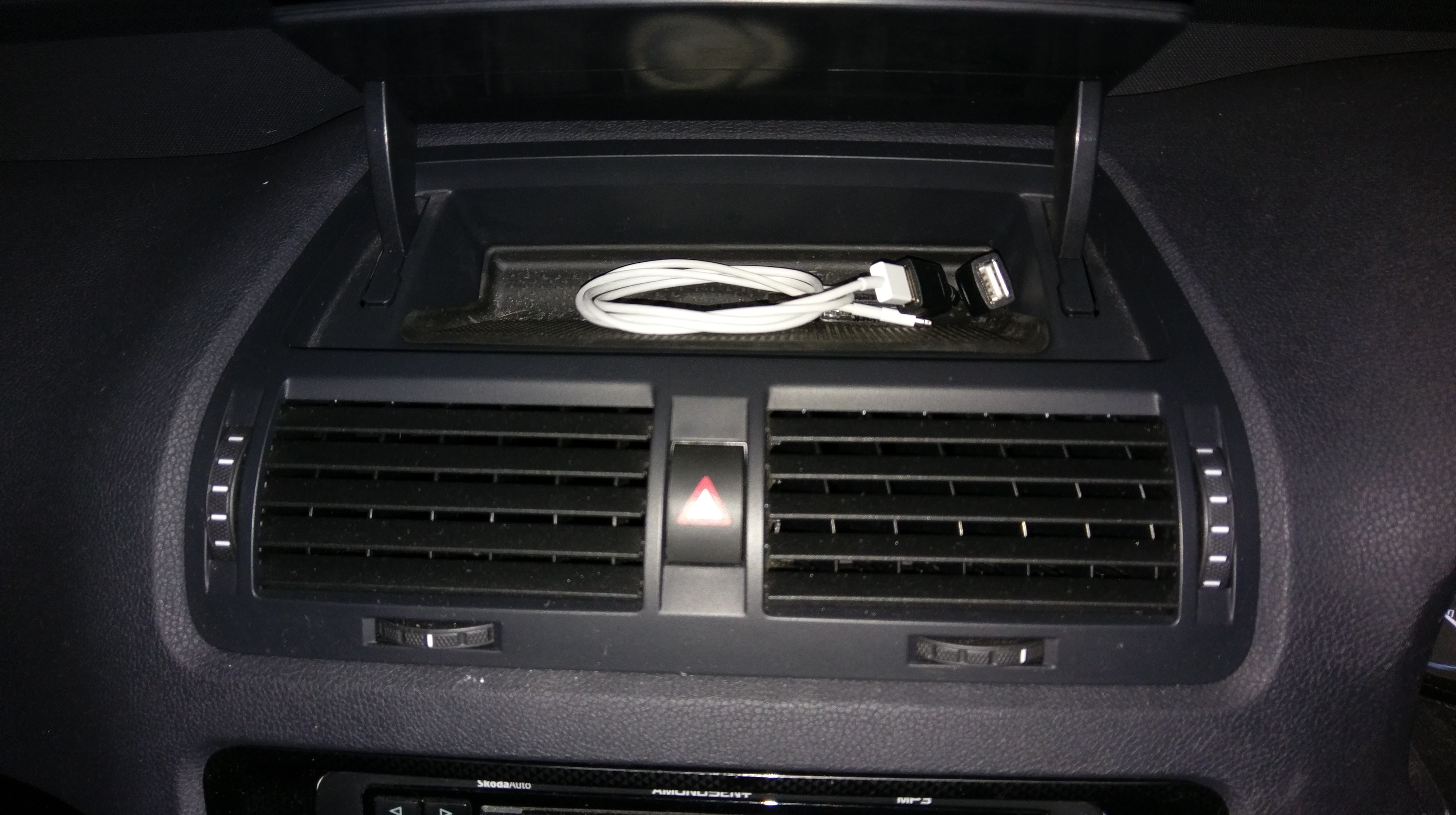

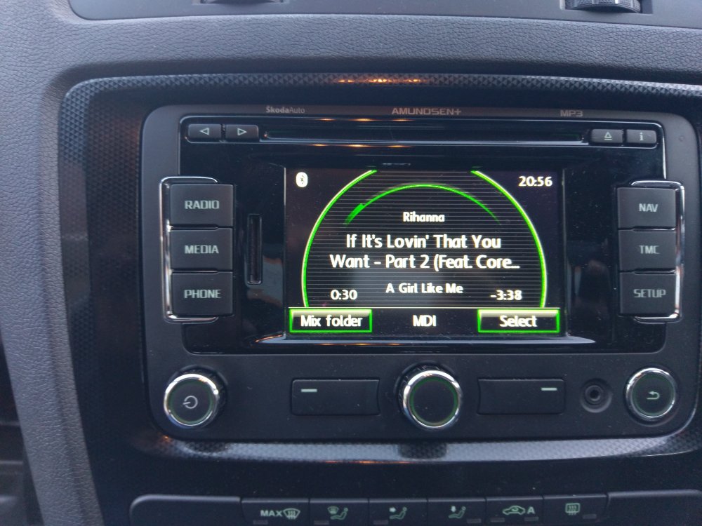

Did this the other day before updating the maps on Amundsen. I wanted a faster charge solution and was tired of wires tangling near the handbrake. Also it's been quite handy as phone sits in landscape when it's open. Just experimenting to see what's the best flat folding phone mount so that everything stays in the top box. Will update when I get a suitable solution

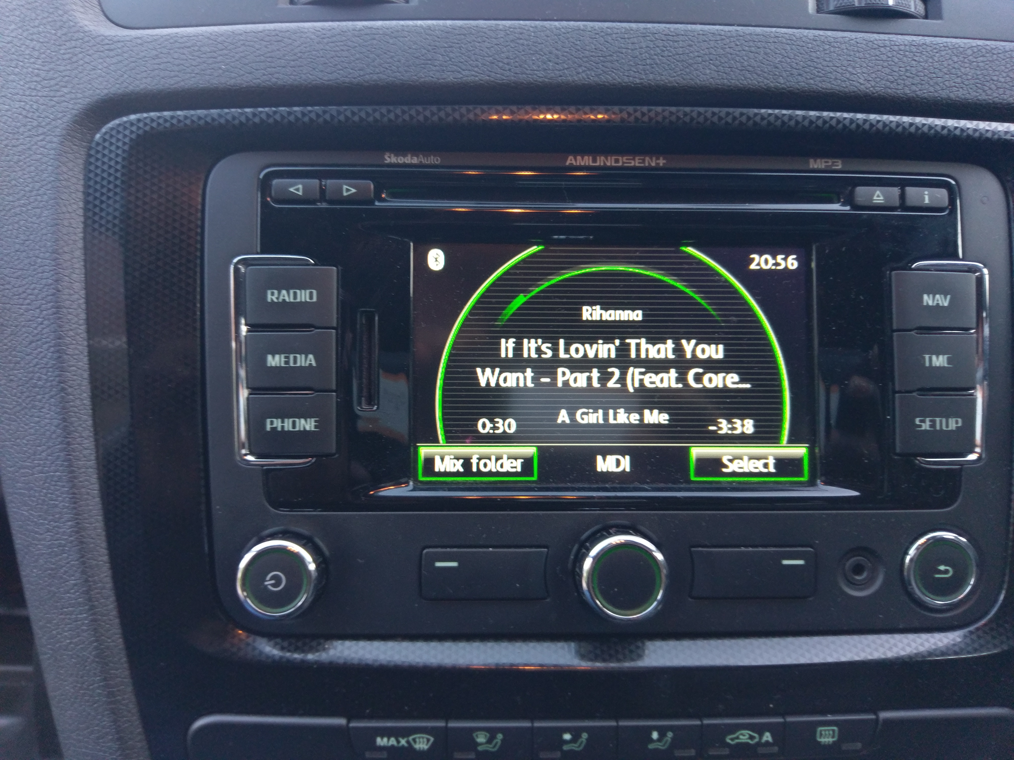

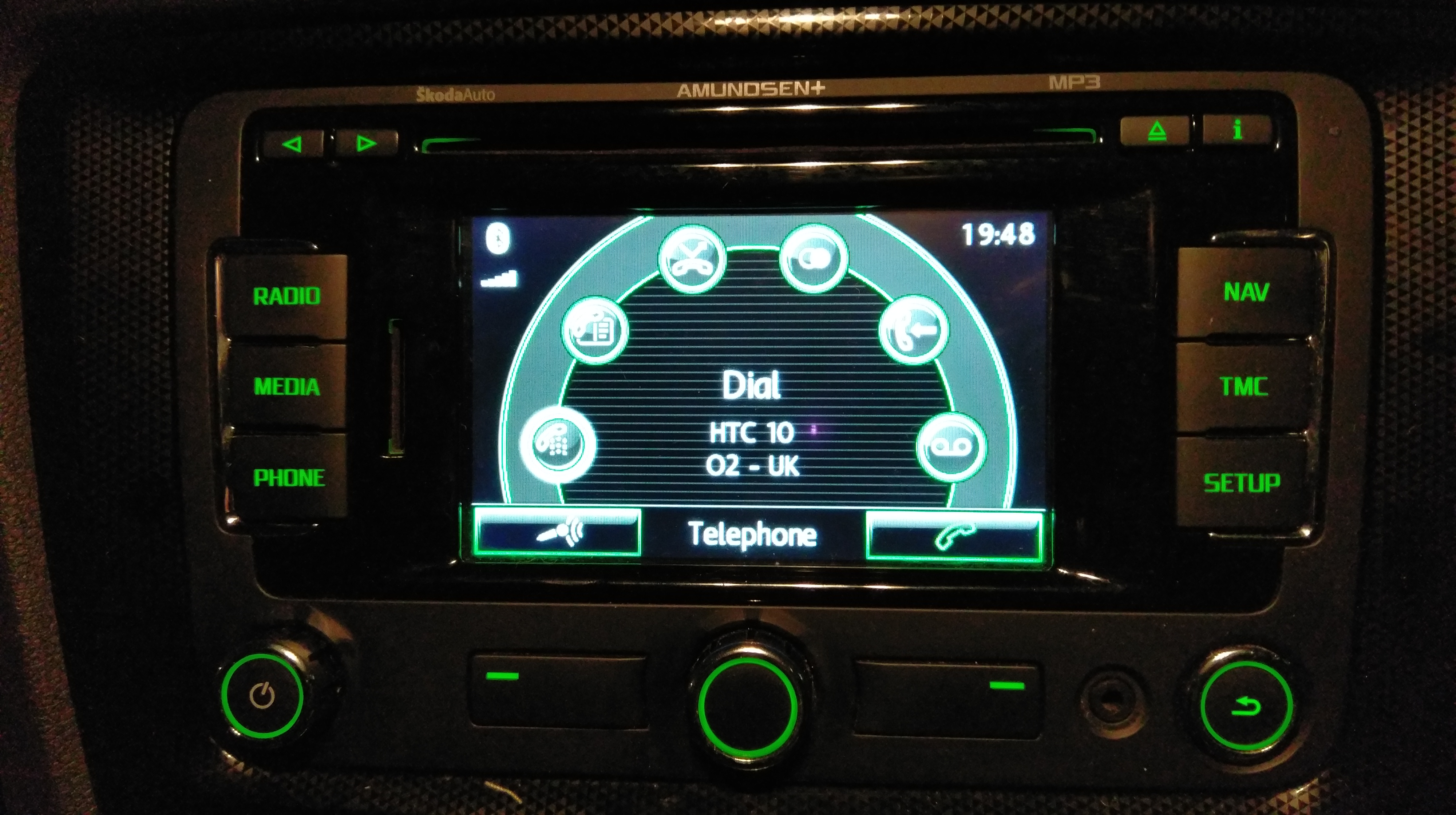

Discovered that the Amundsen+ was capable of voice recognition. Just need MFSW to take full advantage of it.

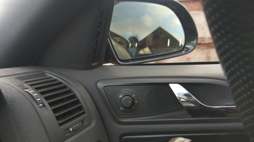

I just added power folding wing mirrors the other day. I was lucky because I only had to change the passenger door controller

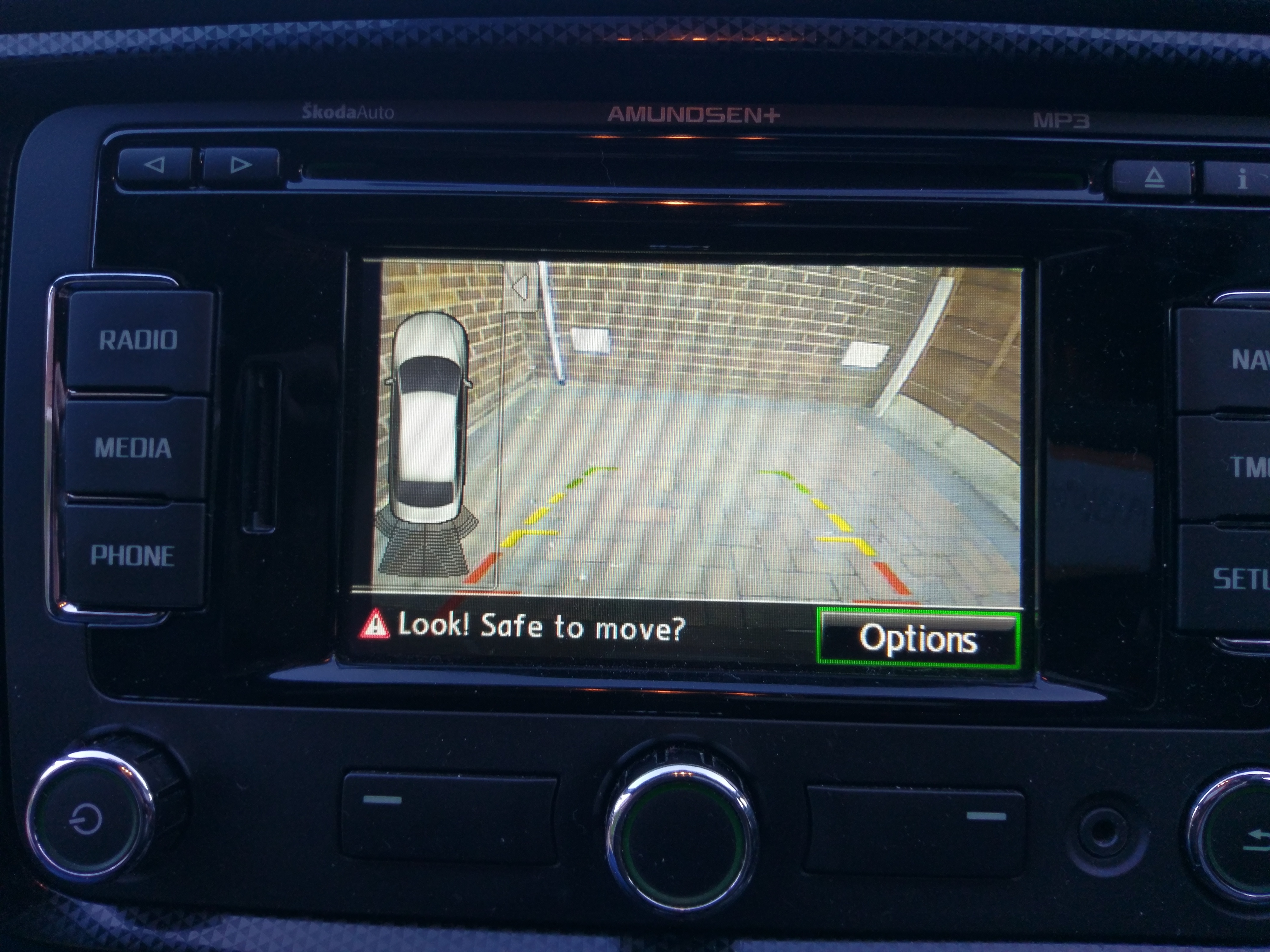

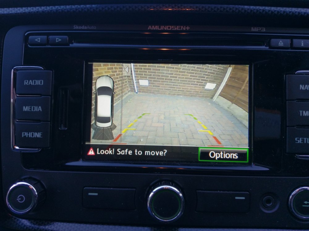

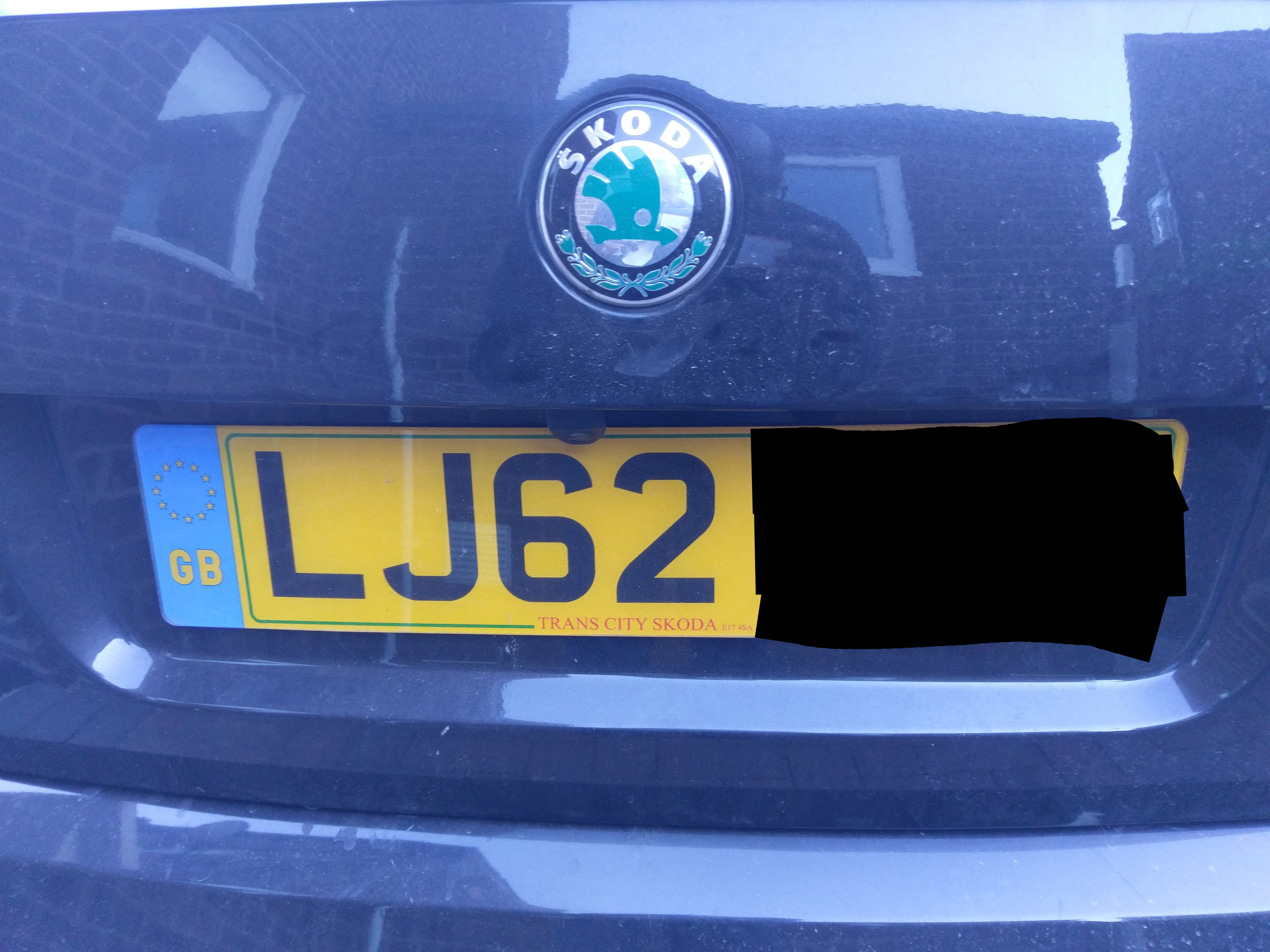

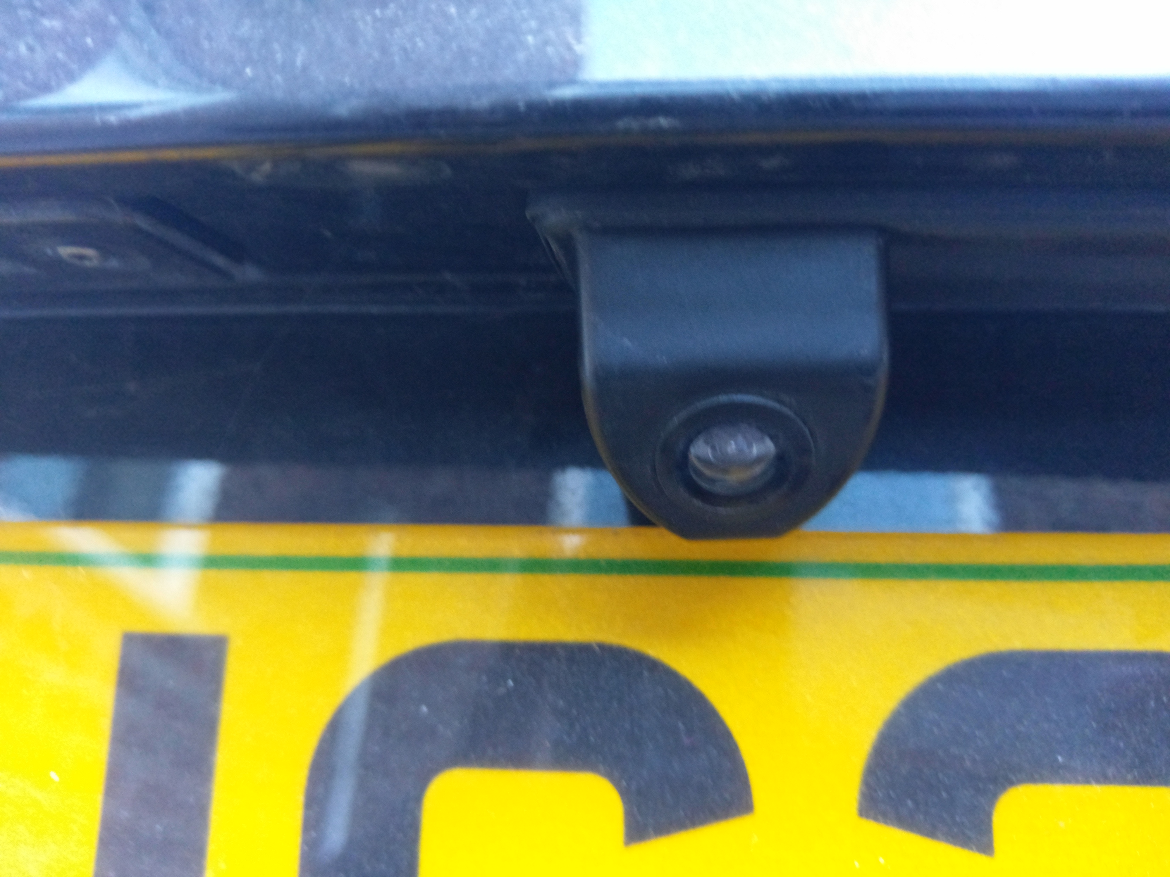

Added this a few weeks ago.
That looks good. The rear view camera is on my list of mods I would like to do on my car. Which one did you use?
I bought one off AliExpress. It was this one http://s.aliexpress.com/nmMzMRFv? If you install the app you get more money off and shipping was fast around 10 days.
It's pretty good. Night vision works well and I'm not so daunted about driving at night with blacked out windows (Standard on the car).
It's a pain to get the wiring through but I have some tips. Patience is a must!

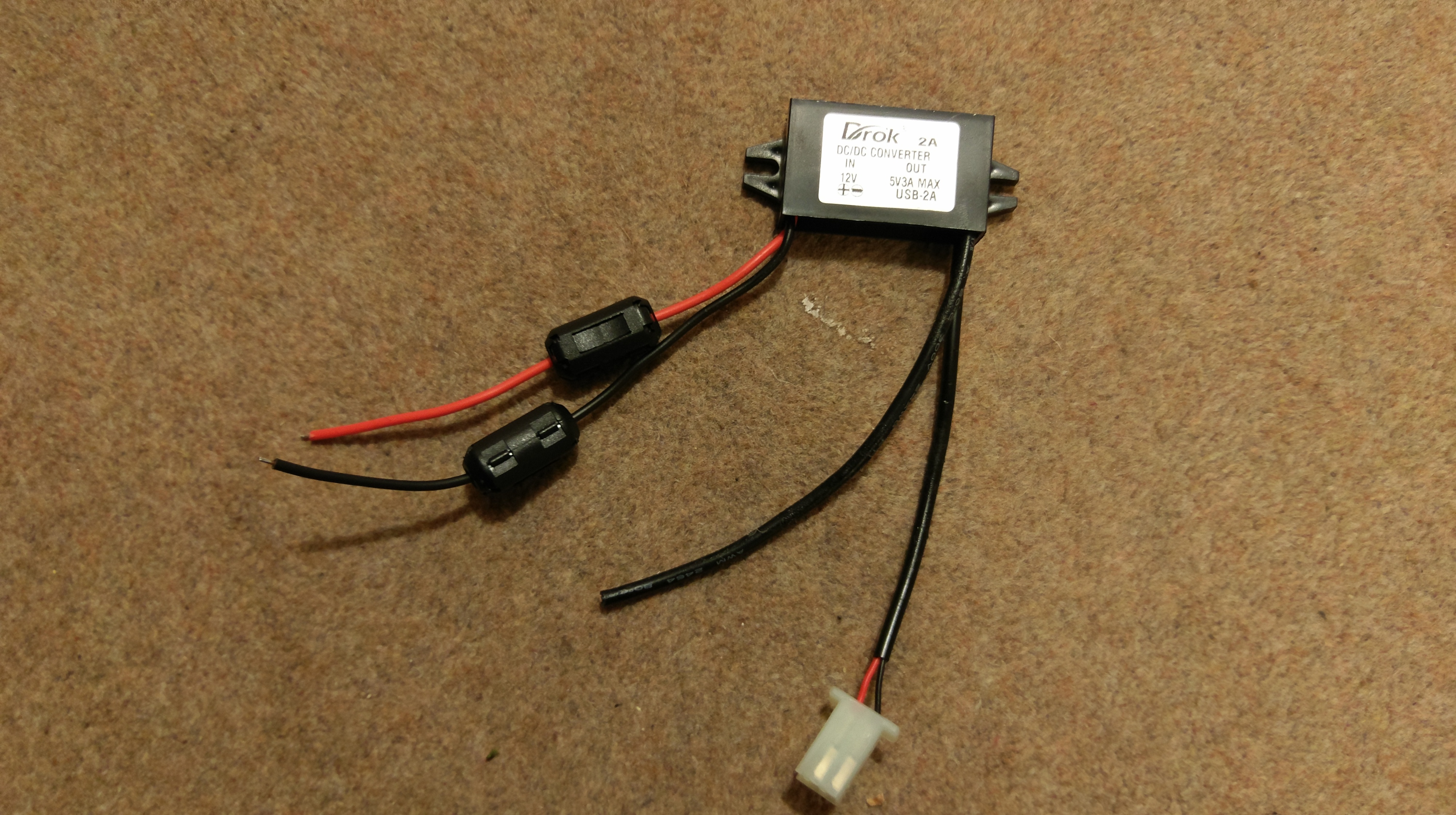

When I fitted mine I used a fused relay and I got some interference from the power so I used a rectifier.

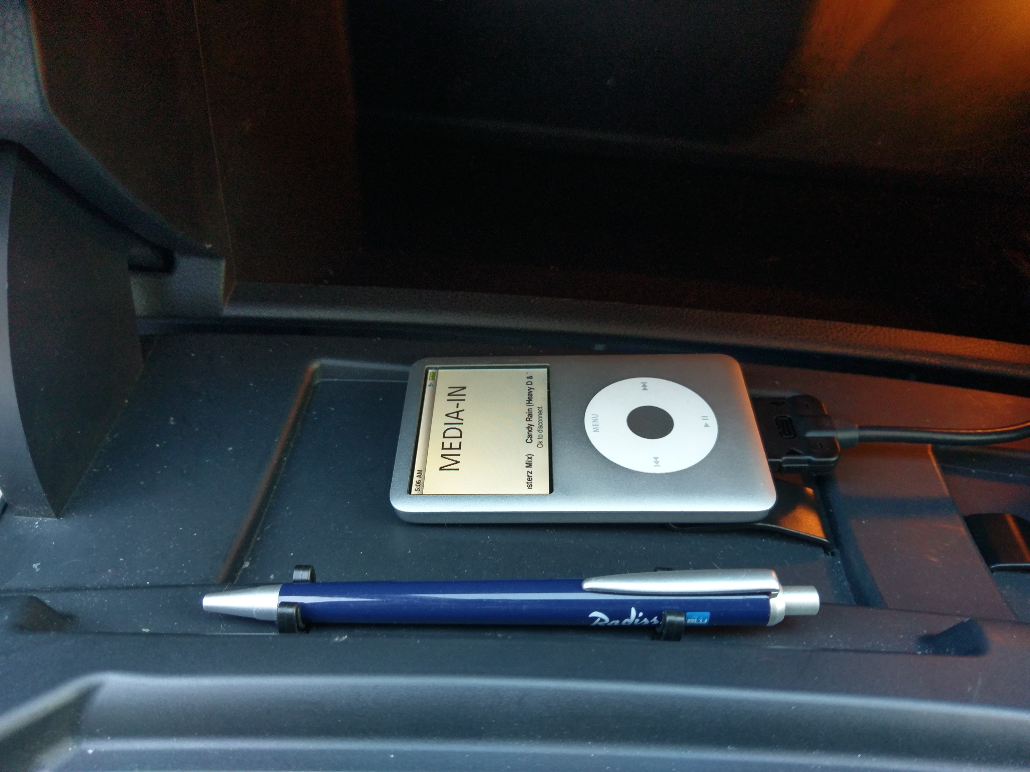

Also put in MDI. It was easy getting the glove box out but putting it back in was a pig especially trying to fit it into its clips.
