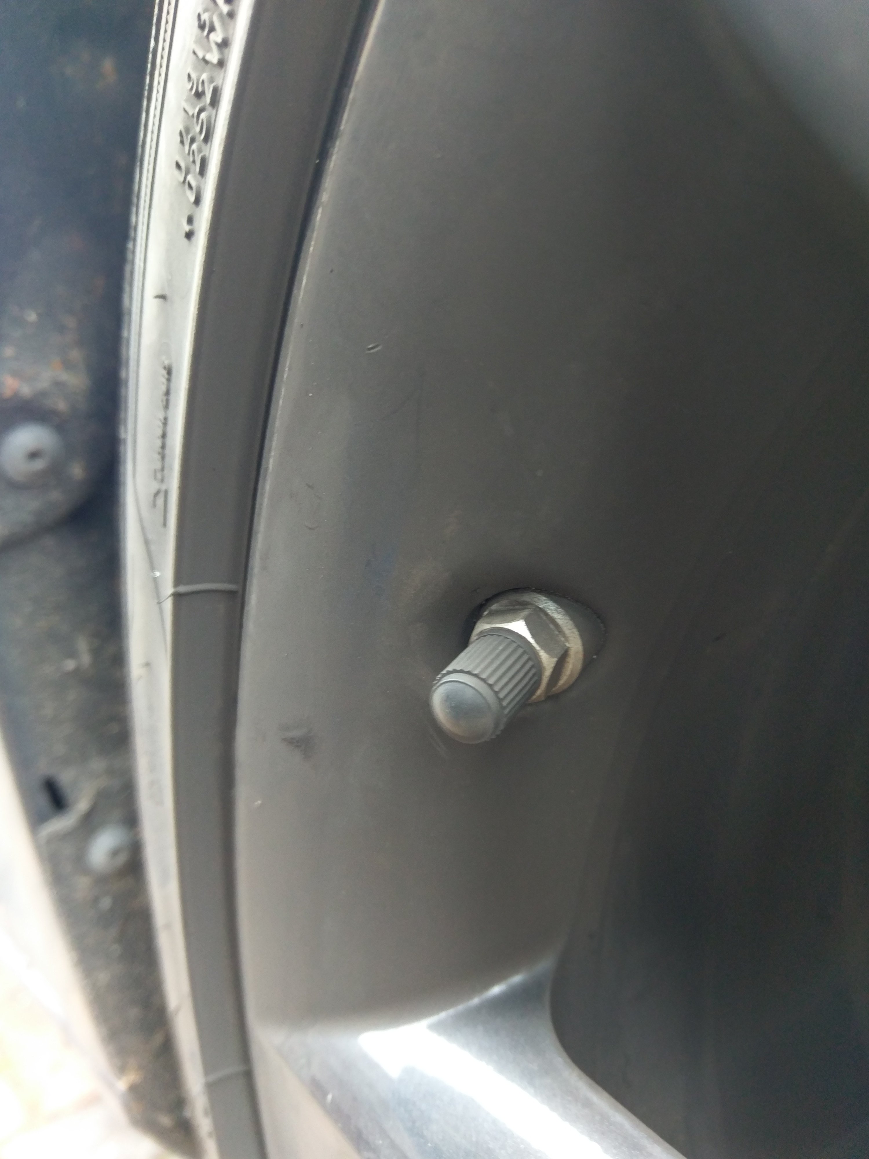

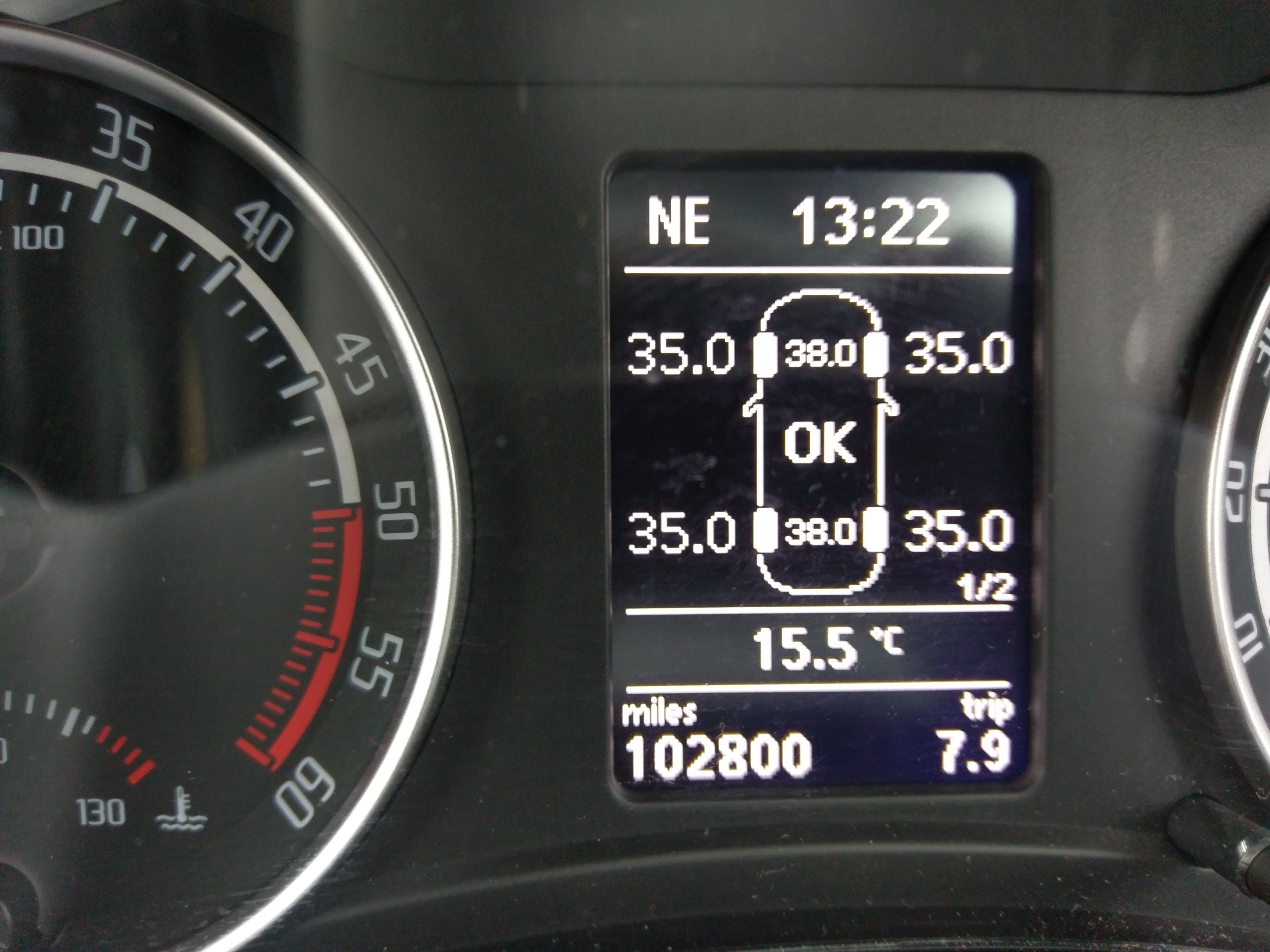

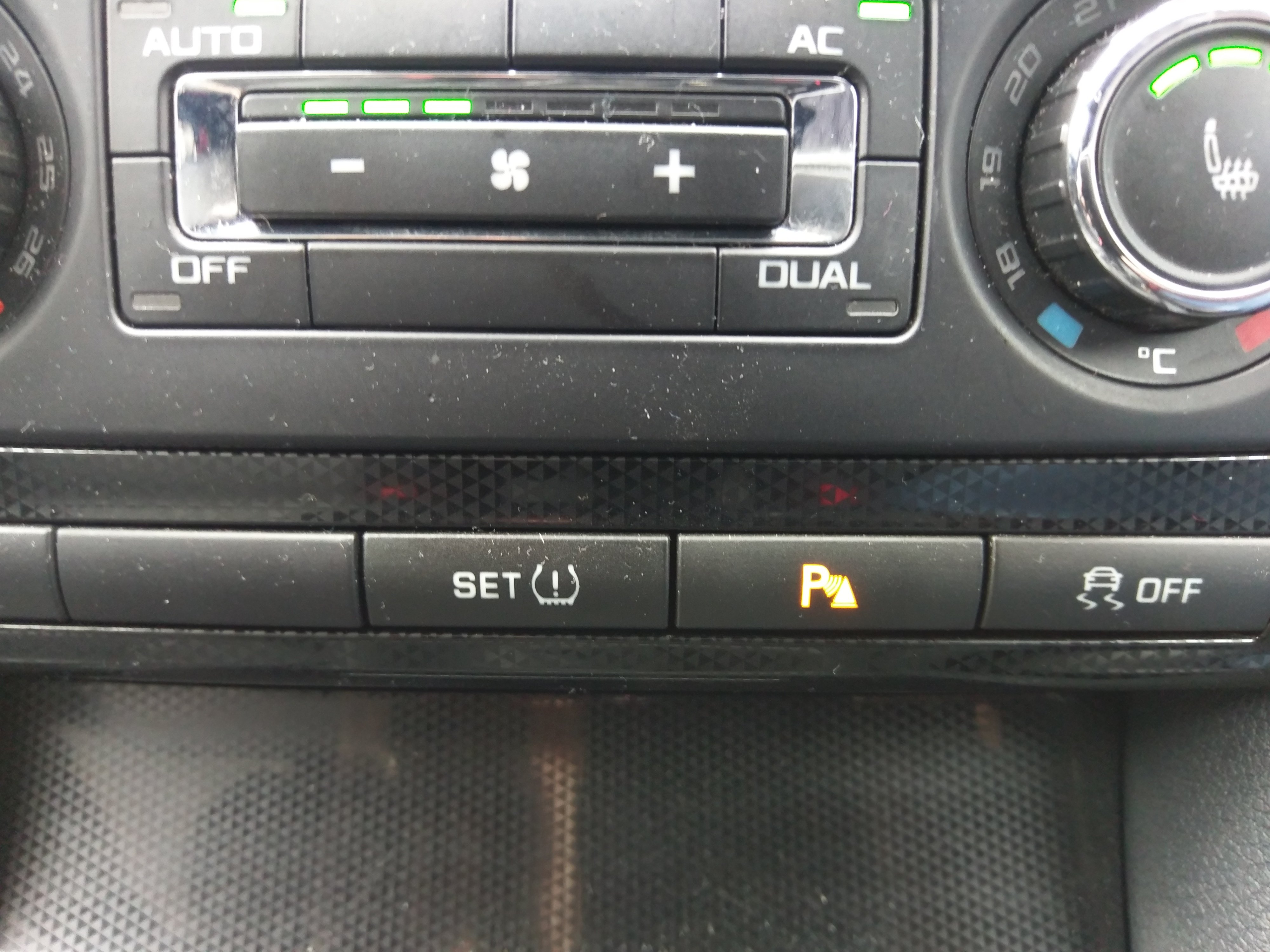

Added full TPMS. Got custom profile on there thanks to @langers2k. The correct TPMS unit is the hardest to find. Cheap sensors can be had via programmable Autel MX-sensors

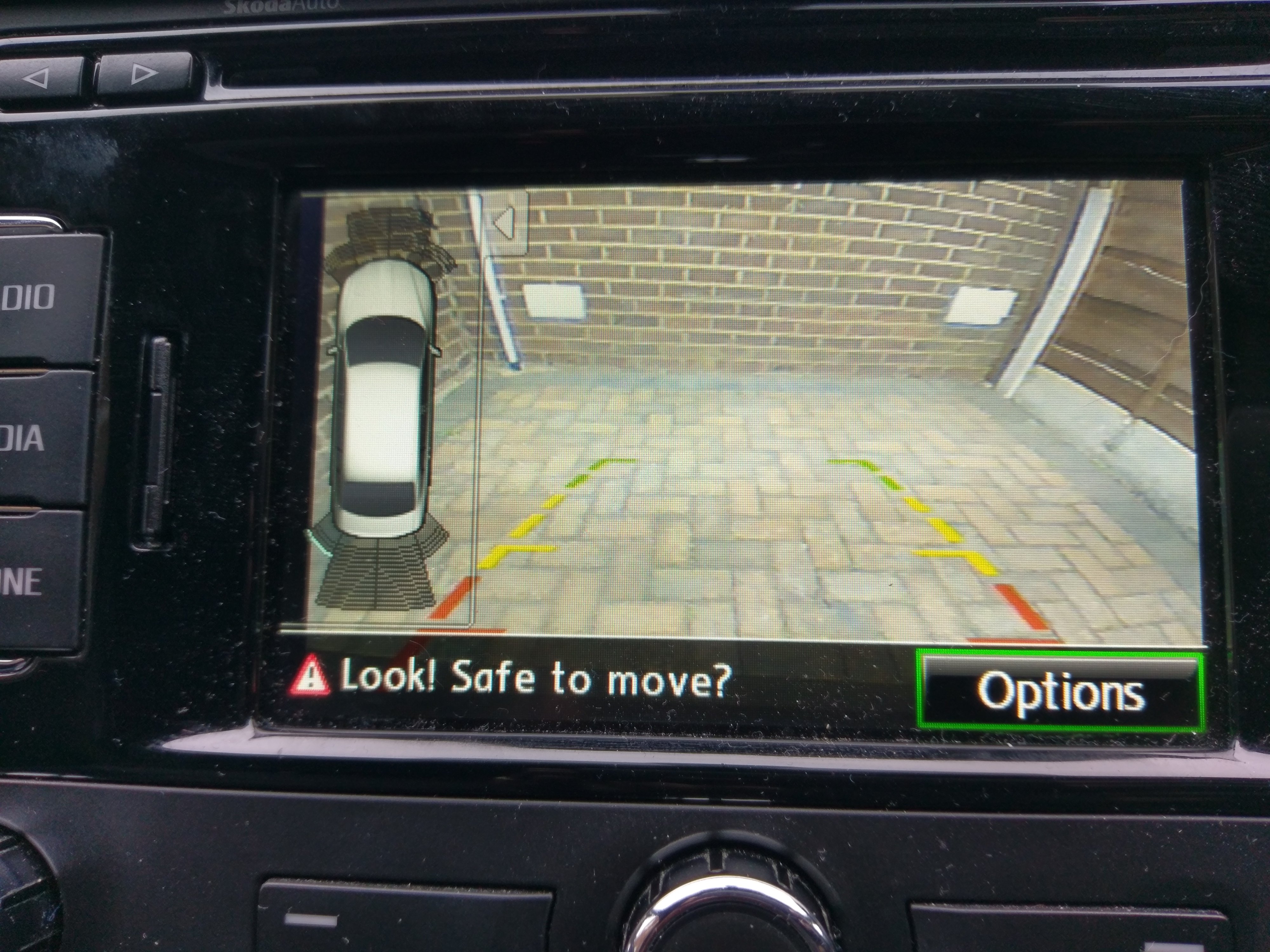

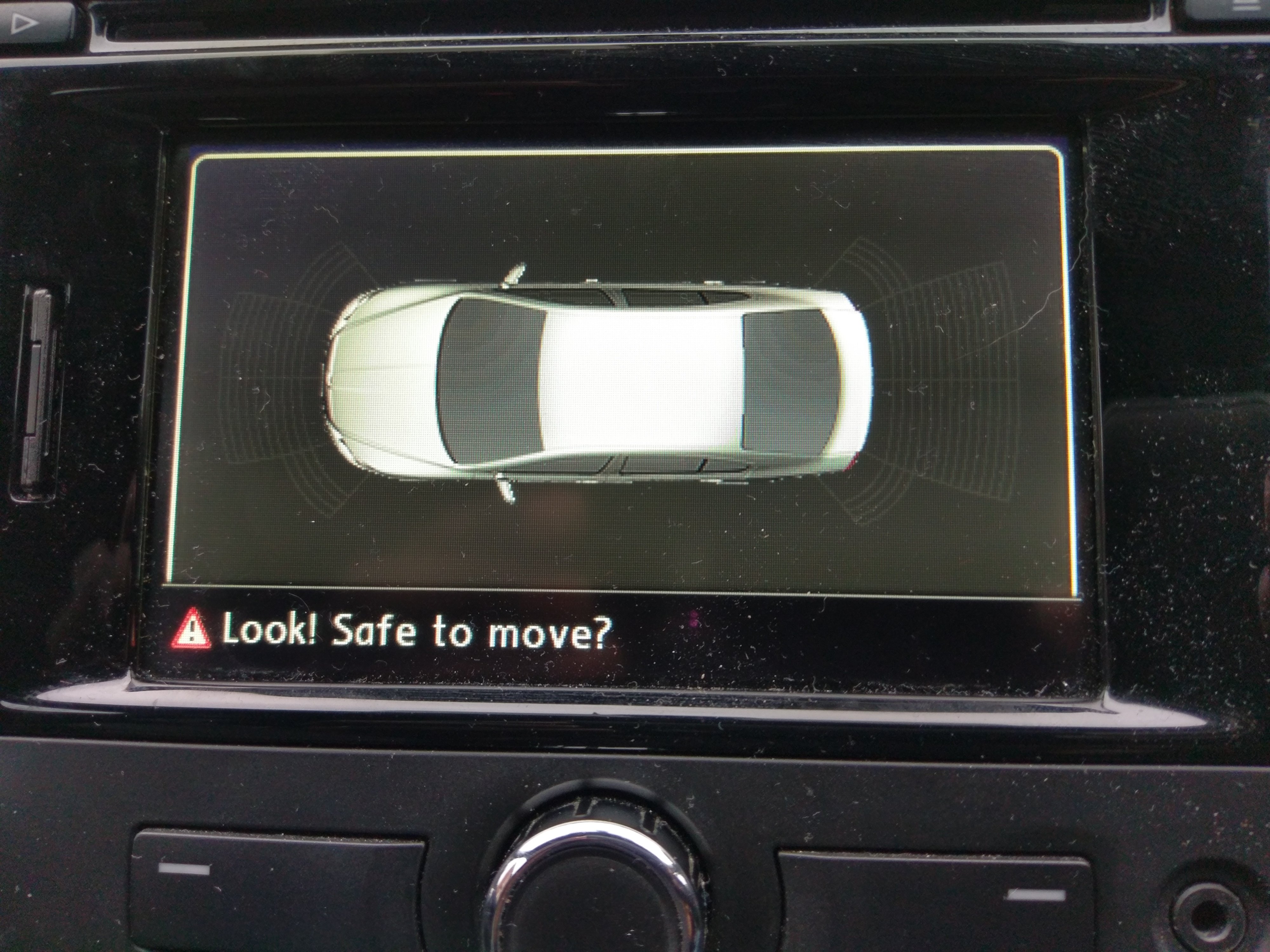

Added front parking sensors
Nice retrofits was taking the bumper off difficult to fit the front sensors?
No the only pains were the 3 rivets under the bumper. You need to pull the top off first and be gentle then it'll come out easily. The rest are straight forward just screws. It's better done as a 2 man job but can be done with one person. I chickened out and used a cutter for sensors (http://www.sealey.co.uk/PLPageBuilder.asp?gotonode=ViewProduct&method=mViewProduct&productid=20339&productdescription=Parking aid cutter&productcode=&category=0&catgroup=&catmicrogroup=&analysiscode=&requiredresults=16)

how do the pressure sensors in the valves feed the data to the maxidot?
