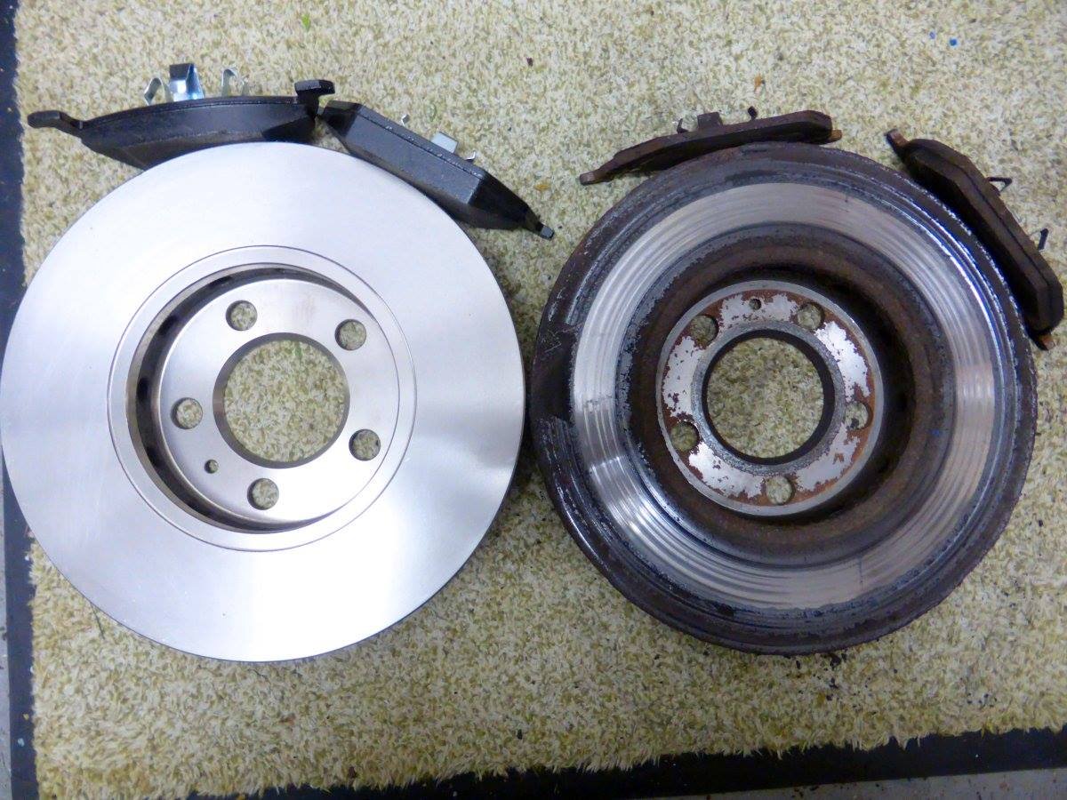

I wonder if the calliper slides are sticking/freezing? Never had to work on them - take it they use slides?
Bill :)
They do stick and it's a common problem
This is when I changed the discs and pads on my Fabia. they looked OK from the outside.
