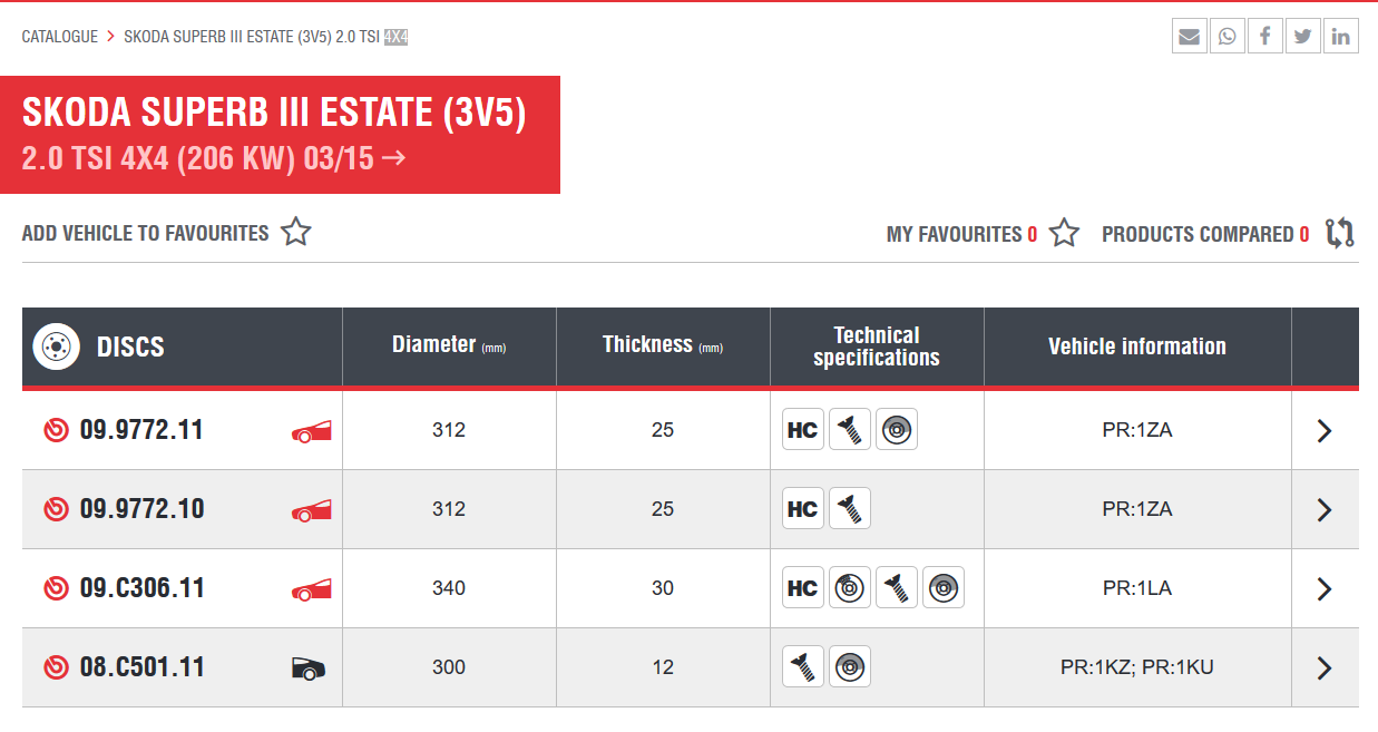

As per title really - anyone have any idea what diameter the front and rear disks on a Sportline 280 Combi are? and are both front and rear vented? I know its a bit of an odd question being as I don't even have mine yet (so hopefully won't need discs for a while!) but I want to know mainly from curiosity :)
According to Brembo:
Gauging by the thickness I'm fairly certain the front discs are vented, while the rear discs aren't.
Bonus fact: The 3.6 litre V6 Superb Mk II has 345mm discs in the front and 310mm discs in the back.

thanks for the info - now to work out if the sportline has 312 or 340 up front....
I'm 99,99% sure it will be 340. Why don't you call your local Skoda?

I'm pretty sure that both the front and rear discs on the 280 are ventilated.
yep - 340's and you can also (i believe) fit clubsport S discs to the front for extra awesomeness. lots of folks popping them on their Golf Rs

Yep 340's.  Everything over 150ps but below 220ps get's 312's upfront is my understanding.
280 hp has 340 front and 310 rear, both vented
220 hp has 312 front vented and 300 rear solid
