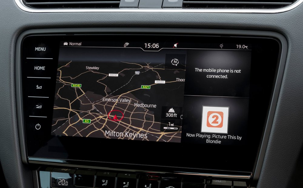

I have a 2016 version of Amundsen MIB2 installed in my 2016 Octavia vRS. Reasonably happy, but the new facelift Columbus split-screen displays look significantly better and would be a great start for the planned project.
I was wondering if anyone successfully managed to retrofit a new 2017 Octavia facelift ICE Columbus system (new big widescreen display with buttons on one side only - see pic) on similar version of an older car (2013 onwards). Is it possible? What is the cost? What are the pitfalls? Does it connect well with other car systems and Maxi Dot?
I've asked a Skoda Dealer of course - they're saying absolutely not, factory only option.
I've looked at some retrofit specialists, but no one is offering the latest 2017 version (MIB3?), usually only 2016 Columbus MIB2.
Any ideas or experience?
Many thanks
the phrase 'an arm and a leg' spring to mind. The retrofits specialists charge £1800 for the 2016 version so this would be more.
there are alot of really good android octa-core chinese offerings with 10" screens that do a lot more and look almost as good. there are comprehensive retrofit videos on ytube as well.
if your selling your amundsen id be happy to buy it :)
Edited by JohnnyType2
Its not impossible, but would be expensive, dash and glovebox unit would need changing.
Probably cheaper to lease a new one with that set up in it....
yes it will be expensive, and yes it will be much work, and in the end you had to use a dealer because of the component protection - that may be is impossible because your car is not designet for this MIB
