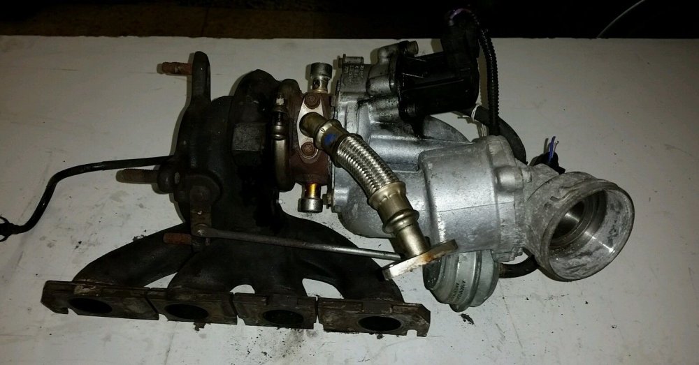

See picture below of an IHI turbo as in your car.  FYI, if you don't know, the cast iron rusty looking section is the manifold. The rod connects to  the lever, that is the wastegate lever. Edit: they are sold by VAG as complete turbo charger unit as all the bit work together and require set up.

This is on ebay BUT it is risky, it maybe faulty you never know. It says working and 58k miles. Who knows, you buy from pictures!
At £195, the going rate for a remanufacture items seems about £350. then fitting which is probably taking you to £720 they quoted?  Fitting would probably be the same either way.  I'm not sure it would be worth buying second hand at this price  to save £150....and no warranty or come back.

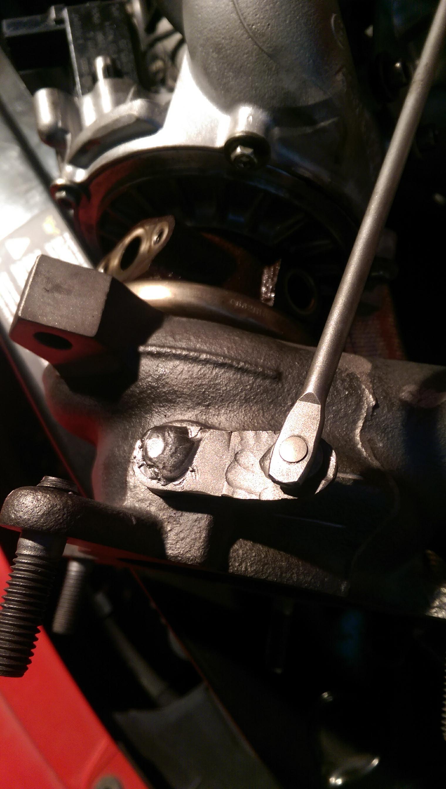

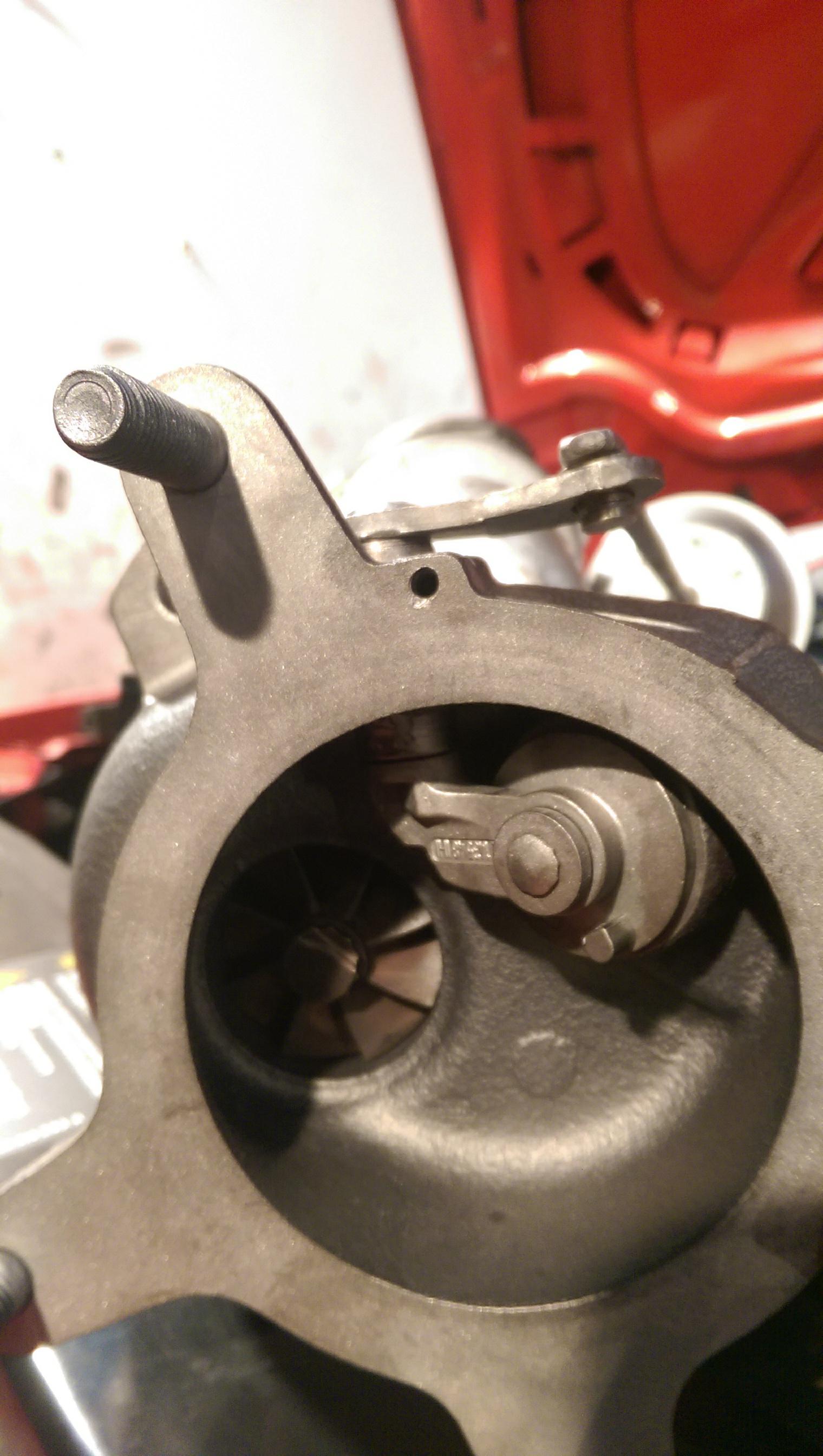

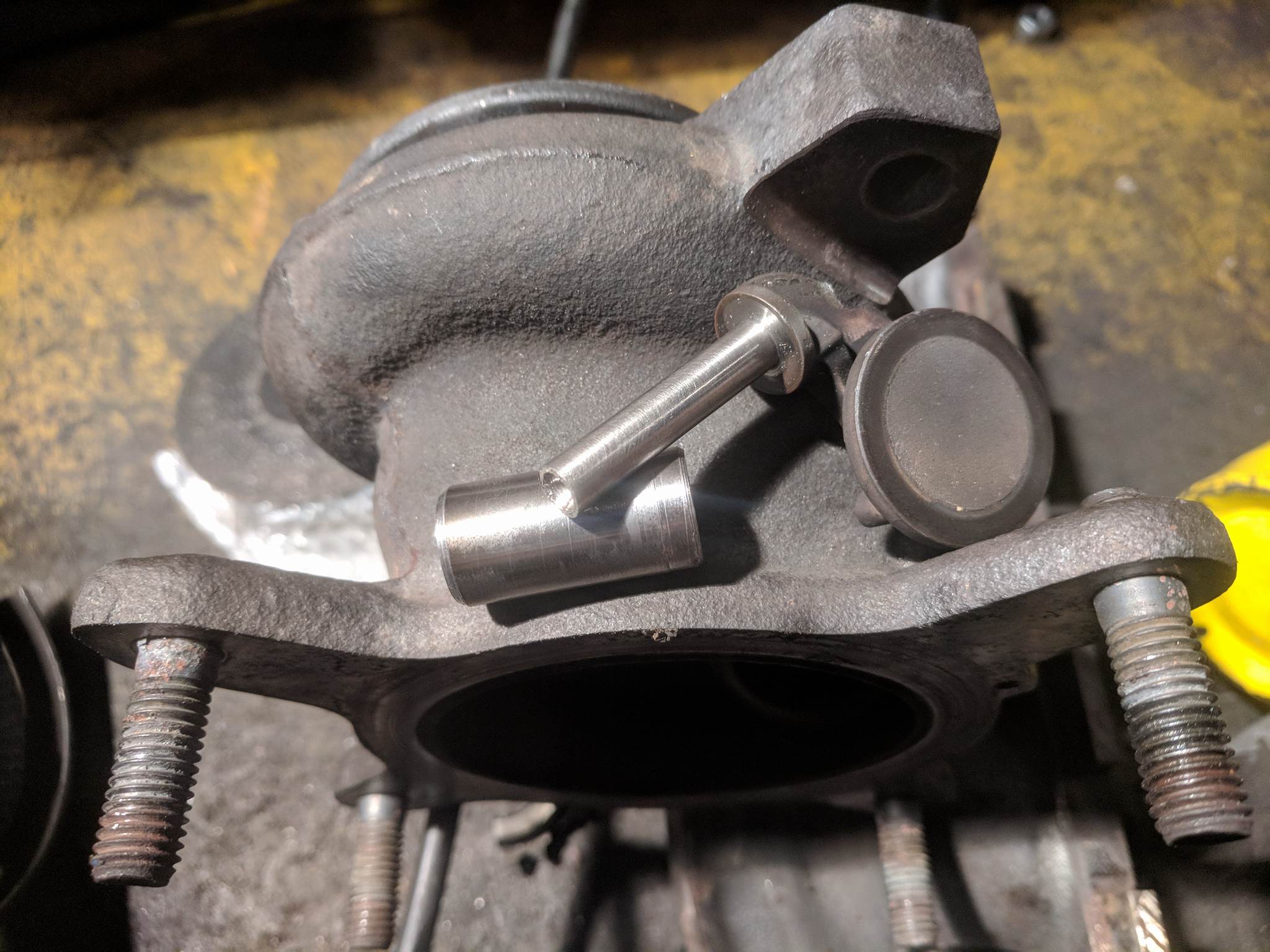

I have some pictures...
Edited by HarleQuinn
Seems like they know what they are doing, From the pictures it looks like the wastegate valve and wastegate lever and bushes are what is at fault. A fairly common problem most garages would replace entire turbo as not experienced with re manufacturing and no separate dealer parts list.
