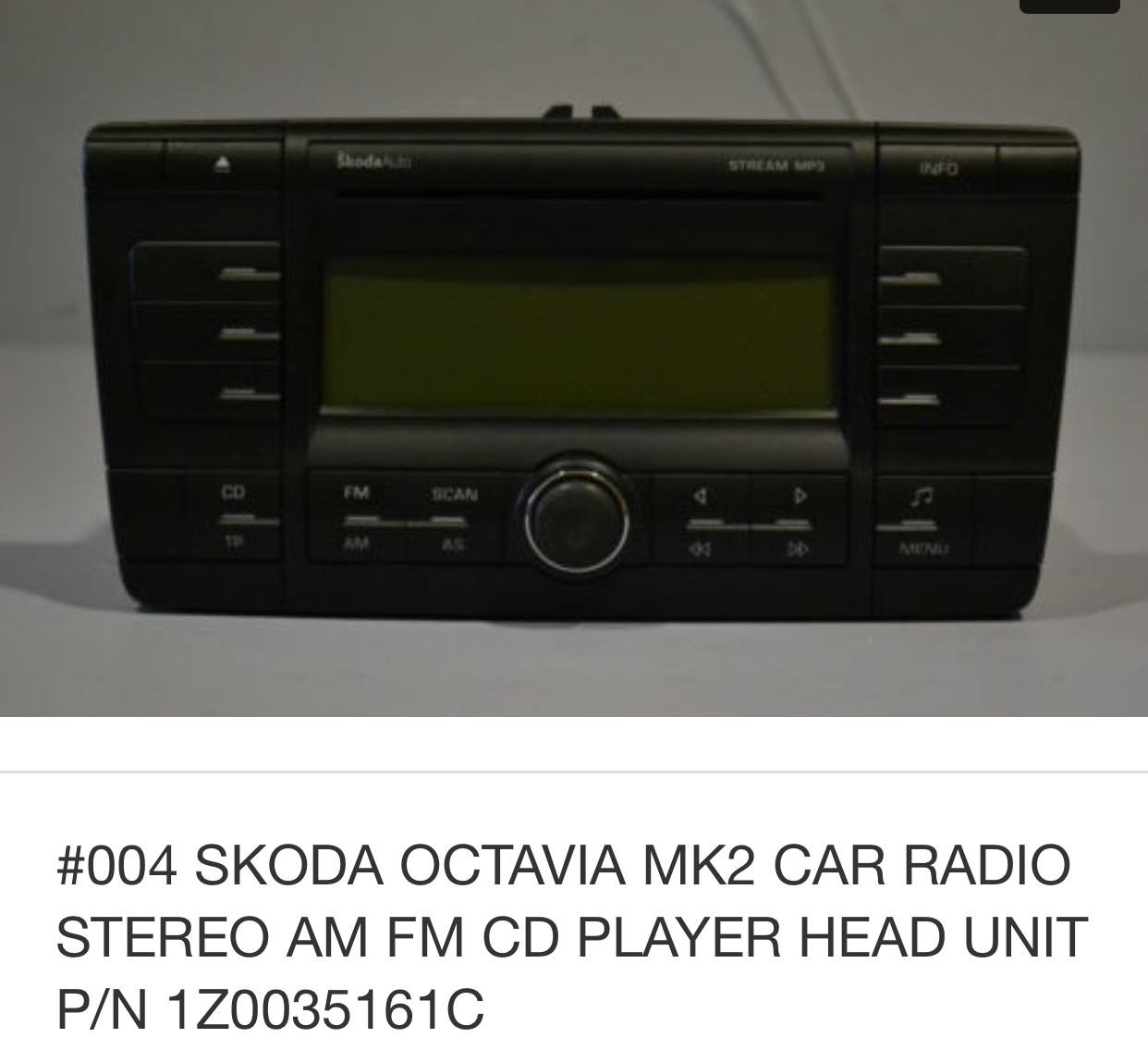

Cant find model number but it’s original stereo that came with car in 2007. I have posted pic. Thanks.
I would suspect your unit is at fault mate.
Not sure if worth having it inspected in a local electronic workshop otherwise just see for a replacement.
With less money you can get a quite good aftermarket solution (not to mention for a touchscreen model)
