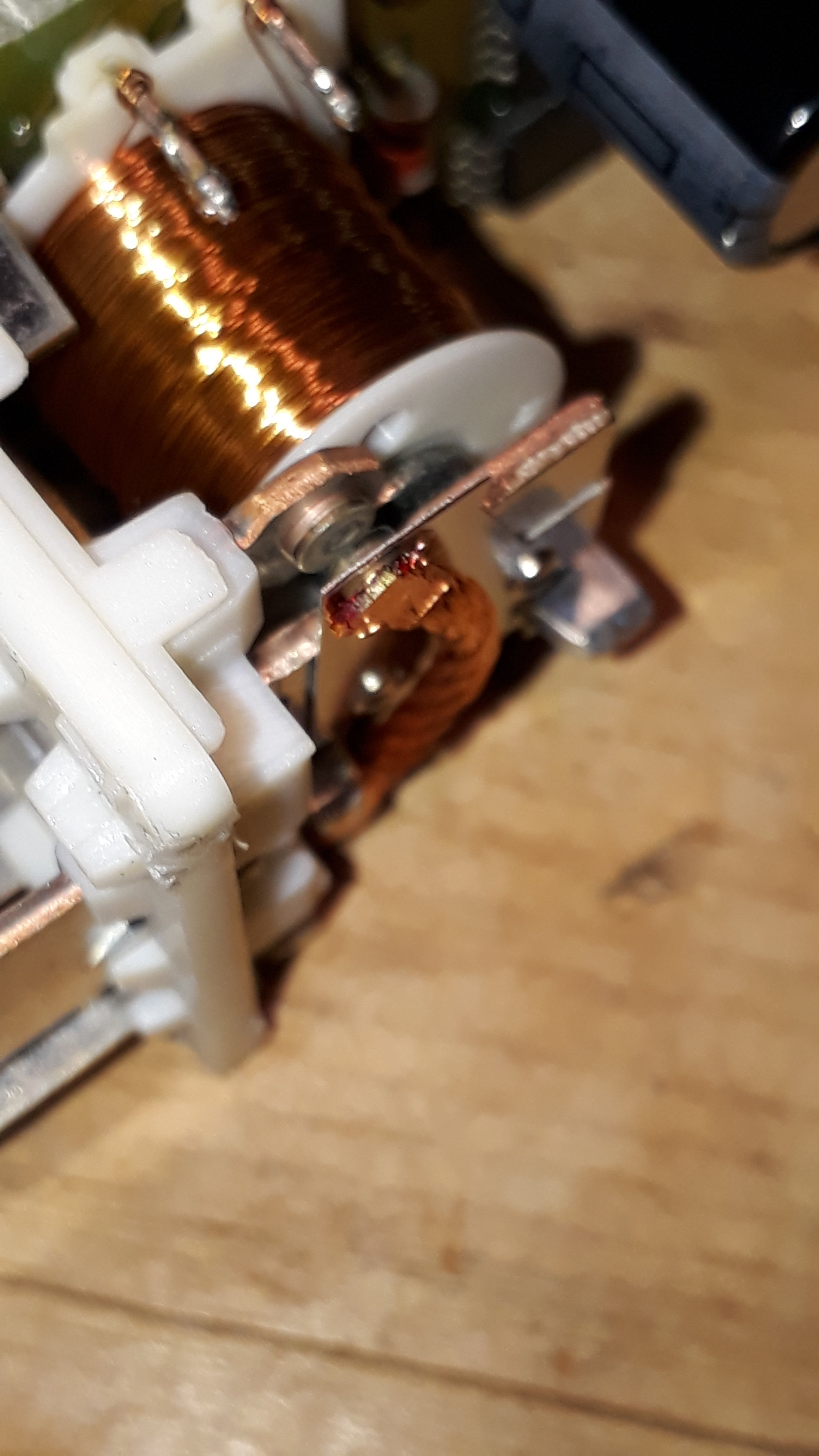

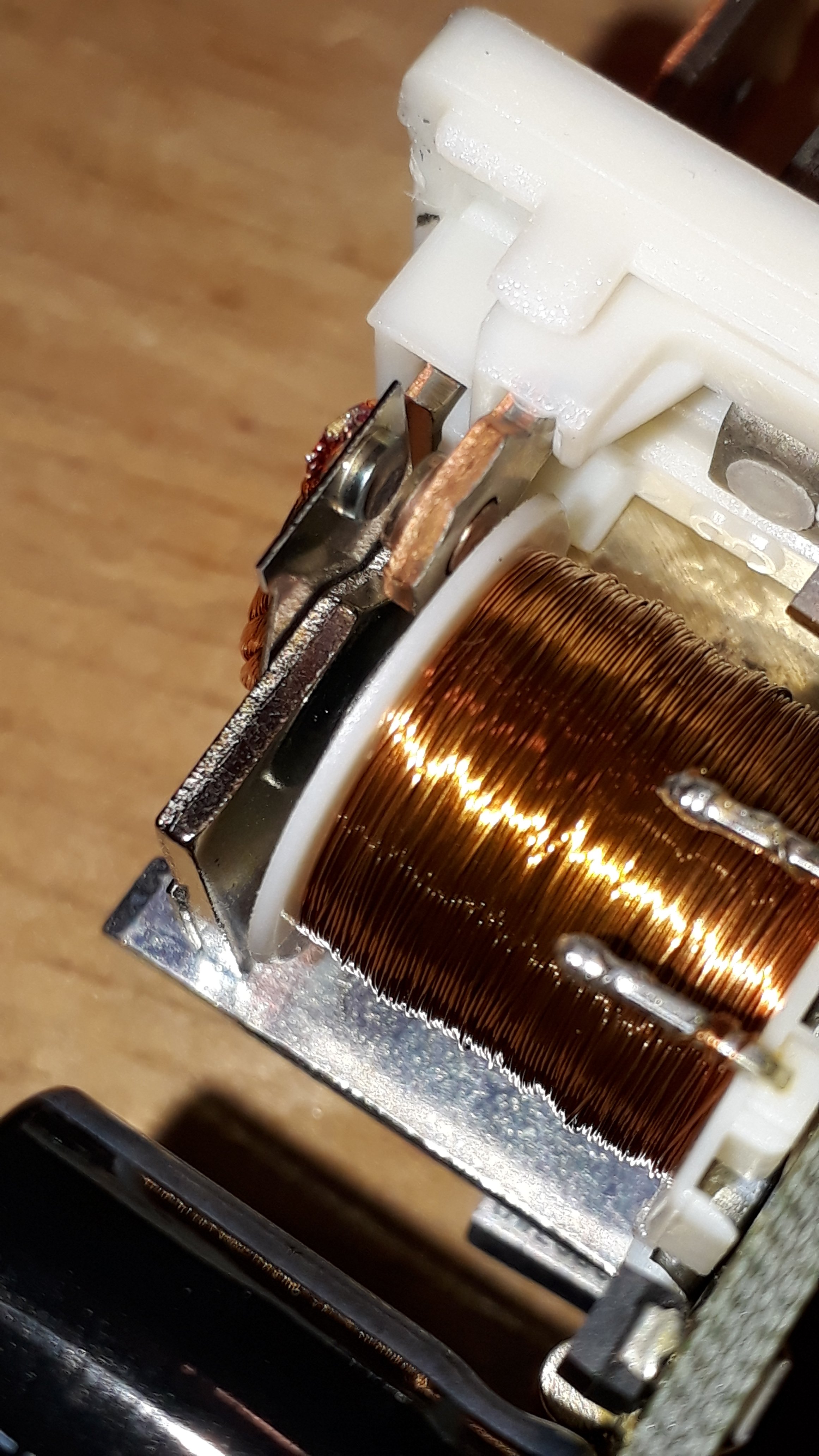

I'm going to say the relay contacts are stuffed lol :biggrin:
