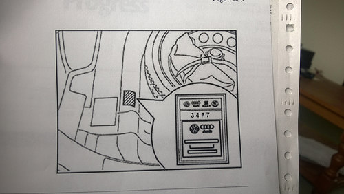

* The World Wide Recall, or Service Campaign, '34F7' had no Filter Changed, only the Synthetic Oil for Mineral,
& in some countries a new MCU, so where is this Filter that needs changing now some 10 years on from the first DQ200's?*
