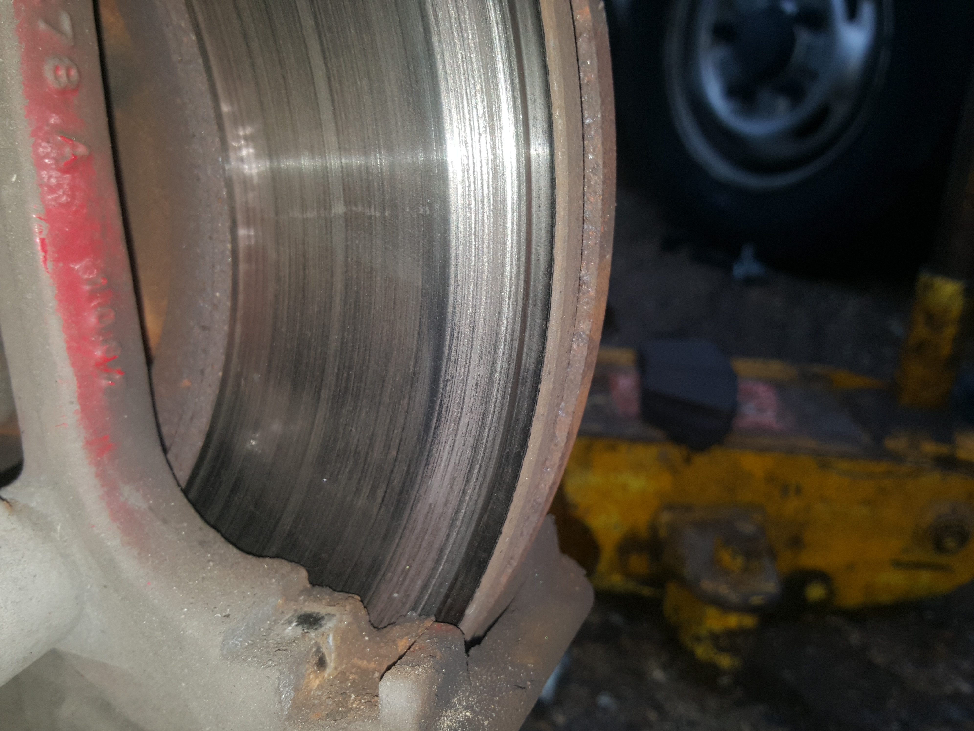

I was a little shocked by the corrosion on the my discs hence posting the photo.  There is nothing caught on my car,  the grinding goes away within a few miles as the discs clean up, but is more noticeable than I would expect. I'm not telling anyone else that their experience is the same.
The thread is about grinding noises from brakes, I offered one possible explanation. If someone else wants to go to their dealer and complain about disc surface corrosion good luck to them, I don't have time for that, but I look forward to any feedback.  Doesn't mean I'm happy about it.

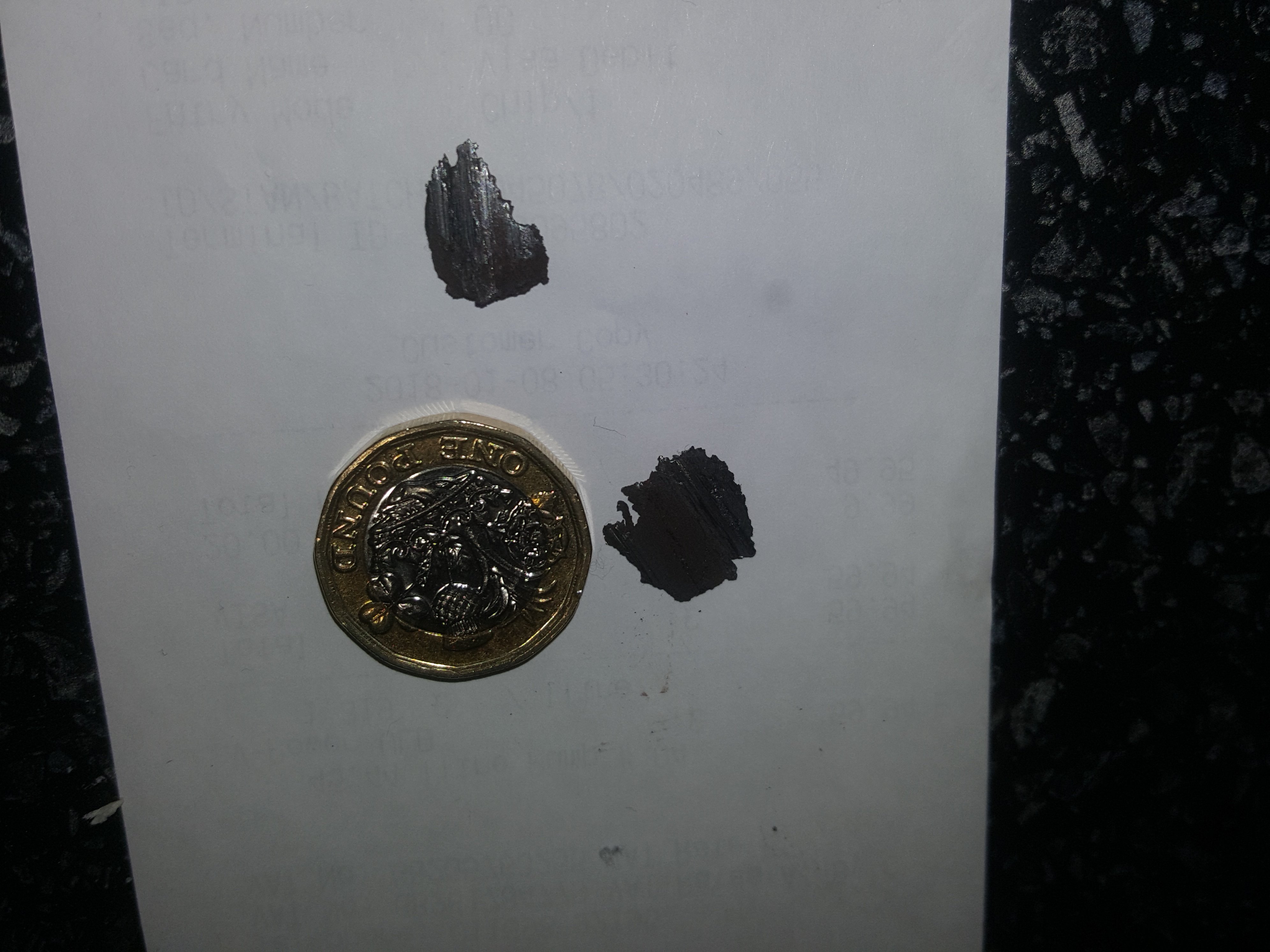

Well my discs/pads haven't cleaned up & the noise continues so, I've had them apart to find largish lumps of metal from the pads have badly scored the inside of the front nearside disc (see photos)
Apparently, there is metal in brake pads nowdays as asbestos has been banned from use. This would seem pretty crap for a car with only 4-1/2k miles on the clock but, being OEM do I really want another set albeit, FOC under warranty.
Don't hang about they are only covered for six months unless I'm much mistaken.
