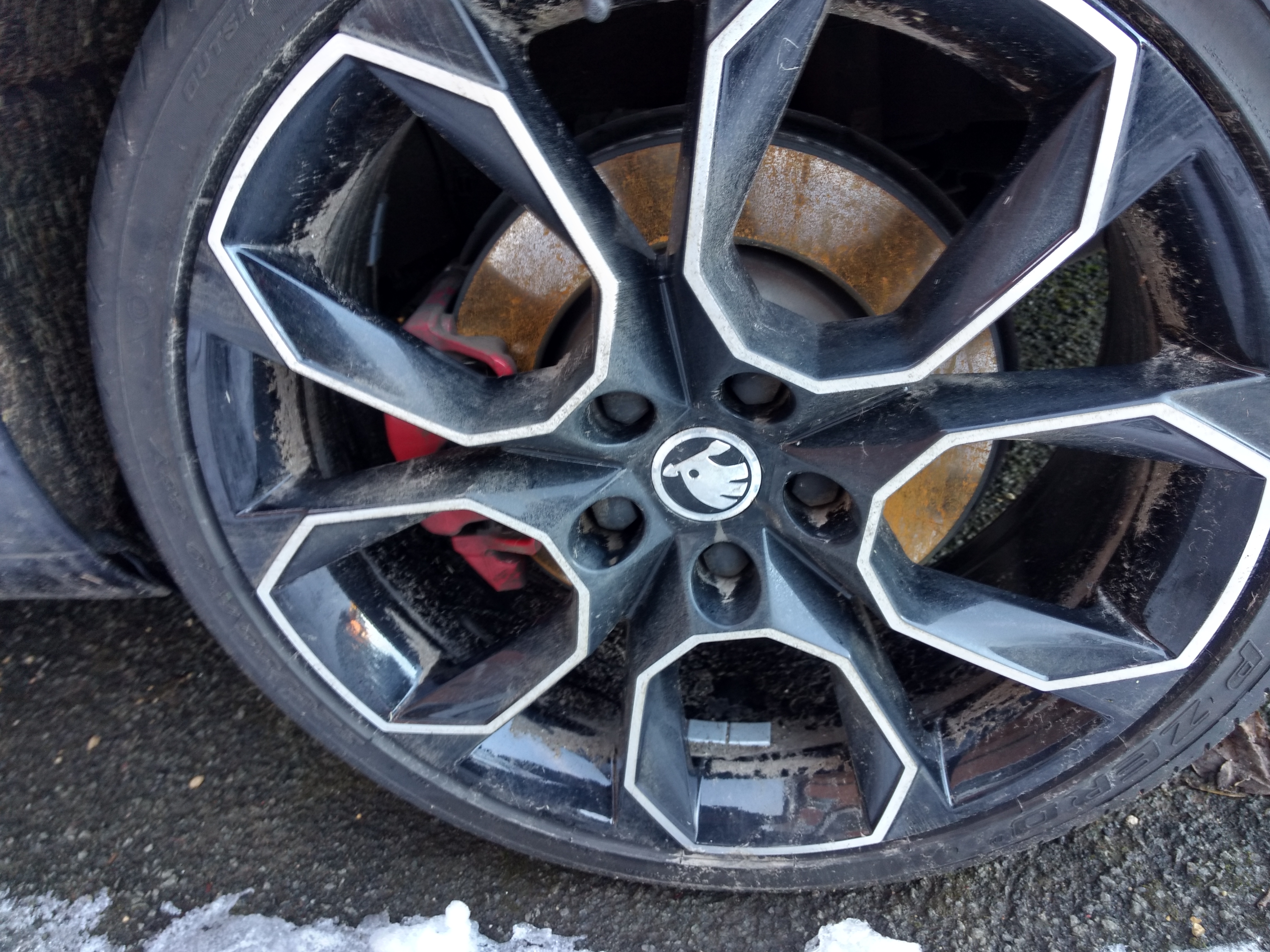

Film of rust on the brake discs.
After 36 hours of being parked up.IMG_20171228_103249332_HDR.thumb.jpg.a243dfe6b564fa636205f8dfda5b099b.jpg
Those poor wheels need a good clean! :sweat:
Edited by Gumby
Put it through the car wash on the 20th December not due another wash until January.
