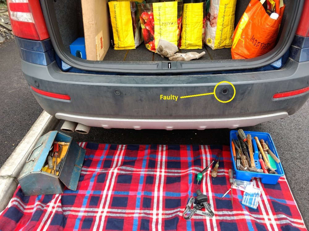

Identify the faulty sensor(s):  In operation, the sensors emit a VERY QUIET rapid ticking noise.  To hear it, find a quiet place away from traffic, and switch off the engine.  Switch on the ignition, and engage reverse gear.  Kneel down by the back bumper and put your best ear hard up against a sensor.  Even when you press your ear hard against the sensor it may be a few seconds before you hear the ticking; it is VERY QUIET.  Repeat, until you find the one (or more) that is not ticking.  That is the faulty one.  In my case, it was the inner right (photo).  Switch off the ignition, and put the keys in your pocket to make sure nobody starts the engine while you are underneath the car.

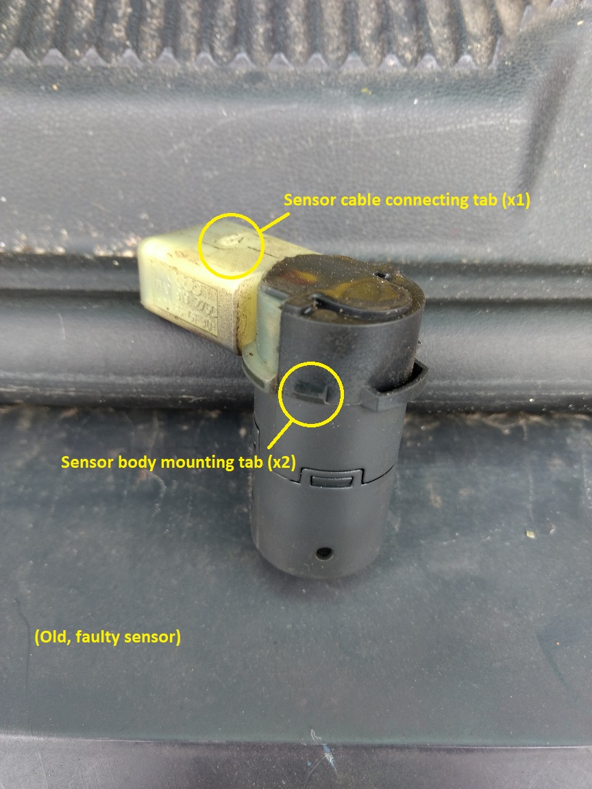

Look closely at the part when you get it: you will see that there is one raised tab on the cable connector socket, which clicks onto the fitting on the end of the cable; and there are two raised tabs on either side of the main body of the sensor, which click onto the permanent fitting which stays attached to the inside of the bumper.  Remember the positions of those raised tabs (circled in the photos).

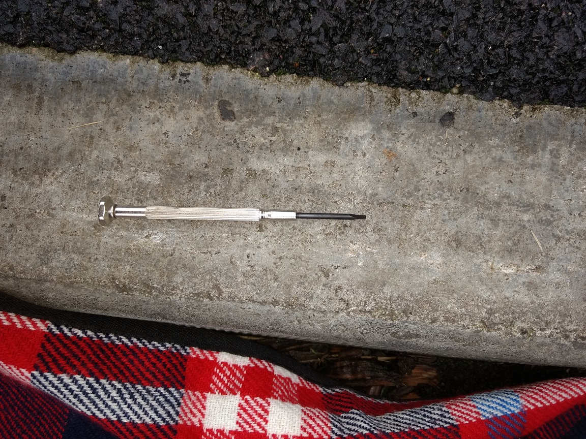

Tools required: A torch to illuminate the inside of the bumper (I used a head torch, but not on my head.  One of those magnetic non-directional LED light arrays that you can get from Wilko's would have been better); and a tiny screwdriver (photo), to lift the plastic catch that clicks the cable connector onto the sensor.

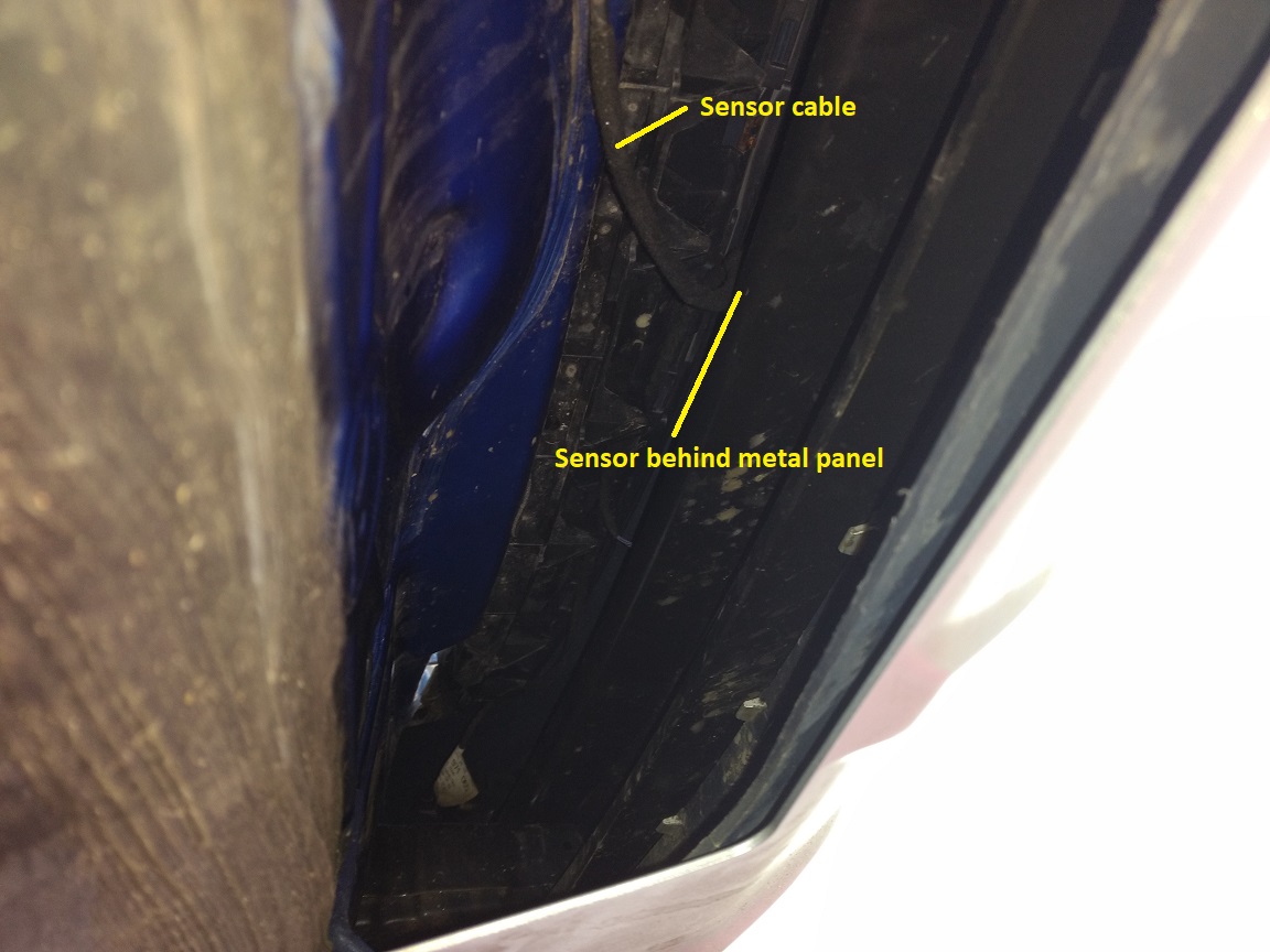

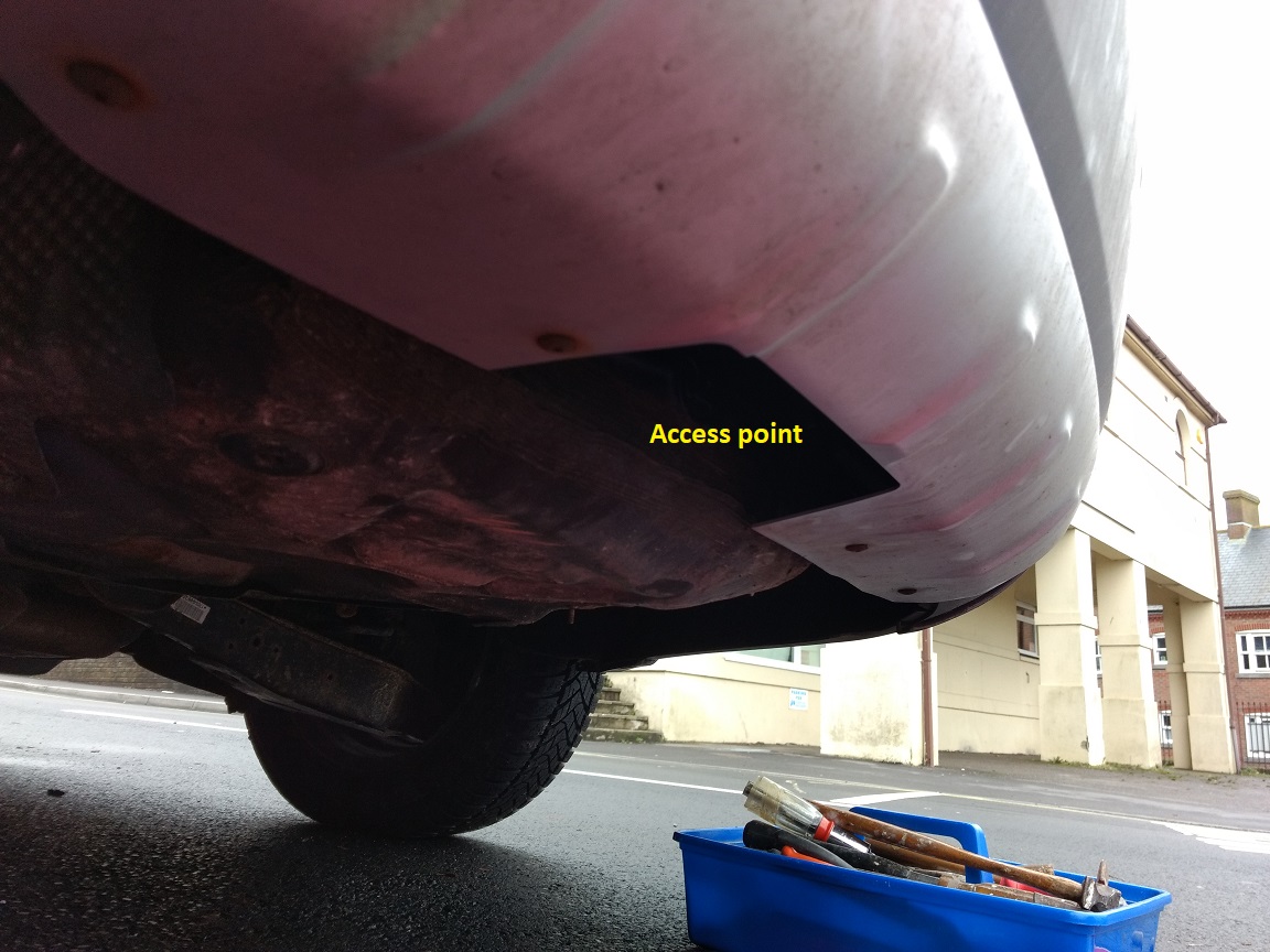

Detach the faulty sensor from the inside of the bumper:  On my car there is a rectangular aperture under the middle of the back bumper (photos) that you can get the torch, one hand and your screwdriver into.  All the internal work is done with one hand.  Lie on the ground under the bumper, and reach in with one hand.  Using your fingernail or thumbnail, lift one of the plastic tabs which holds the body of the sensor to the bumper fitting, while using your other hand to GENTLY push the sensor inwards from outside.  When the first clip is free (surprisingly quick and easy) continue to press inwards gently from outside to prevent it clicking back into place, and use your thumbnail or fingernail to lift the tab on the other side of the sensor body.  The sensor will come free from its mounting and dangle on the cable.
Detach the faulty sensor from the cable:  Inspect the dangling sensor in the torchlight, and note that the catch on the cable side of the connector socket lies flat against the body of the sensor, so you have to use a very small screwdriver to get under the catch and lift it.  Doing this with one hand is tricky, but I found I could brace the sensor against a part of the bumper and push the screwdriver in.  Then you can separate the sensor and the cable with one hand.
Attach the new sensor to the cable:  This is easy.  Push it until it clicks.
