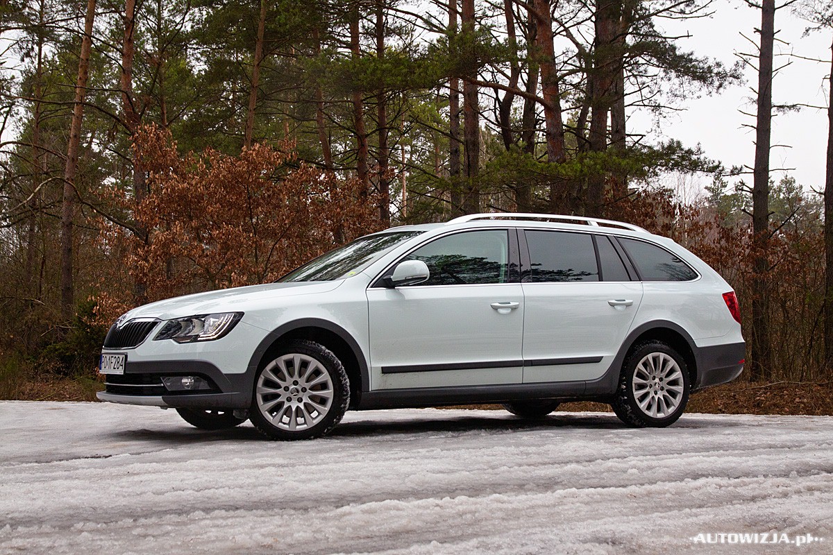

Mine looks exactly like the one in your photo. Same color too. The difference is the fog lights. I think that photo is from the the outdoor plus model.
My summer wheels are 18 inch while the winters are 17. Both scrape though.
I was planning to get the "tallest" tire I could fit in the spring, though that is because I find the ride on the lower profile tires absolutely appalling. I know larger wheels look better, but why people want to put up with the crap ride is beyond me.
Mine is definitely sitting lower than the one in your photo.
Perhaps I can just order springs and dampers for the outdoor plus model and stick them in.
Yours is the pre-FL then by the looks of it, although this shouldn't affect the ride height.
