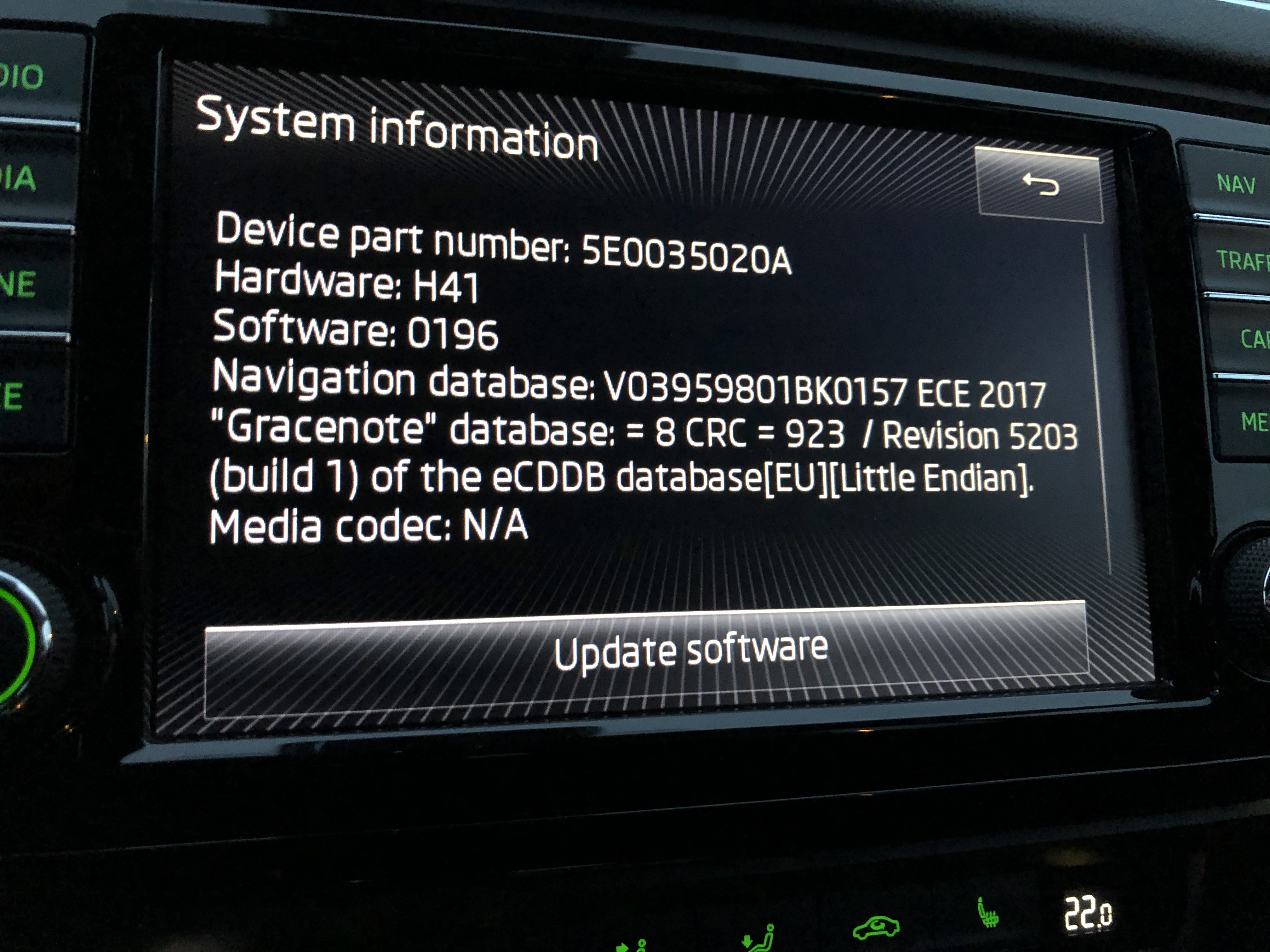

Can enybody chek if is there a update for my columbus?
On pic is my versions.
thanx
Yes 0409 should be possible:
Note that you will see an error if scanning the car for fault codes, unless you clear the fault code and change a Hex value with VCDS or similar.
