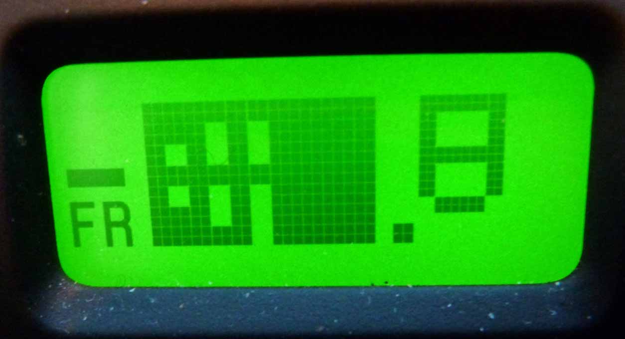

Finally, when performing a flap reset operation (holding the "Econ" and "Face Flow" buttons for 3 seconds), is the information displayed on the climate control temperature displays meaningful, i.e. does it display an error?
This is the only output to the temperature display when I request a flap reset. Does anyone know if this is correct, or should it update as it cycles through the flaps?
I seem to recall that doing the flap reset used  to take several minutes, but mine is now only taking about 20 seconds.
The flap reset sequence if that is what it is called takes approximately 20 seconds on my car and displays the same hieroglyph.
