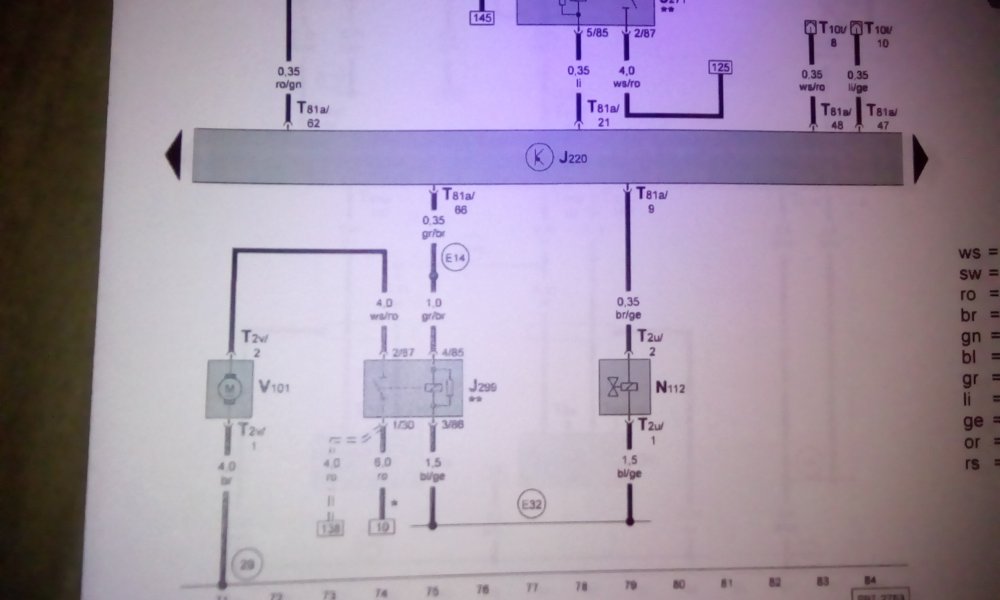

Pin 66 is the control for the relay & pin 9 for the N112 valve

I found this video clip on YouTube... it's a lengthy clip so don't bother watching it all... but it shows a perfect wiring diagram that I can read and understand. Only problem is that it's for a 2001 Jetta 2.8L, and not for a 1.8T! Does anybody know where I can get a similar wiring diagram for my car?
Do we know if there is a fuse between the SAI pump relay and the power source? FYI, I've changed the relay for a new unit and it still doesn't work.

If bridging the relay socket made the pump run, the power fuse for the pump must be OK.
Edit: Nige has already posted a screenshot of the wiring for your car. Power rail E32, for the SAI Relay coil and N112 valve are fed from fuse 43, but so are a bunch of other sensors so you'd have more errors if that were blown.
Power to the pump is from a 60A fuse in the battery fusebox.

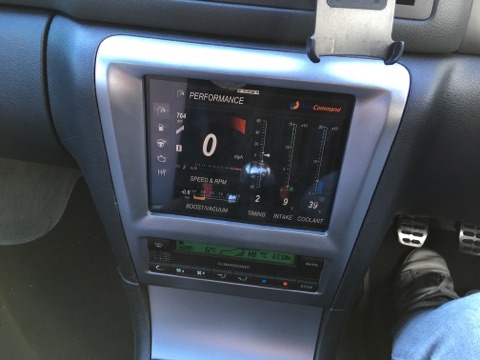

I have an iPad Mini installed in the dash of my car in place of the normal stereo... pretty cool gadget B) I use it for Radio, music downloads, TV, Sat Nav, WiFi hotspot, internet etc etc etc.
I also have an OBD2 plug (Kiwi 3) installed with an App downloaded on the iPad to read engine stats and view gauges etc... I connected it all up before starting the car this morning and the OBD2 App showed the coolant temperature at 6 degrees, and the outside temperate on the car's LCD display was also showing as 6 degrees.
The one thing that I do notice is that the temp sensor on the iPad App gets up to temp slower than the gauge on the car. It reaches 50 degrees before the needle starts moving on the car gauge (spot on as the car's lowest reading is 50 degrees), but then when the car's gauge hits 90 degrees the iPad App has only reached 75 degrees. The iPad will get up to 90 degrees and holds steady at that temperature during normal driving as it should... just takes longer to get there.

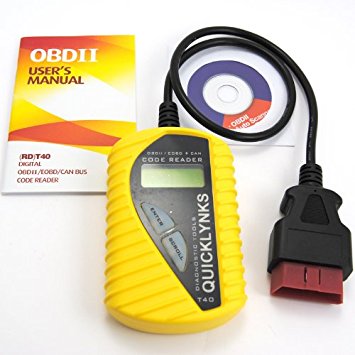

I can view fault codes on the iPad but can't delete the codes using the App. I have a hand held fault code reader that I can use to clear codes.
If I clear the code nothing changes... pump still doesn't kick in at all... and after 1 or 2 cold starts the code returns.
