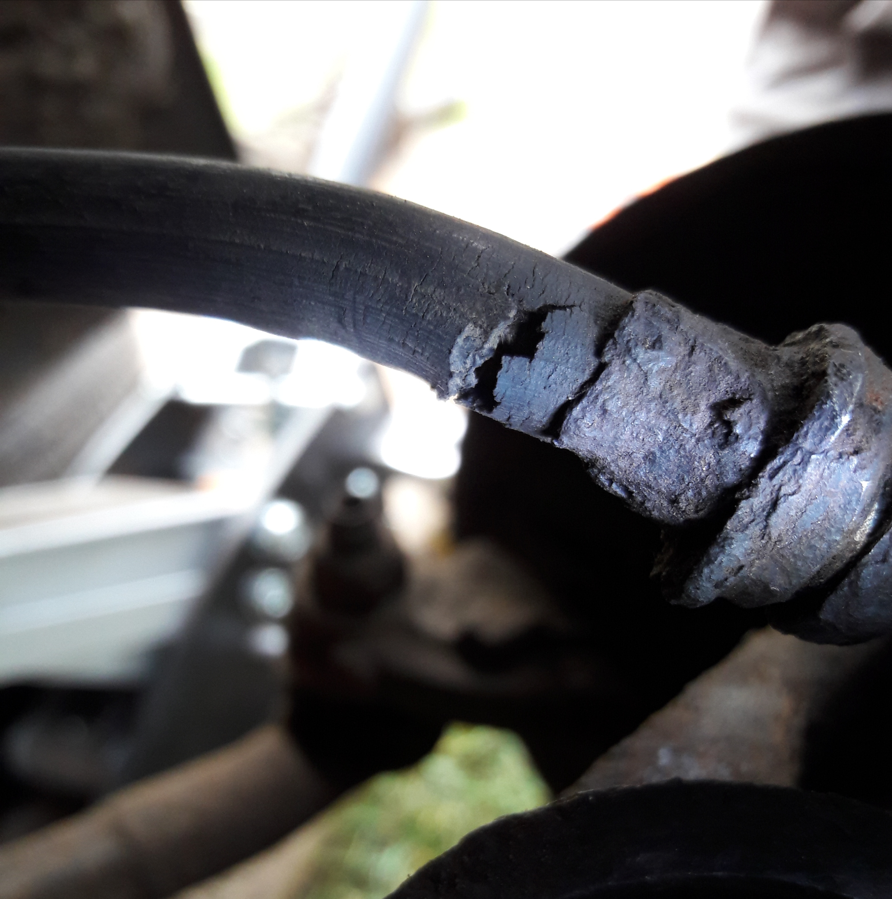

The job got more complicated after the old strut came out, and I started cleaning up the whole area, the bits that are normally obscured by the strut. Then I went to blow any dust out of the ABS sensor connector and...
Found this shocker:
As luck would have it, this was before noon, giving me time to get to my local TPS for a replacement.

Oooh that's nasty. Just shows what can be lurking unseen on cars.

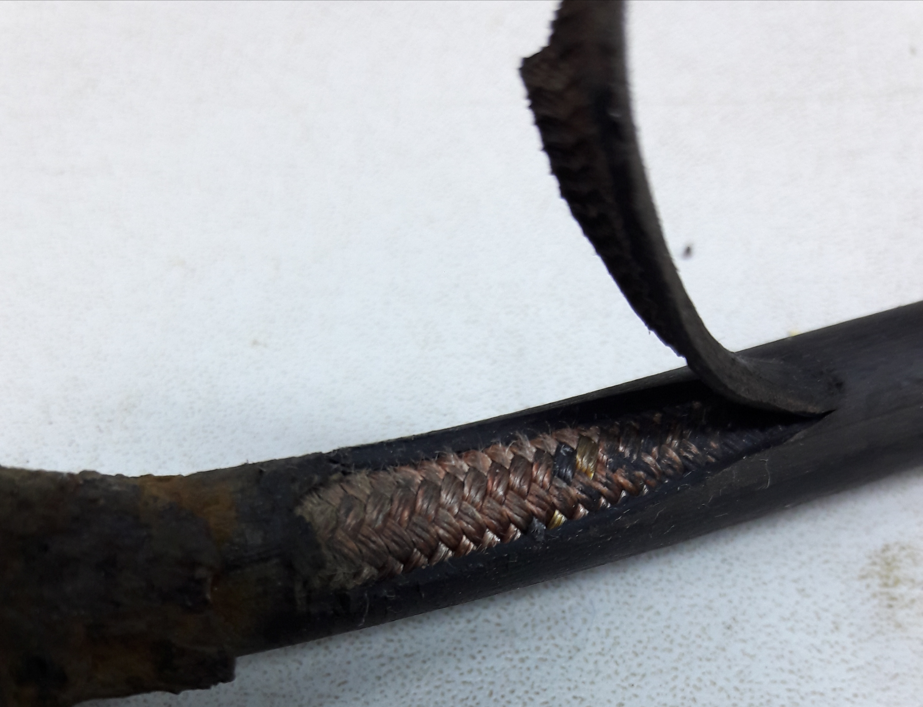

When I look at the split pipe in the shape it would be when installed, it's really quite hard to spot that problem. I'm not convinced it would have been spotted at MOT; only because it was pulled into a different shape during the strut work did it show itself clearly.  There's a braided fabric layer under the split, and presumably another rubber layer under that, so I guess it wasn't actually as scary as it looked to me earlier.

The brake hose 'emergency' was definitely an over-reaction on my part. Peeling back the rubber from the split shows no sign of any deterioration further in.  I reckon that would have held up for a long time even if Mr MOT hadn't spotted the perished/cracked bit:
Always better to react to that though, I think that "up here in the North" salt really does mess these fittings up a lot, when I last worked on my daughter's late 2009 Ibiza front brakes, the ravages of time had reduced the "across the flats" size of the offside brake bleed valve by "one size" - so I replaced both of them, 8 or 9 years seems to be when I normally replace them either due to external corrosion or there being too big a step formed at the sealing area on the cone.
