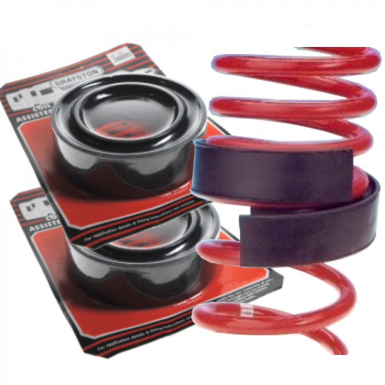

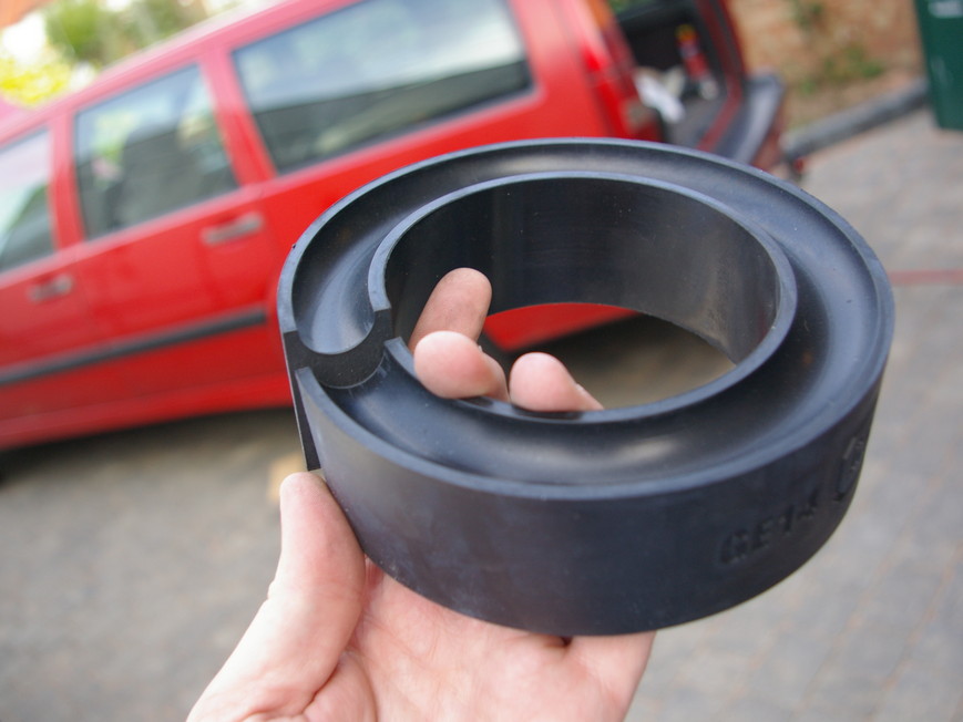

You should be ok but depending on the type of mtb being carried 60kg might not go very far, as per the bike rack instructions, put the heaviest bike closest to the car and work out to the lightest bike.  The weight you are adding isn't a force that is straight down on the towbar, so you will now doubt exceed the noseweight & it sounds like the boot will also have quite a bit of weight in there too (while this doesn't affect the noseweight, it will add to the weight on the rear suspension), I'f you find the back end of the car does sink lower than you are comfortable with, you could look at some Graystone spring assisters to help firm up the rear suspension, I used these on a mk2 octavia when towing a caravan and the behaviour on the road was much better.
^^^ Great Advice.
I have them on the rear of my Jimny i use for Towing and had them on my Fabias.
Thanks guys, I haven't seen those spring assisters before, think I'll try a day trip in the uk, loaded up to see how it feels.
