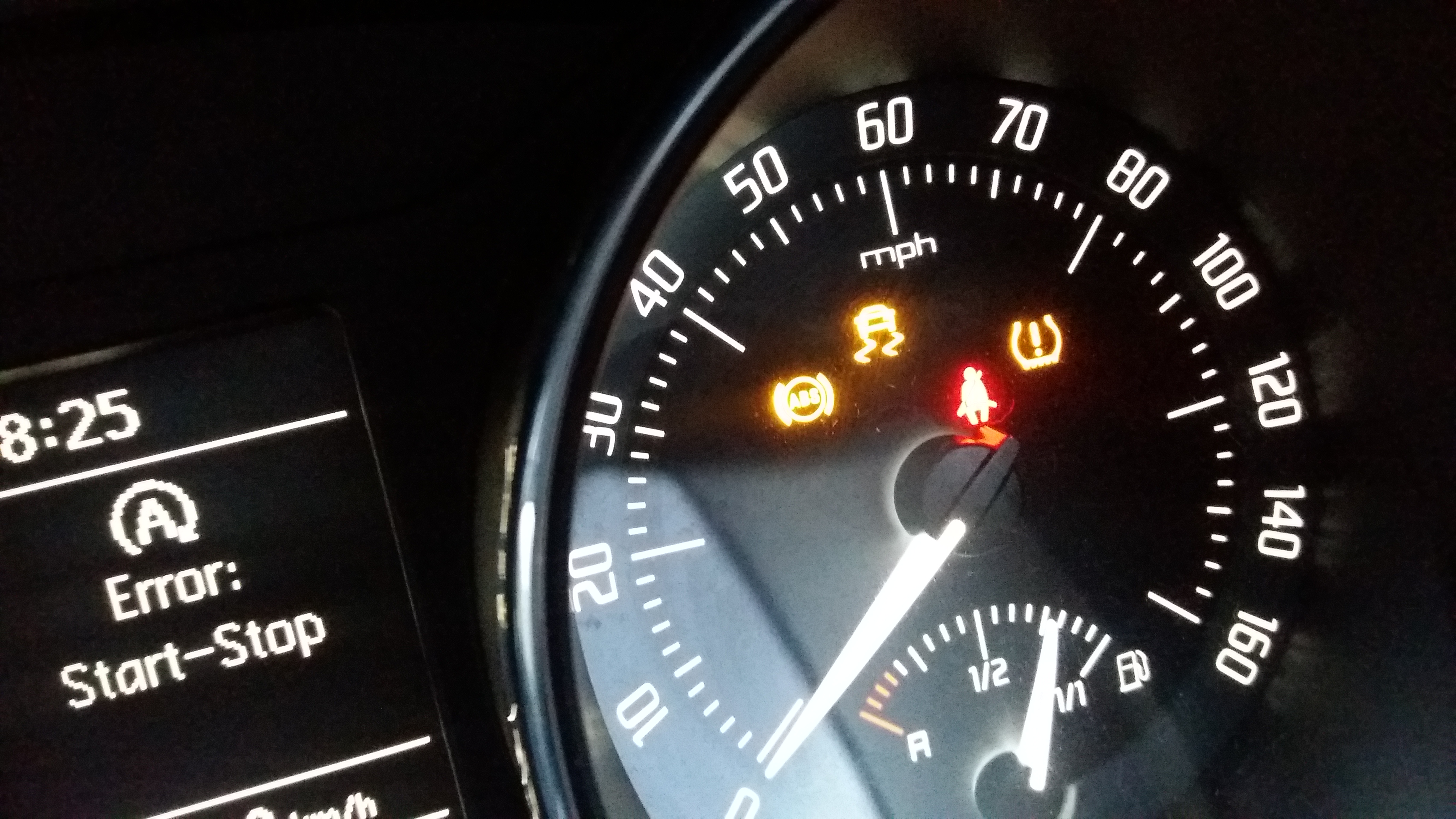

The car was delivered to us last week and we have only done about 120 miles in it but we now seem to have a problem with the car.... as from yesterday morning it keeps putting up loads of error messages on the dot matrix display and warning symbols on the console display.
We haven't done many miles in it and have only been driving it from last Friday really.
"Start / Stop error"
" ESC Stabilisation control"
"ABS Error"
"TMS error"

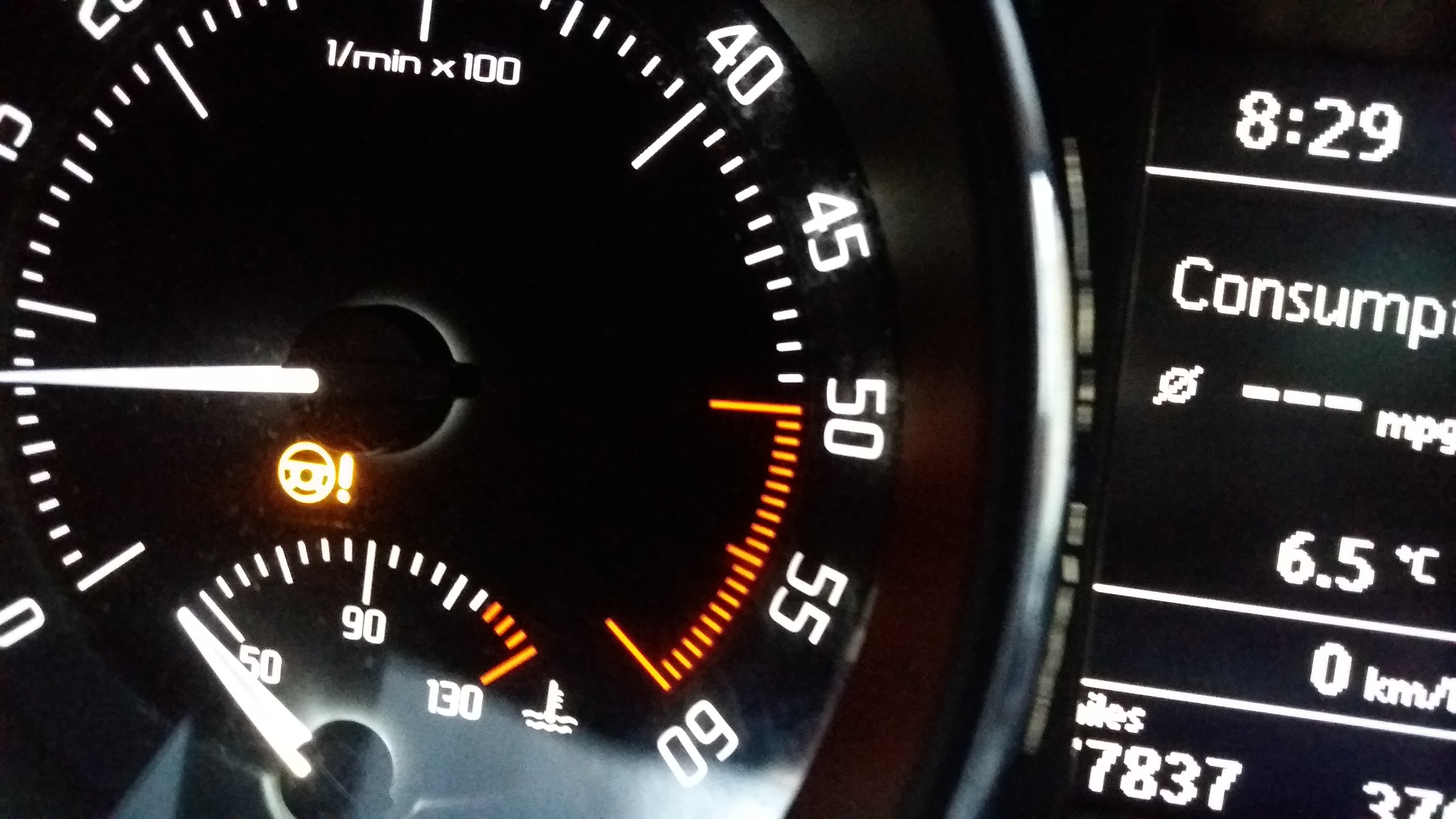

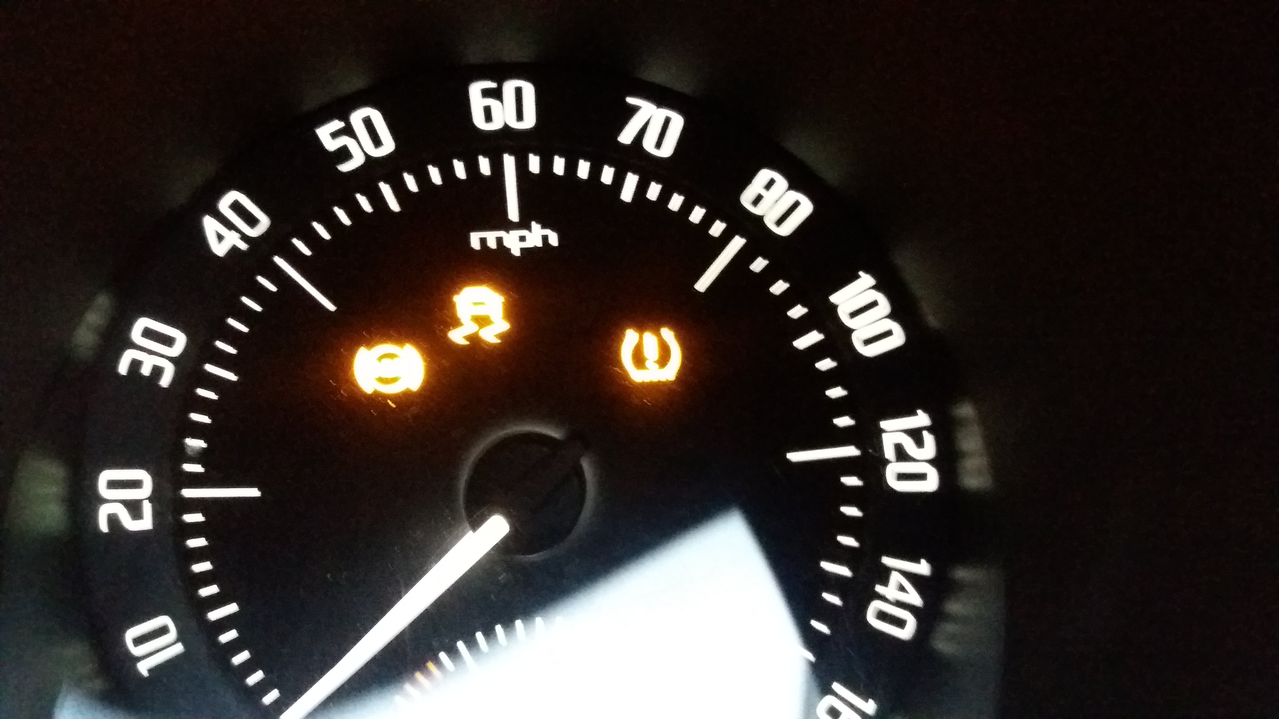

I  will post some pics of the errors. The errors keep coming on and then clearing on some occasions or some errors will stay on the console display for the entire drive.

the ABS, ESC, tyre pressure fault could be an abs sensor, but be careful I found this code in the fault log, so bought a sensor, turned out that the magnet in the wheel bearing assembly had fallen out, so had to replace all that !

It's the power steering light that potentially gives it away - The electric assistance needs a lot of current

Local garage put the diagnostic on it today and it's showing as the near side front abs sensor faulty. It's going back  in next Tuesday to get a new genuine Skoda part replaced.

But why the power steering light?
Presumably the power steering is speed sensitive so it uses the same ABS speed sensor.

Got the car back today minus the Christmas tree dashboard at last.
Initially the diagnostic said the front abs sensor which they replaced but didn't resolve the issue. Then they did some wiring checks and found they didn't have continuity. Fault found on the wiring loom. Wiring repaired and all put back together. 336.30 worse off but car fixed...I hope.
