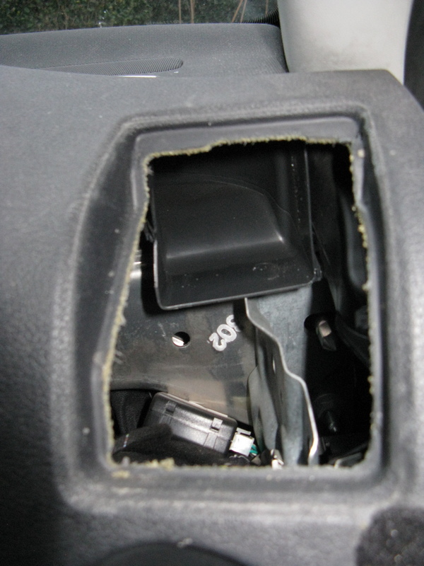

I have replaced my right hand side vent for the same reason... I can tell you it's a PITA to remove.
If the new vent doesn't have the metal clips attached to it then make sure you don't bend the original ones too much or you don't break them. Also need to make sure you don't drop them behind the dash as they can fall way down behind the door threshold panel.....
I spent over an hour doing this with a proper set of plastic prying tools and old cards.
You can remove the dash side panels to allow for some pushing and prying from behind.
You also need to look out for scratching your dash - use some kind of cloth to put between the prying tool and the dash.
It's doable but it's a pain.... just do it in a day when you feel like you have the patience, otherwise you risk doing damage or having to take many trim parts off to recover metal pins like I did.... I found mine under the carpet after I dropped it.
The way I managed was by using several tools to pry it off at the same time. Stick one in - pry, stick another, pry, use a third one to further pry and pull towards you. All of this while making sure those metal clips don't get bent. (they tend to bend and crumble if you pull the vent towards either side too much)

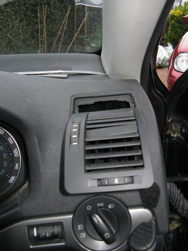

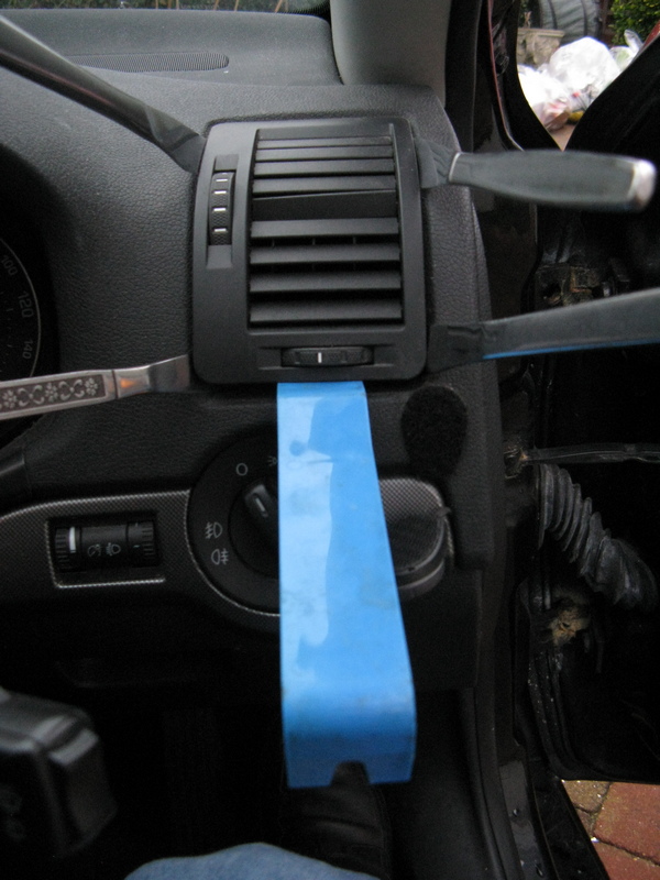

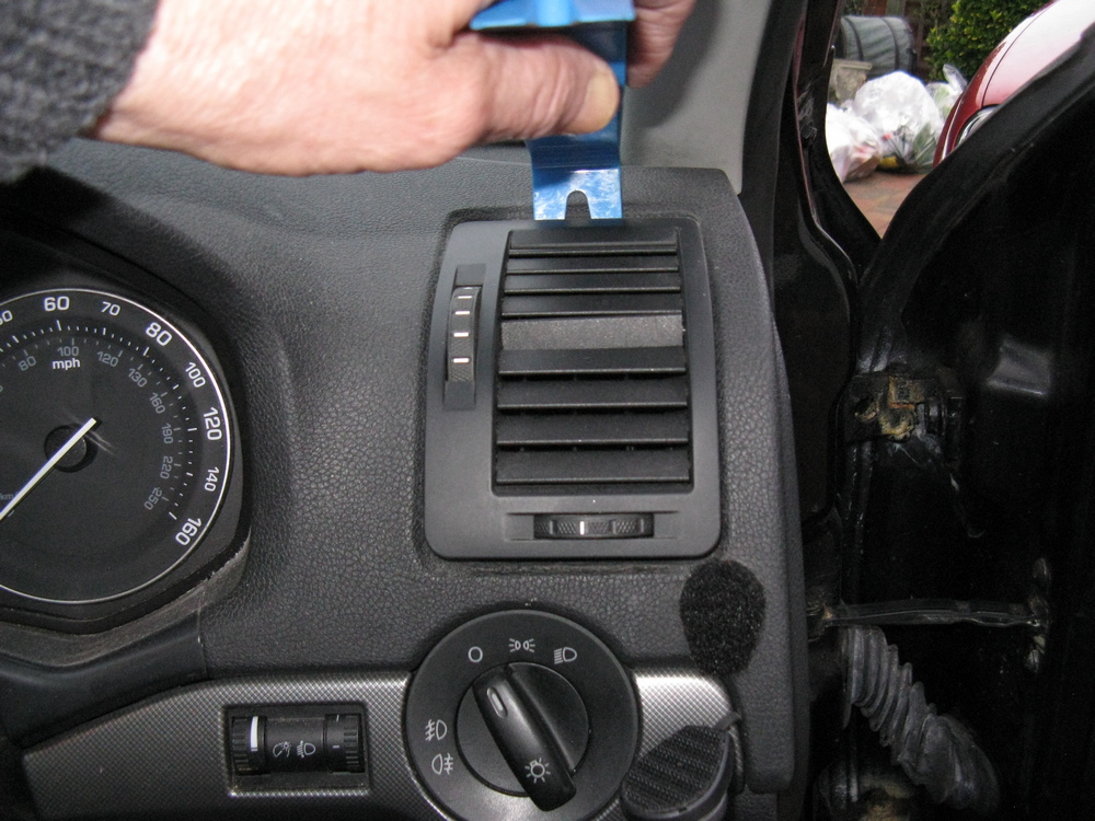

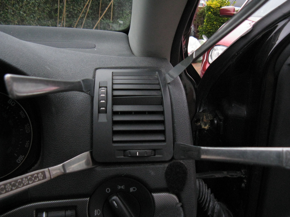

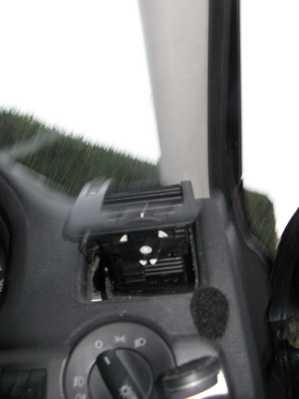

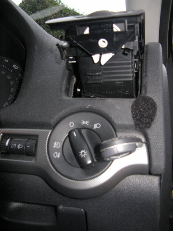

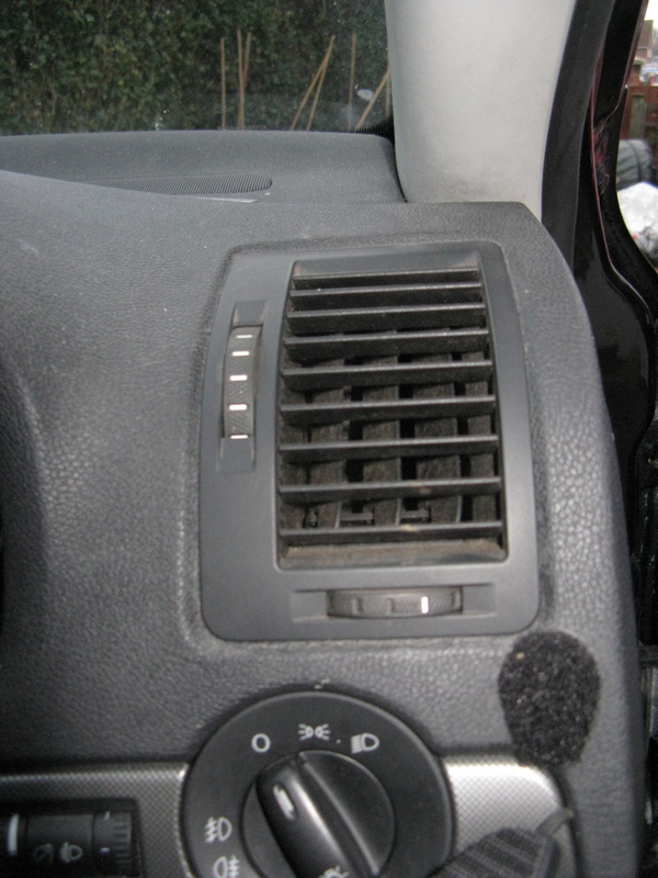

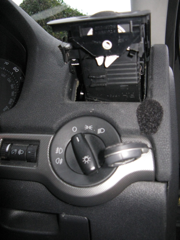

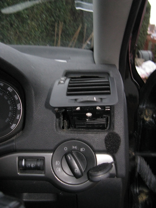

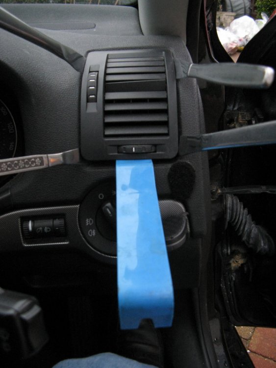

Job done - about 15 mins plus some thought and preparation time figuring out how to do it, and with what "tools".
The secret weapons = 4x slightly flexible table knives (!) - one for each clip -, plus a trim removal tool.  See photos, but obviously you can't see between those shots when I gently "wiggled" the old vent from side to side and up and down to get it to gradually come out of the dashboard aperture!
The critical stages are
- Push the top 2 knives in first as the lower 2 will get in the way of doing that if you put them in first.
-  between the 2nd and 3rd shot as you gently force the vent towards you and downwards,
-  between the 3rd & 4th shots as you generally pull upwards on on the lower edge to get the lower 2 clips to release - probably need the knives again to finally persuade them to do that.
Don't be surprised if you hear a few "pings" and snapping noises as the metal clips break off the existing vent - be "brave" and carry on (a **** or bust situation!)! :sweat:
Putting the replacement back in is quite easy/quick - push the top firmly inwards and slightly upwards and then progressively push down on both side from the top to the bottom until it finally clicks in the correct position
