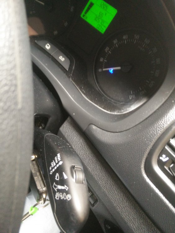

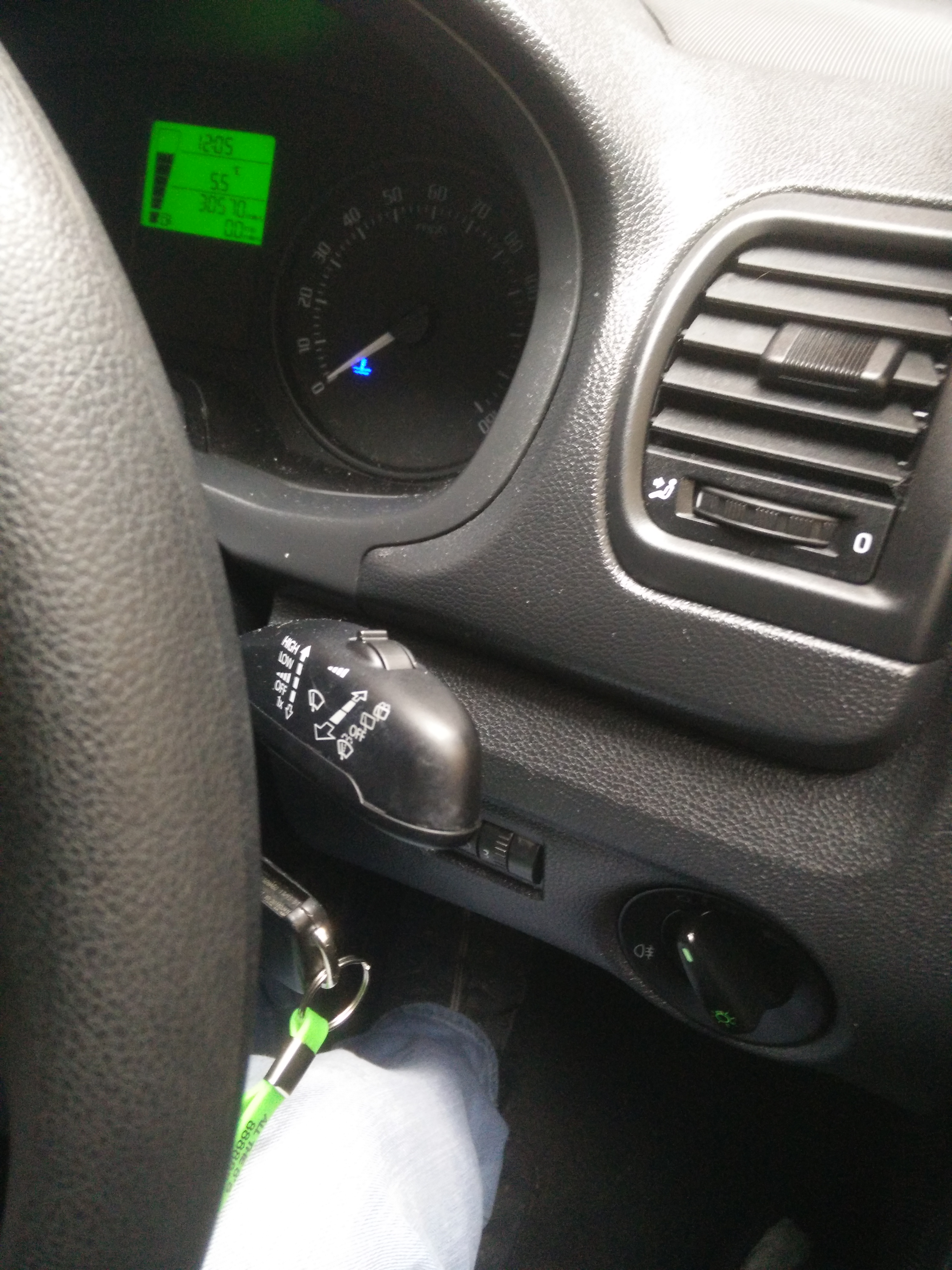

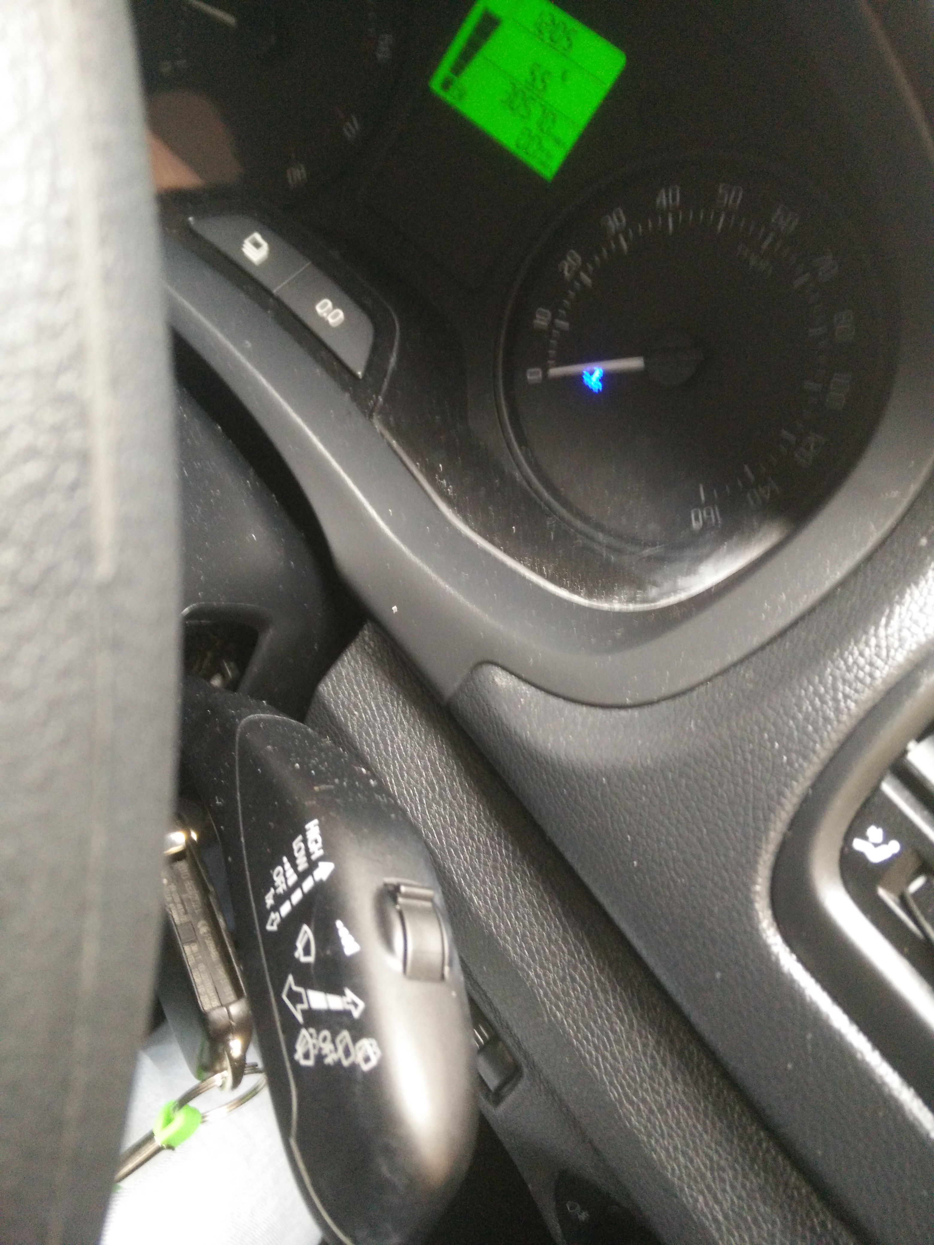

I don't have anything at the end of my stalk,attaching the pics
Oh...not seen one like that.
You have a very basic model without Multifunction Display.  Do you have a button on the underside of the stalk? If not then you don't have access to any of the information I posted earlier I'm afraid.
Its in the manual page 28/29 The only thing you can change is the current speed displayed in the LCD in mph or kph.
Thanks yes there is not button on the underside of stalk either, so it must be a very basic version.
