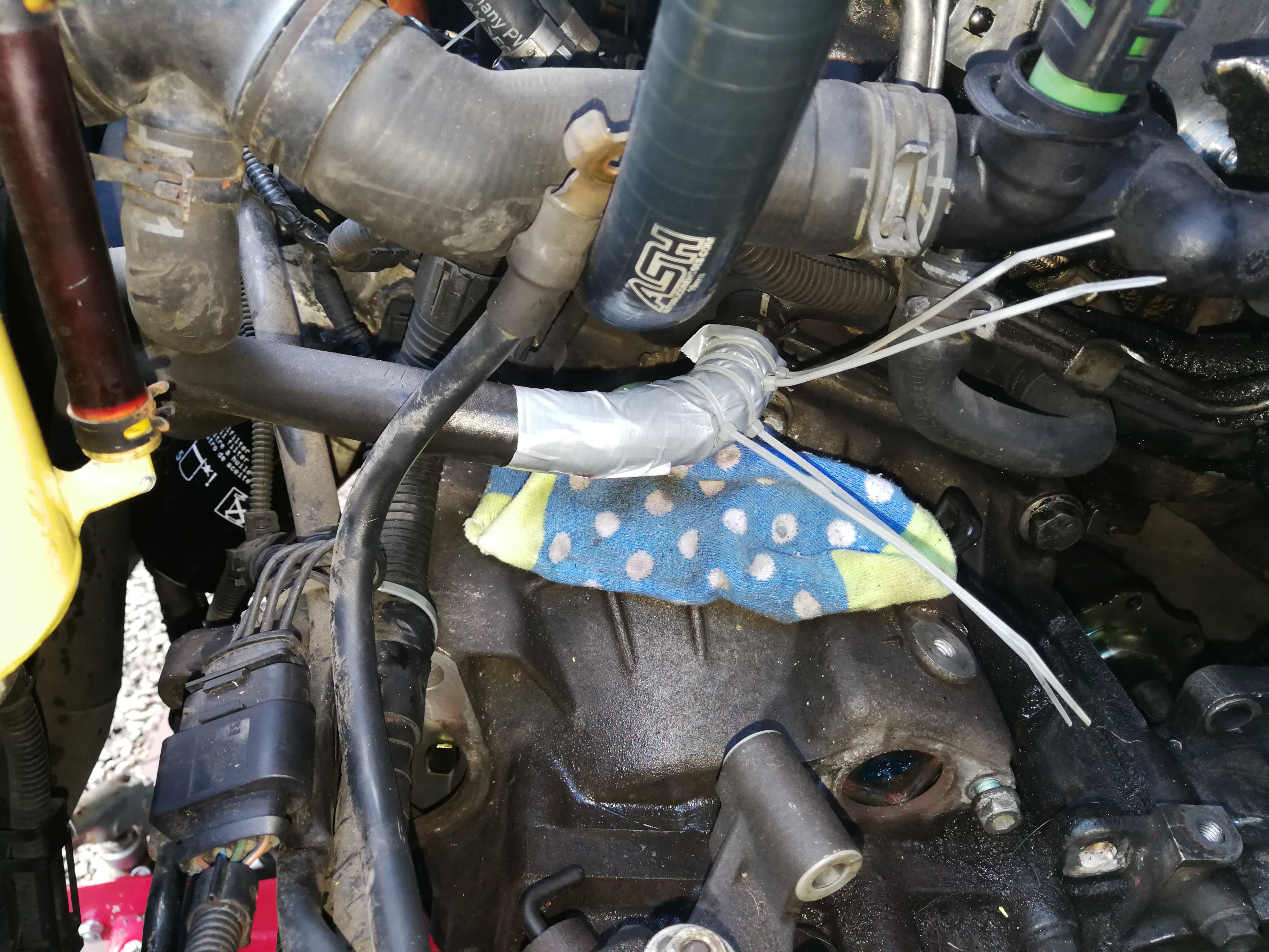

Anyone know the part number for the hose with cable ties on it in the pic. Coolant hose that runs around into the oil cooler

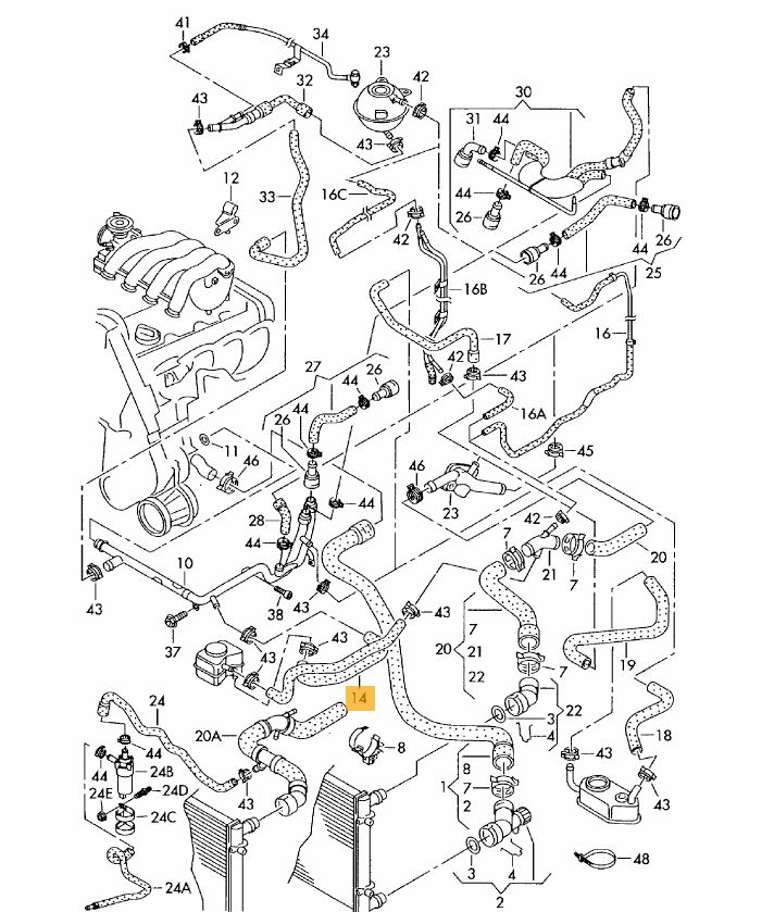

There should be a part number on it - somewhere. Will check the OE catalogue, see if I can find it.....
I think it may be number 14 - 1J0121086BR
That looks rite mate. Is that catalogue something u can view online? Thanks for that
That particular catalogue is online, although it does cost to access it (we have it through work) - there is an online one available for free, except it doesn't have VIN lookup function, so you need to pick at it using your log book for engine codes etc

Its actually 2 hoses. Even tho only one of mine is split both hoses that go into the oil cooler are joined together so looks like im replacing both
