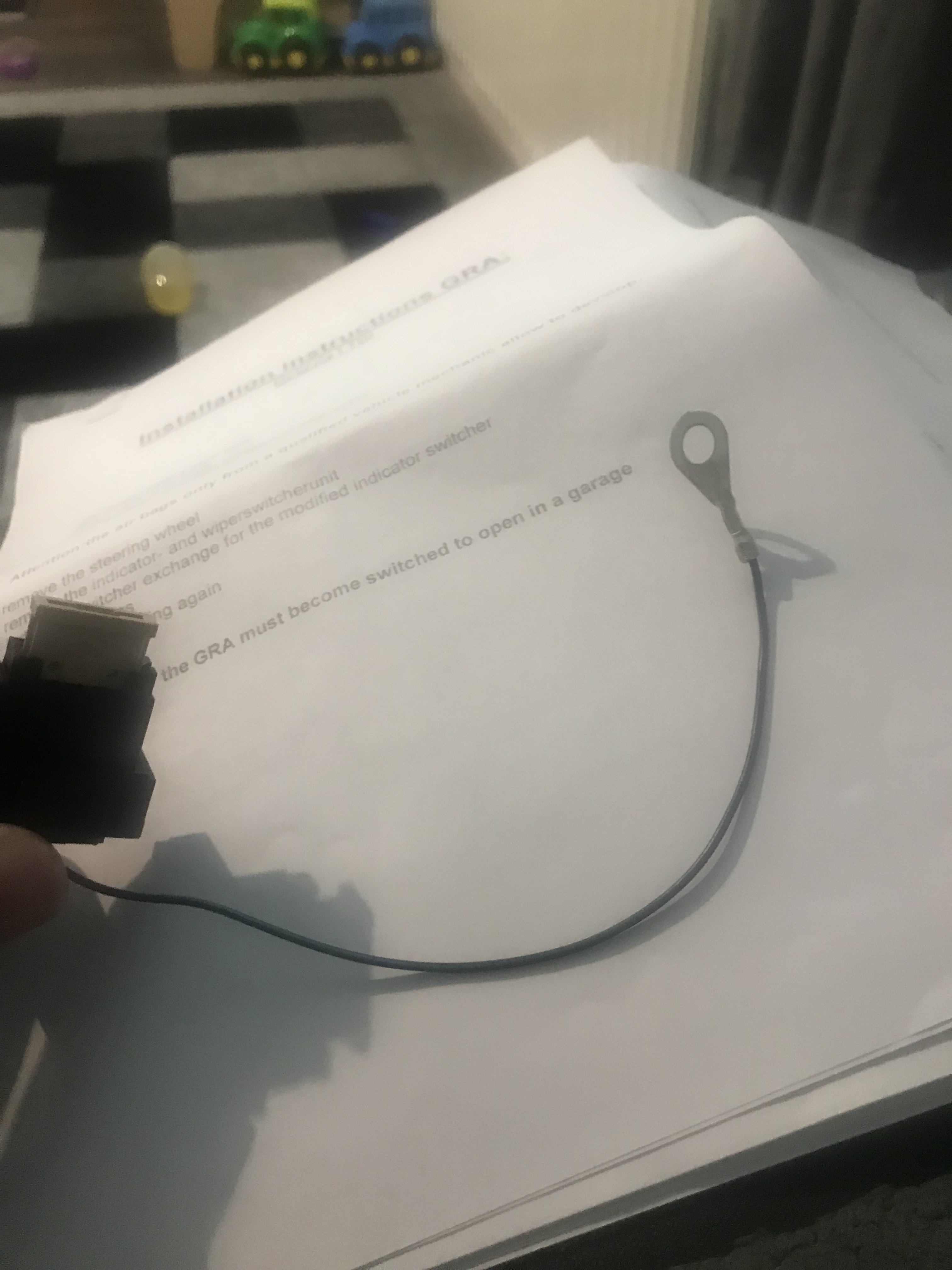

I’m on fitting cruise control to my mk1 Octavia tdi pd130 where does the black/blue wire go too help would be great thanks
Here’s a picture of the wire I need to know about thanks 1EE7A194-FE35-4937-B19D-34AEC7F29166.jpeg

Black/Blue is the +12v ignition supply from fuse #5 in the OEM wiring, as yours has a big ring terminal on it, looks like they intended it to pick up the supply from the "X" contact relief relay the connection will be found at the bottom edge of the relay panel behind the dash.
