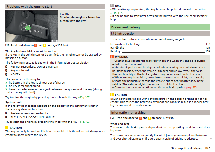

The dealer has phoned since and tells me that losing the pairing over time is actually mentioned in the handbook but I cannot find it (admittedly, my laziness means I've only read the section regarding locking/unlocking and KESSY so it may be buried somewhere else in the book)
Here is a copy of page 107 from the owners manual. Have you tried pressing the start button using the key? Just a long shot.
We’ve never had a problem with starting the engine. The problem has only ever been with the locking/unlocking
If you look at the graphic above you will see that it mentions "strong electromagentic fields". I am wondering if you store your keys on top of a microwave oven (they generate high volts and power) and the emissions are damaging the key's electronics stopping it communicating with car properly. Or maybe you park your car near a high electromagnetic source. Just clutching at straws but thought I would mention it.
