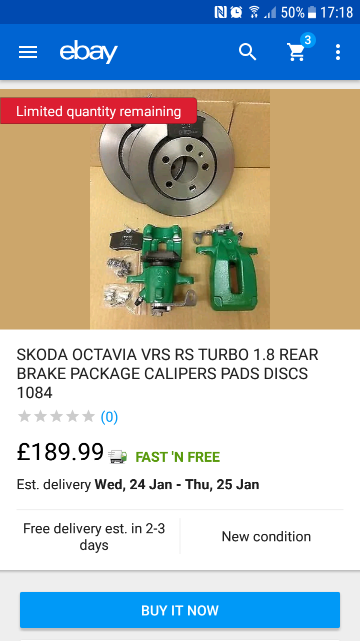

Just seen this on eBay

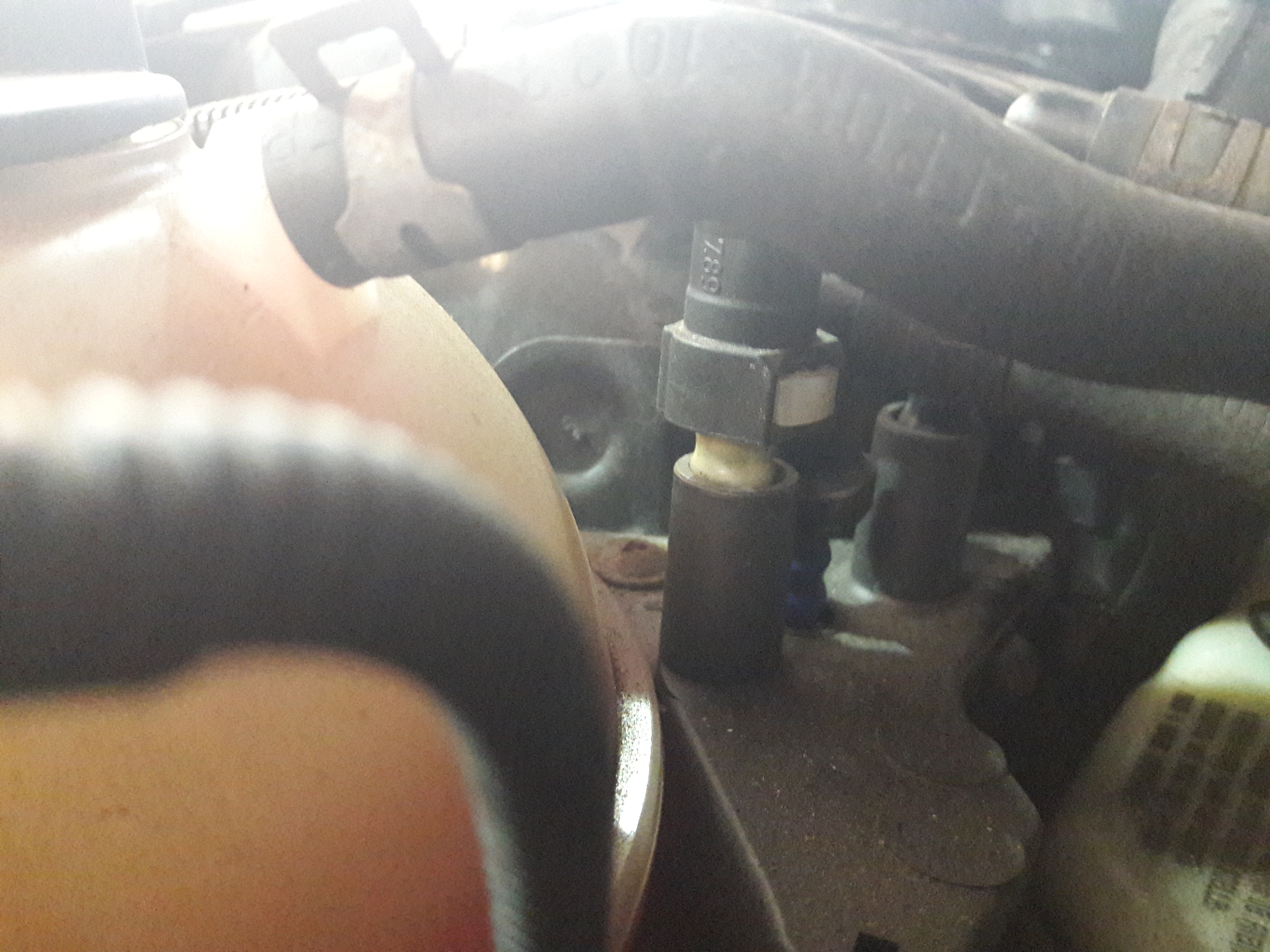

Anyone know what this is and if it looks right.

Did you use a seeley vacuum or pressure bleeder?, also what order did you bleed the calipers in?.
There are 2 bleed nipples on the master cylinder if you have introduced air into the system. How long were the calipers off the car, hours or days?, as the abs pump can get air trapped in it if the system is left to drain. which can be quite elusive to remove without something like VCDS to run the pump while you bleed the system. This is not usually a problem on short duration caliper changes though.
I used a sealey pressure bleeder and bled them in this order:
n/s/r o/s/r n/s/f o/s/f and the pressure never dropped below 1 bar or 14psi as recommended.
The calipers were taken off and sent away for refurbishment end of January and only put back on at weekend with 2 new front hel brake lines. Never got to do short rears. Also changed 2 banjo bolts. I took out about 450mm of old fluid and when it was coming out I saw all the air bubbles and old fluid and nipped off nipple when it was clear fluid through. The pressure was perfect and it all came out well.
