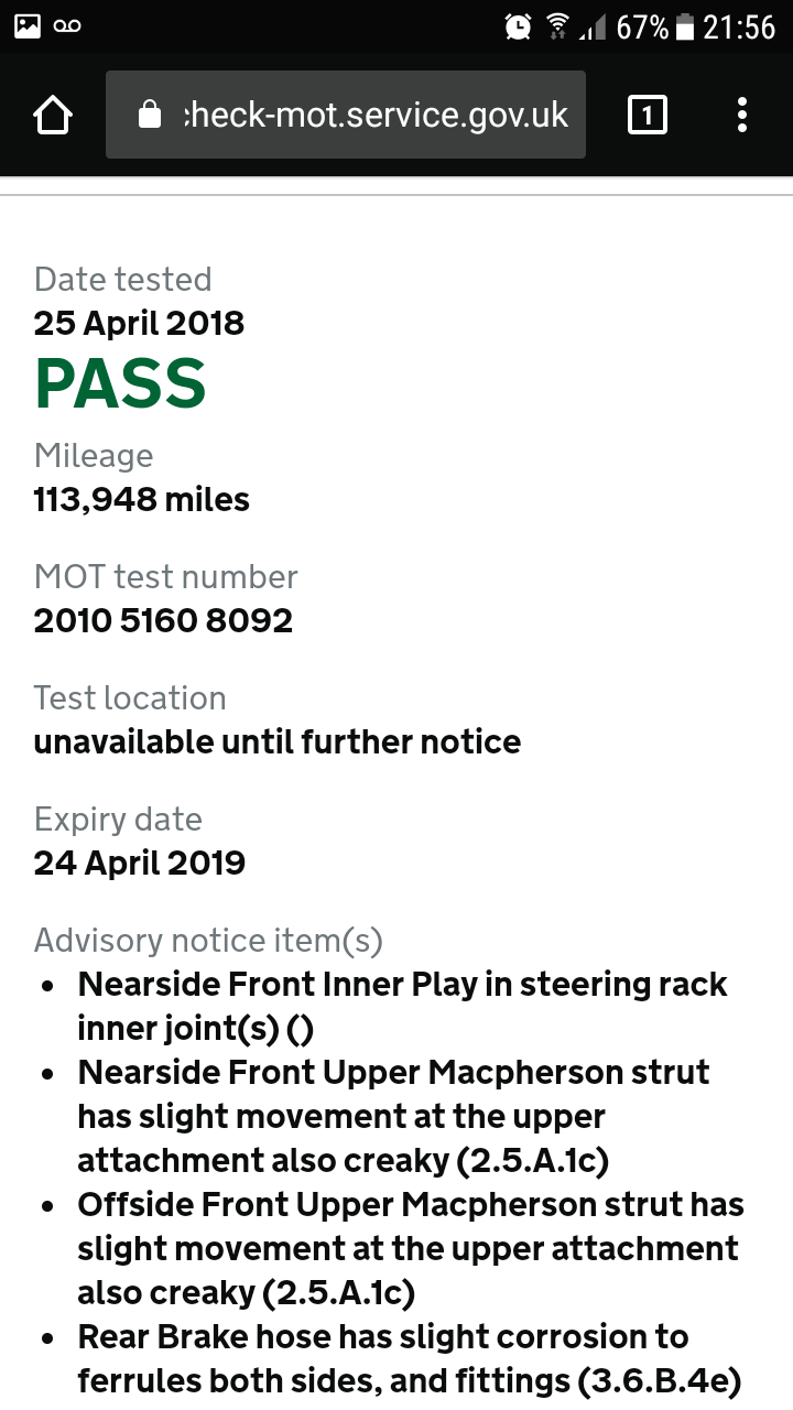

Anyway car is at mechanic today to get an mot and he will fit new handbrake and bleed brakes. Hopefully good news later on so fingers crossed. Car been off road for over 3 months now.

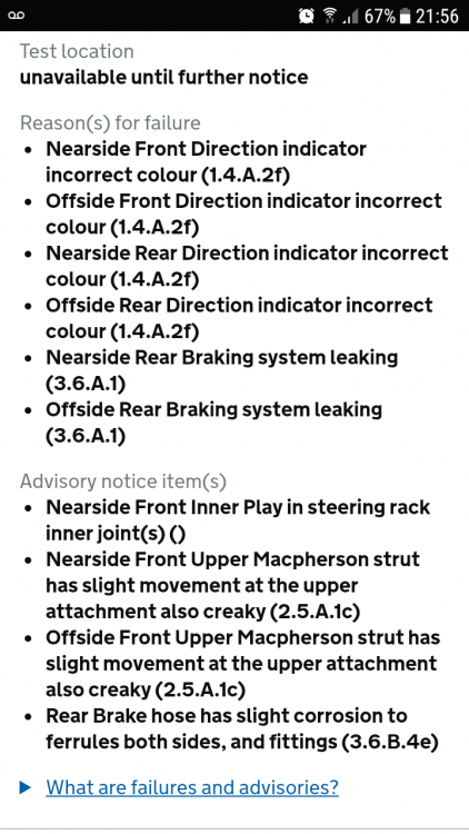

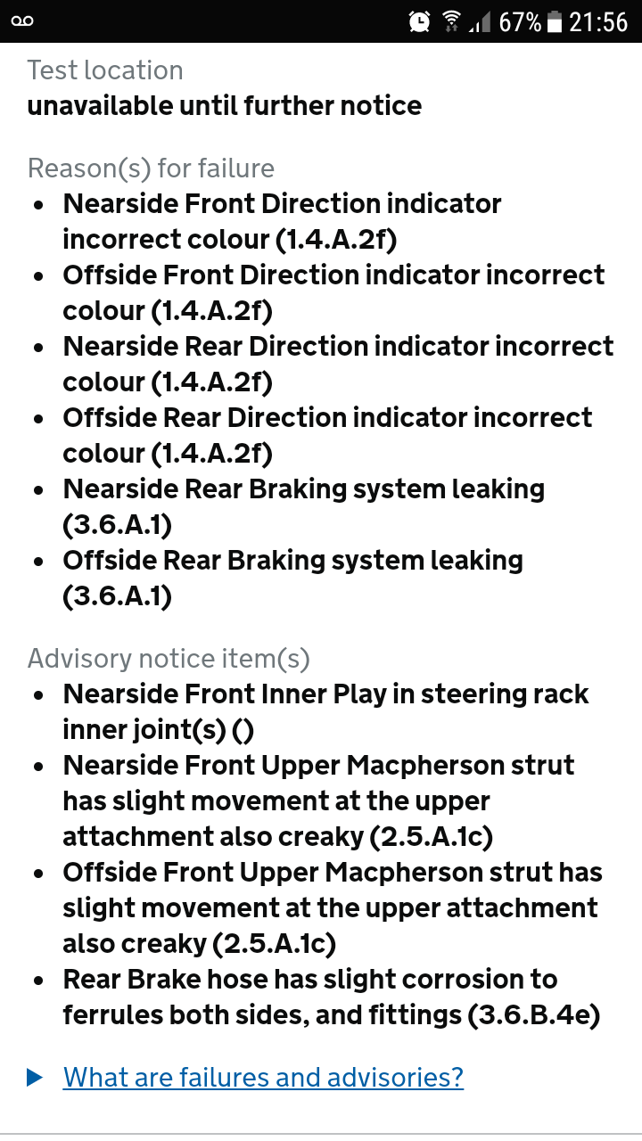

Well car passed MOT with an initial failure but some advisories
Incorrect colour?  Did you black em out? :blink:
Edited by Liverpool-Lad
No bud nothing like that I was very surprised it failed on that. Can't work that one out tbh

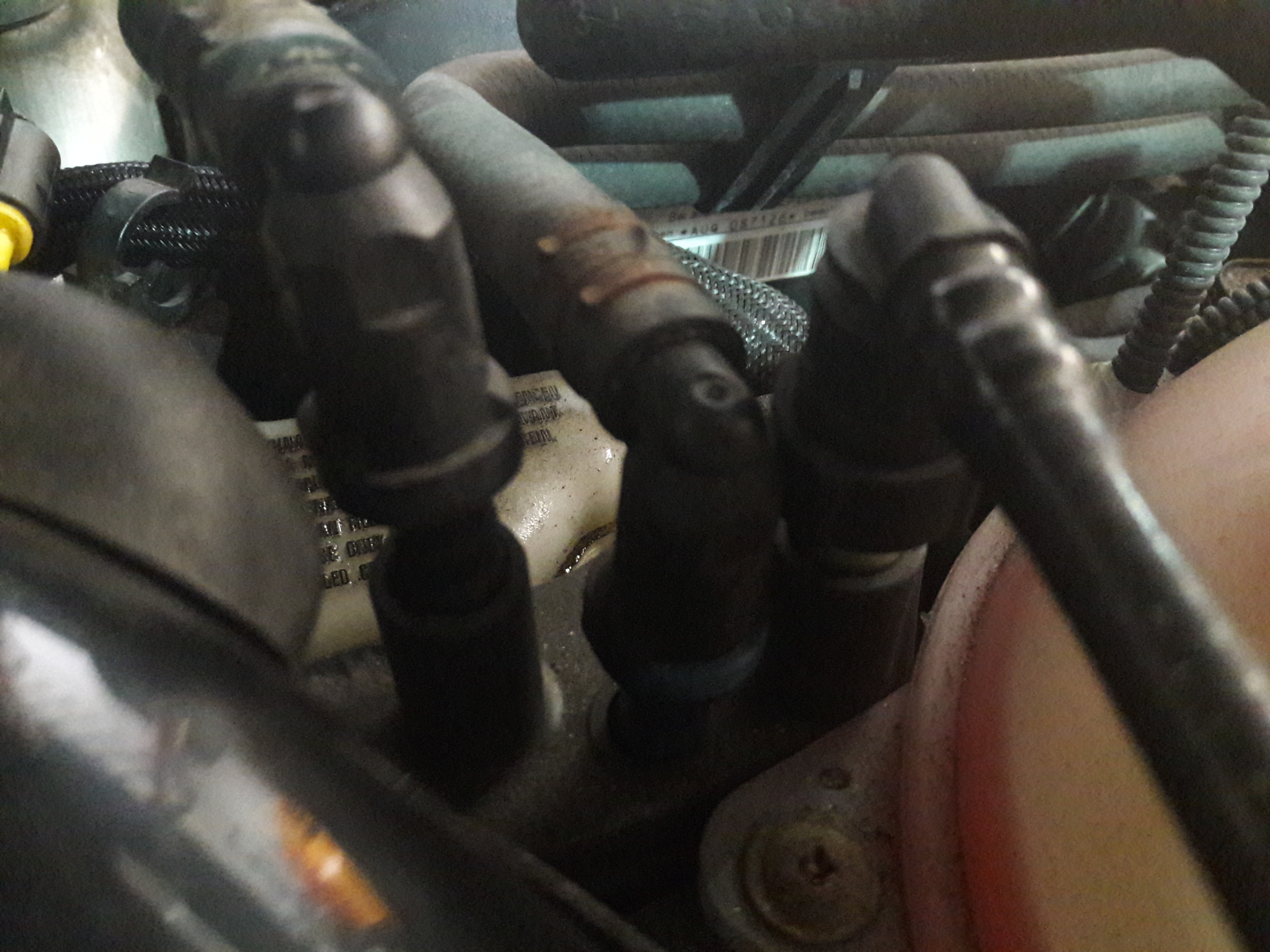

On 15/04/2018 at 16:43, octaviavrs170 said:
These 3 pipes stick out and feel unsecured but im unsure whether they need to be pushed in. There is a slight travel on pipes. As if they need to be pushed in. Also what are they connected into
Cheers

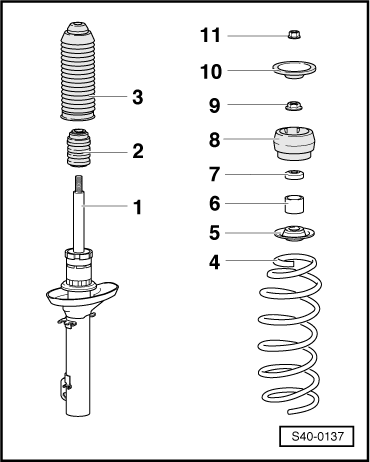

Your advisory for 'Macpherson strut movement & creaky' could be that the upper bearing and rubber mount is in the early process of giving up (7 & 8 on diagram).
This has to support all the weight piled onto the outside wheel when cornering and be able to turn while doing so.
Not a job for an inexperienced home mechanic, coil spring compressors can be lethal if they slip under tension and space below the suspension turret is very limited.
Cool cheers for the reply. I already replaced bush 8 with a poly bush mount when I changed the suspension
